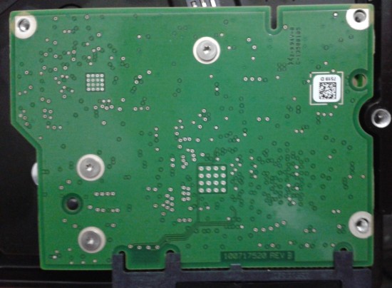

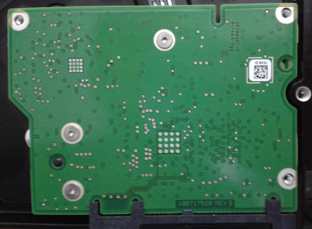

Hi, I have a Seagate ST2000DM001 (PN: 1CH164-510, FW: CC27) not visible in BIOS / system, and I need to perform some fixes on DFL-FRP device.
Actually, I need to do BSY reset by connecting pins on the PCB, so I can write ROM and modules. Yesterday I did reset SMART, fixed translator, saved ROM and modules and then get partition and save some data. After few minutes, it stopped responding just like before. Does someone has a PCB PIN RESET image to share here? Or maybe pin layout of chip LST B69002VO, so I can find it by myself and post it here? Thanks

    104194        9        8 02  028201 000000 1 00000080 XFR WR SYS LBA B 000000097E38 L 000000000008 BO 000000 BES 0068D27.0068F26.0068D27
You can take a look, sending you ID&pass.
