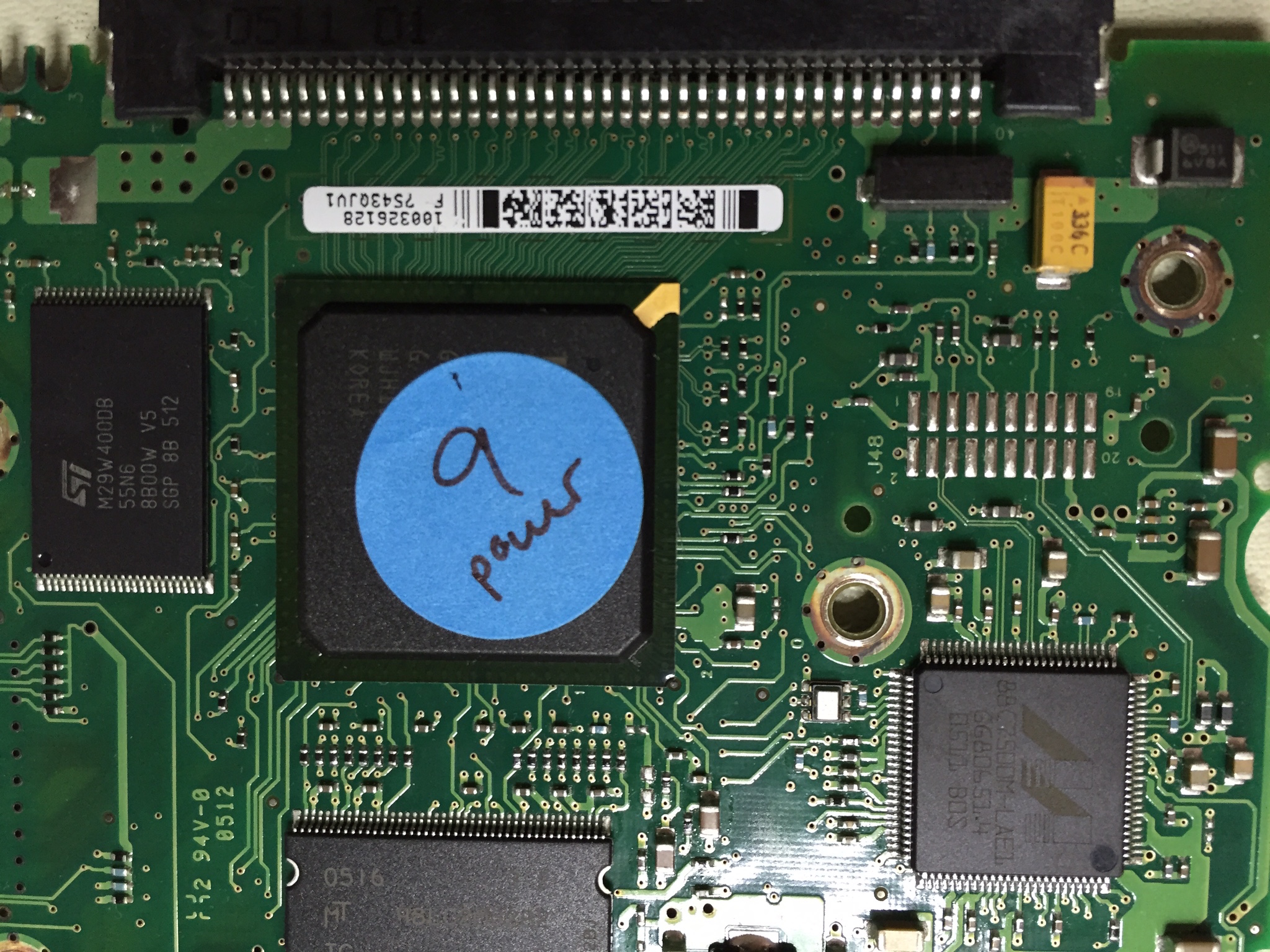

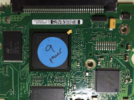

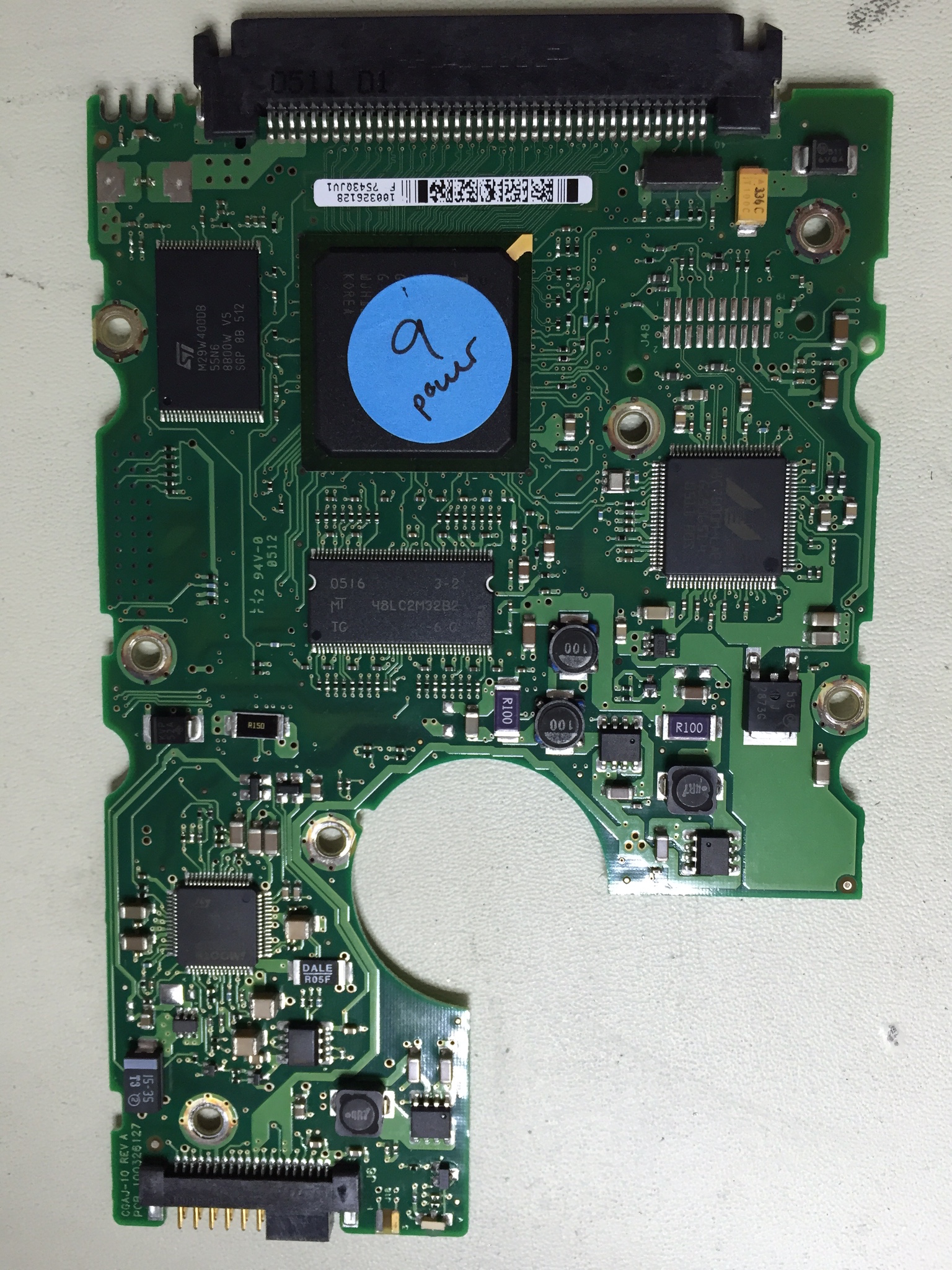

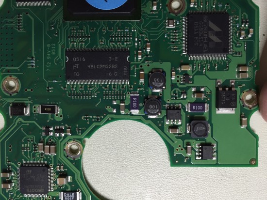

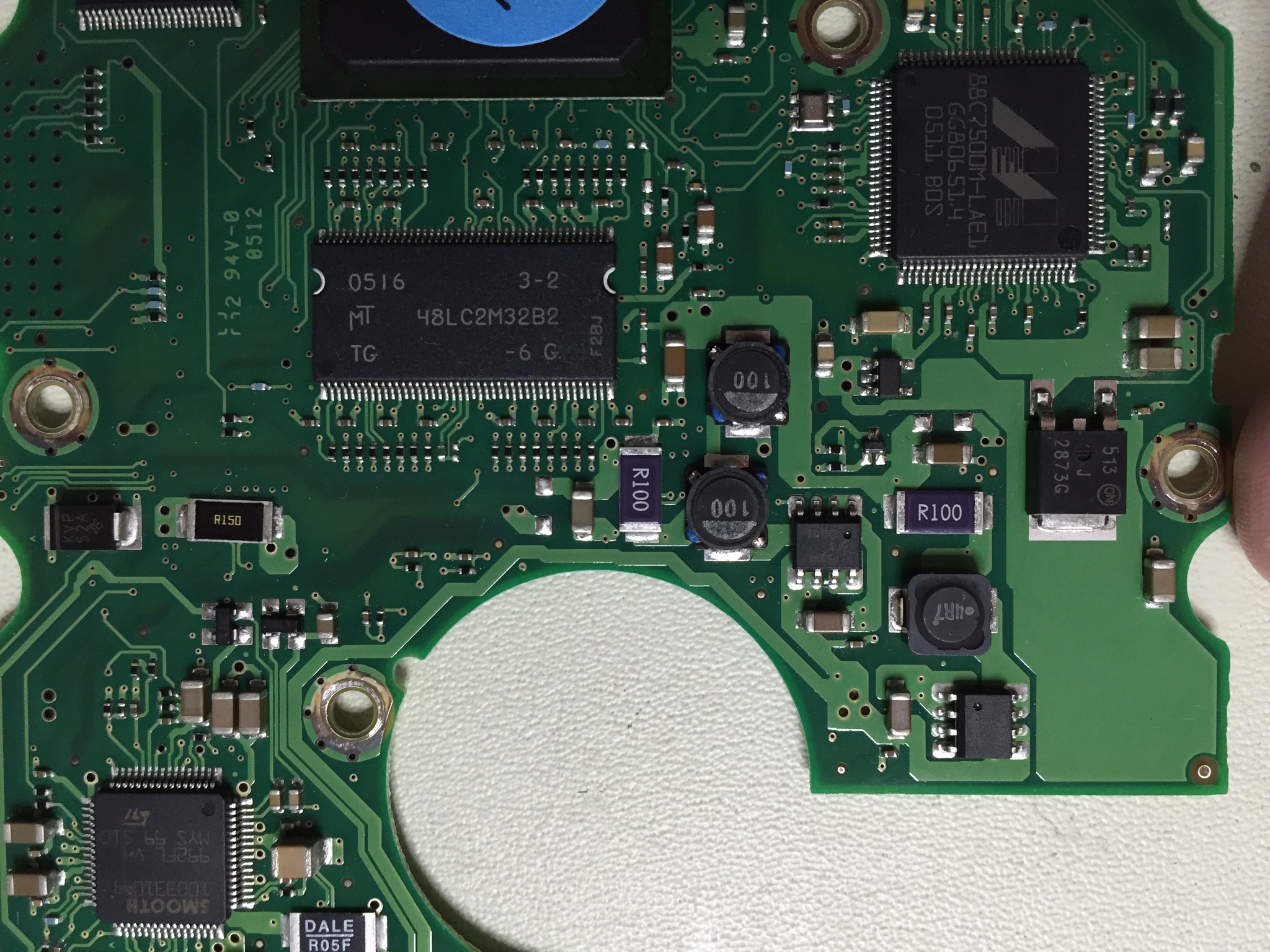

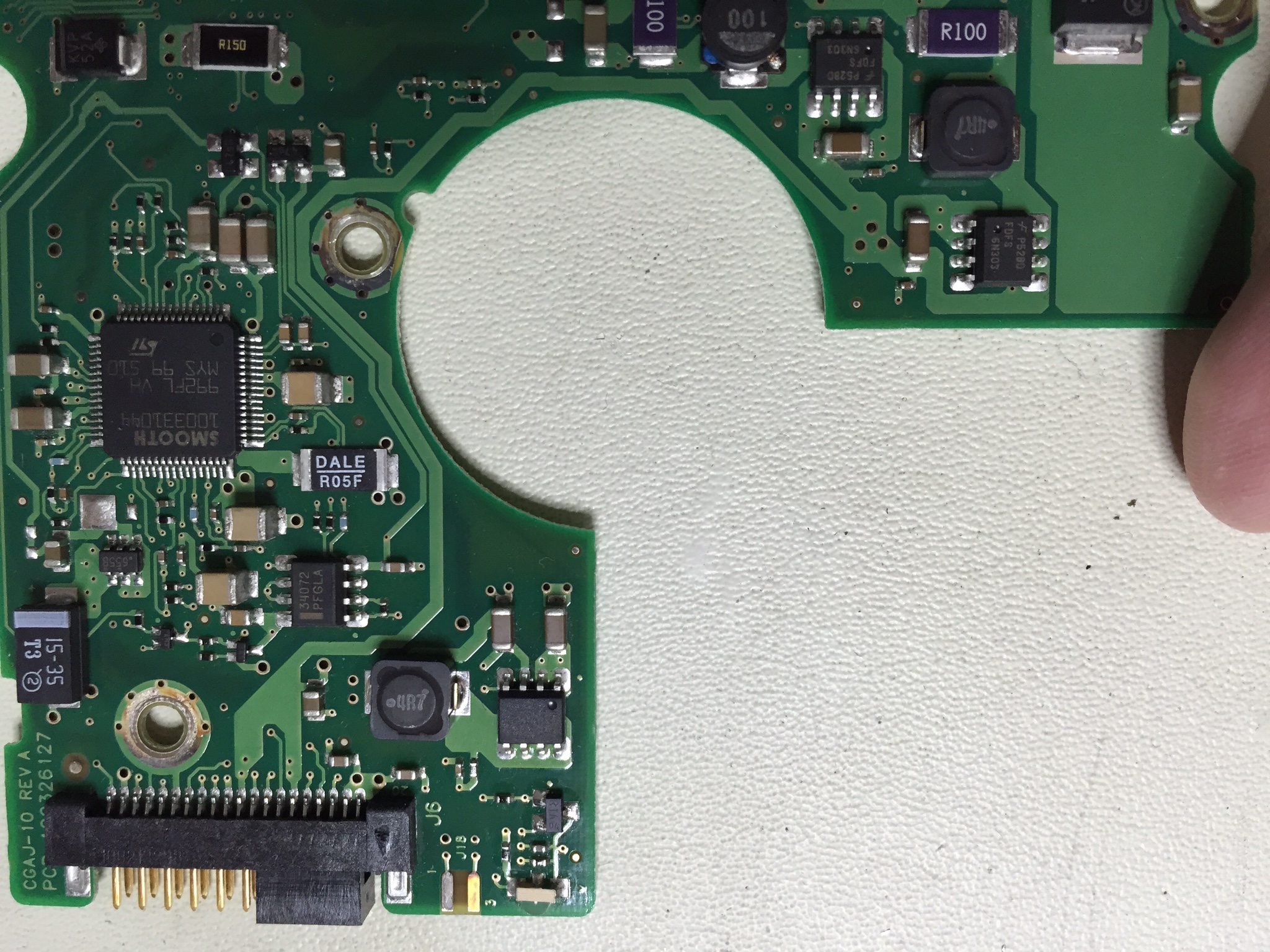

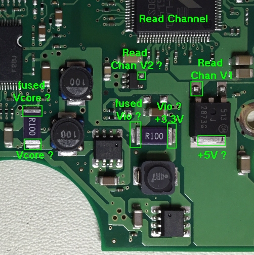

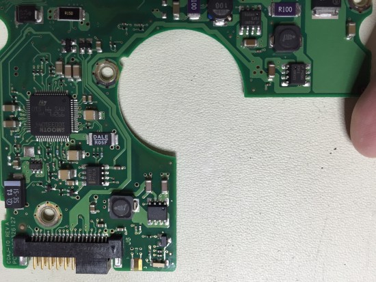

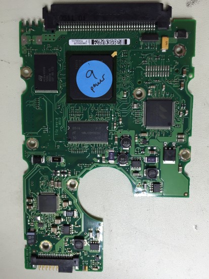

Before attempting to move the ROM chip to a donor PCB, I'm hoping to figure out exactly what chip is bad (as it may be a simpler fix than moving the ROM).
When powered on using an external power supply, the PCB and PSU both "tick" for about 5 seconds. Green LED on PCB dims with each "tick" then shuts off completely after 5 seconds.
Looking for some guidance (fzabkar?) in determining where the problem is occuring.
Thanks in advance for any help!
Brian

 Post subject: Re: Help determining problem with ST3300007LC's PCB (1003261
PostPosted: May 14th, 2015, 18:43
Posts: 17231

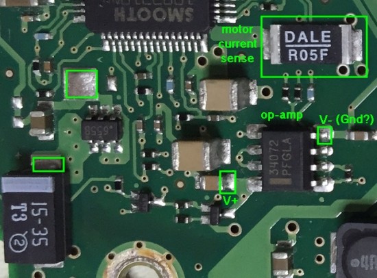

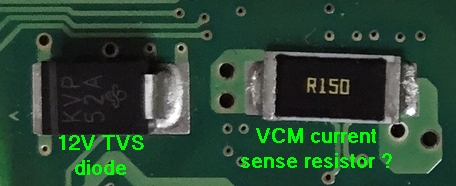

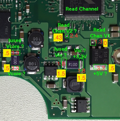

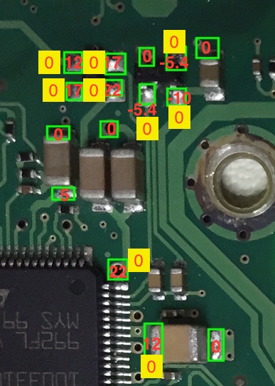

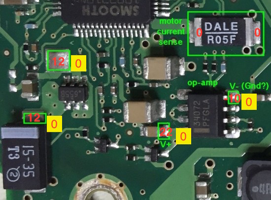

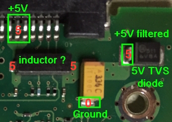

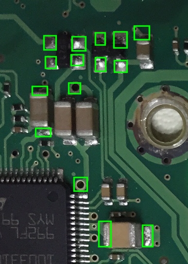

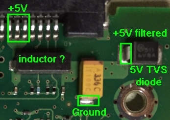

I haven't been able to make sense of everything, but I've marked those voltage test points that I would check.
It appears from the datasheets that the MCU, flash memory, and SDRAM require 3.3V Vio. I expect that the Vcore supply would be around 2V +/- 0.5V.

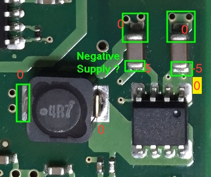

The read channel IC appears to require its own 2 supplies.

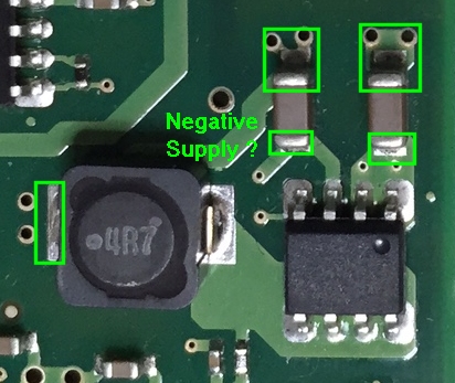

There is also another switchmode regulator, possibly a negative supply for the preamp.
The area that I've marked as unknown appears to be some kind of charge pump.

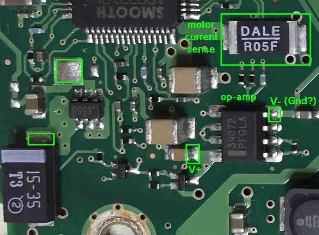

ISTM that there may be a dynamic short that appears only when the PCB tries to switch on some part of the circuityr.
I would start by measuring those test points on a working PCB. Once you have that information, I would test for shorts at the outputs of the identified onboard supplies. I would need the voltage measurements before I could proceed.
PostPosted: May 16th, 2015, 17:59
Joined: December 13th, 2008, 13:35
Posts: 308
Location: Los Angeles, CA USA

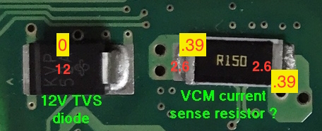

@fzabkar:
Ok, results in Red text are from "good" PCB. Any results that differ on "bad" PCB have Yellow highlight.
It's possible I made things worse while testing, because now the light doesn't come on at all. Arg! If I did make it worse, I think it happened when I was testing the upper-left chip in the "unknown.jpg" (which had 12, 17, 17, 22 volts on the "good" drive). At first these chips had voltage, then suddenly nothing - so I had to re-measure them all, and they pretty much all went to 0.
@Amarbir:
Thanks for the tips! I actually have some flux and a soldering iron on the way just for the reason you mentioned below (I saw almost exactly what you are describing in a video tutorial). We have never needed an iron as the hot air gun has worked well, but it does seem to be crucial to get rid of excess solder when used with flux + wick on these big chips.
PostPosted: May 16th, 2015, 18:13
Posts: 17231
ISTM that the problem may be a shorted 12V TVS diode. Did you actually test it?
PC PSUs will shut down and stay down in the presence of a short on any of their outputs, but other supplies will sometimes hiccup when driving into a short. Yours may be the latter type.
PostPosted: May 16th, 2015, 18:36
Posts: 308
It tests good and to be sure, I swapped with "good" drive's TVS and problem remains (dead).

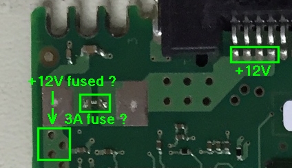

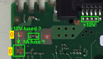

ISTM that there is a 3A fuse (?) at the top left corner. Is 12V present on the connector side, or does it hiccup?
What resistance do you measure between ground and the load side of the fuse? Use the 200 ohms range.

Not sure how to check resistance, but there are different readings for good/bad pcbs...

Measure the resistance of the fuse, and then measure the resistance of the 12V TVS diode in-circuit. A good fuse should measure close to 0.0 ohms on the 200 ohms range.
If the diode tests as a short, then there will be a short circuit on the +12V supply. Since you have replaced the diode, this means that the short will probably be due to the T3, 35V, 15uF capacitor (tantalum ?), the motor controller, or something in the charge pump (VCM boost) circuit.
PostPosted: May 16th, 2015, 20:33
Posts: 17231
If you confirm that the fuse is open, as it appears to be, and if you also confirm that there is no short on the load side of the fuse, then simply replace the fuse and give it a go. Perhaps the fuse failed due to fatigue. You could connect an ordinary glass fuse with lead wires.

Unless I'm not understanding my multimeter correctly, manual ranges only include 6, 60, and 600. I did get a reading of .3 on 600. Anyhow, I moved the fuse and the problem remains. I want to thank you for your help fzabkar, but I'll be stopping efforts on this line of inquiry due to speed up this recovery. Instead, I'm having a friend at another DR company move the chip for us.
Do you mean "moved' as in replaced, or do you mean "removed"?
If the fuse reads 0.3 ohms, then it is good. That then begs the question, how can you measure 12V on the incoming side and 0V on the load side? If these measurements are correct, then the component could be a polyswitch, ie a resettable fuse. In this case there would be a short circuit on the load side. That's why I asked you to measure the 12V TVS diode in-circuit.
AISI, the problem has a trivial solution that doesn't warrant reaching for the blowtorch.

"Moved" as in moved the good fuse from the good drive to the bad drive.
