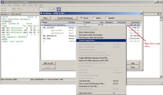

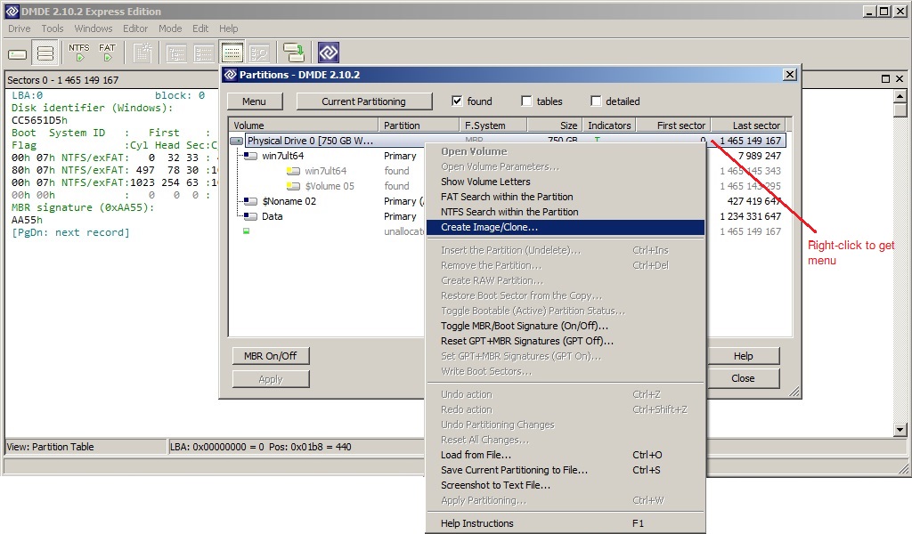

The new hard drive that you put the image on can be anything with at least a few 100MB more space than your DR-Disk. Example if bad disk is 1TB, you should have 1.5TB new one.
DONT WORRY ABOUT WHAT WINDOWS TELLS YOU. Ignore it. even if it says reformat disk or whatever, don't worry. as long as you see the Disk in DMDE, that's all that matters.
DR in pictures: If a picture says a thousand words, here is 3,000 :-)

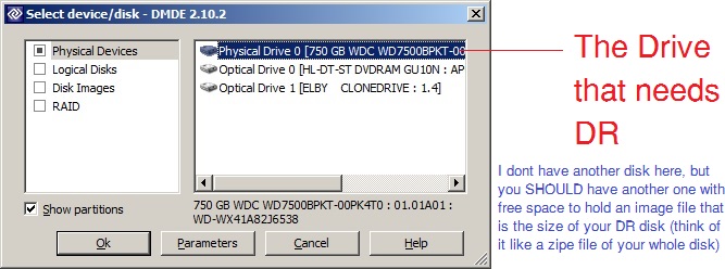

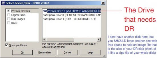

1. choose disk

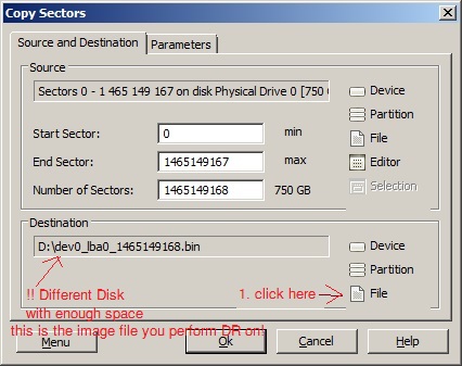

2. choose to image it
3. choose destination
4. you now have an image file of your disk and all DR should be done on that Image file. in GetDataBack, choose "load image file"
the results of this will show how badly you stuffed up the disk. BTW, we have all stuffed up disks, so we definitely are not saying anything negative simply because you are currently inexperienced.
