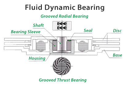

Would Data Extractor clone at a faster speed than 43GB in a week? Unfortunately, the drive motor has seized once again. Does anyone know the root cause of the problem is inside the motor, I mean, can the motor bearings be lubricated?

1. Forcing seized motors rarely works. I know, I've tried.
2. +1 for DE. Anything else is crap in my opinion.
3. I hope you checked the heads for damage before turning on a dropped drive.
4. Send it to someone that can handle this type of work before your customer loses their data forever.
5. Lubricating the bearings doesn't work. I know, I've tried.
6. Purchase better tools if you want to do DR.

Lubricating the bearings is not advisable at all and won't help.
As all the HDDs produced in the last decade or so use a Fluid Dynamic Bearing (FDB), with an oil-filled gap of ~2 µm between the rotating shaft and stationary sleeve.
