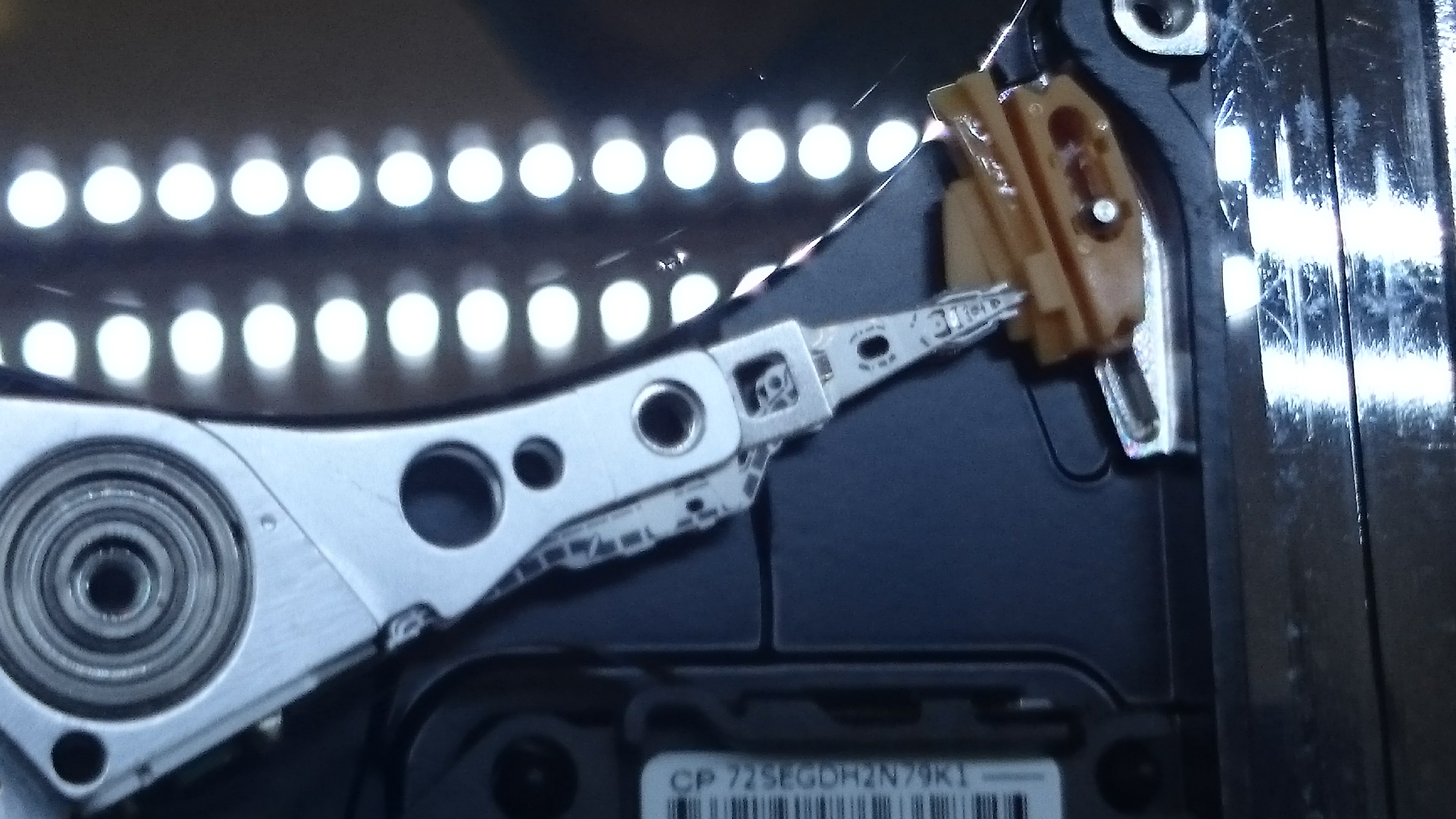

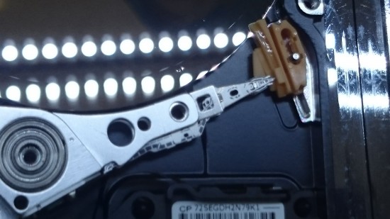

I opened the drive to see what cause the bzz-bzz sound, and i saw this.

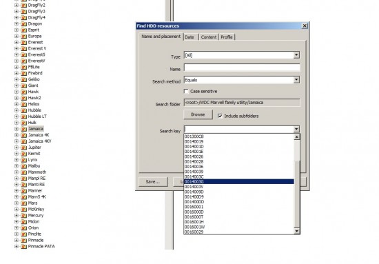

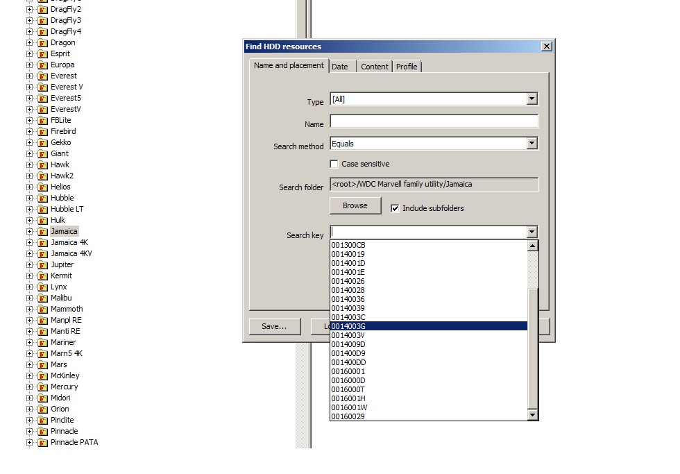

Posts: 2857
saltwater wrote:
....I'm still looking an overlay module for this drive.
can you tell me the ROM ver.?
 Post subject: Re: Overlay module need for WD2500BEVT-80A23T0 drive
PostPosted: June 8th, 2015, 13:23
Posts: 331
Sure!
14003R
PostPosted: June 9th, 2015, 0:50
Posts: 2857
I guess i don`t have the exact ver.
here is what i got in my db
i never tried Sediv and don`t know much about it, but if you have the UDMA, i can help u with it.
good luck

Case closed, data recovered 100% with HSA exchange, and smart hot swap method.
