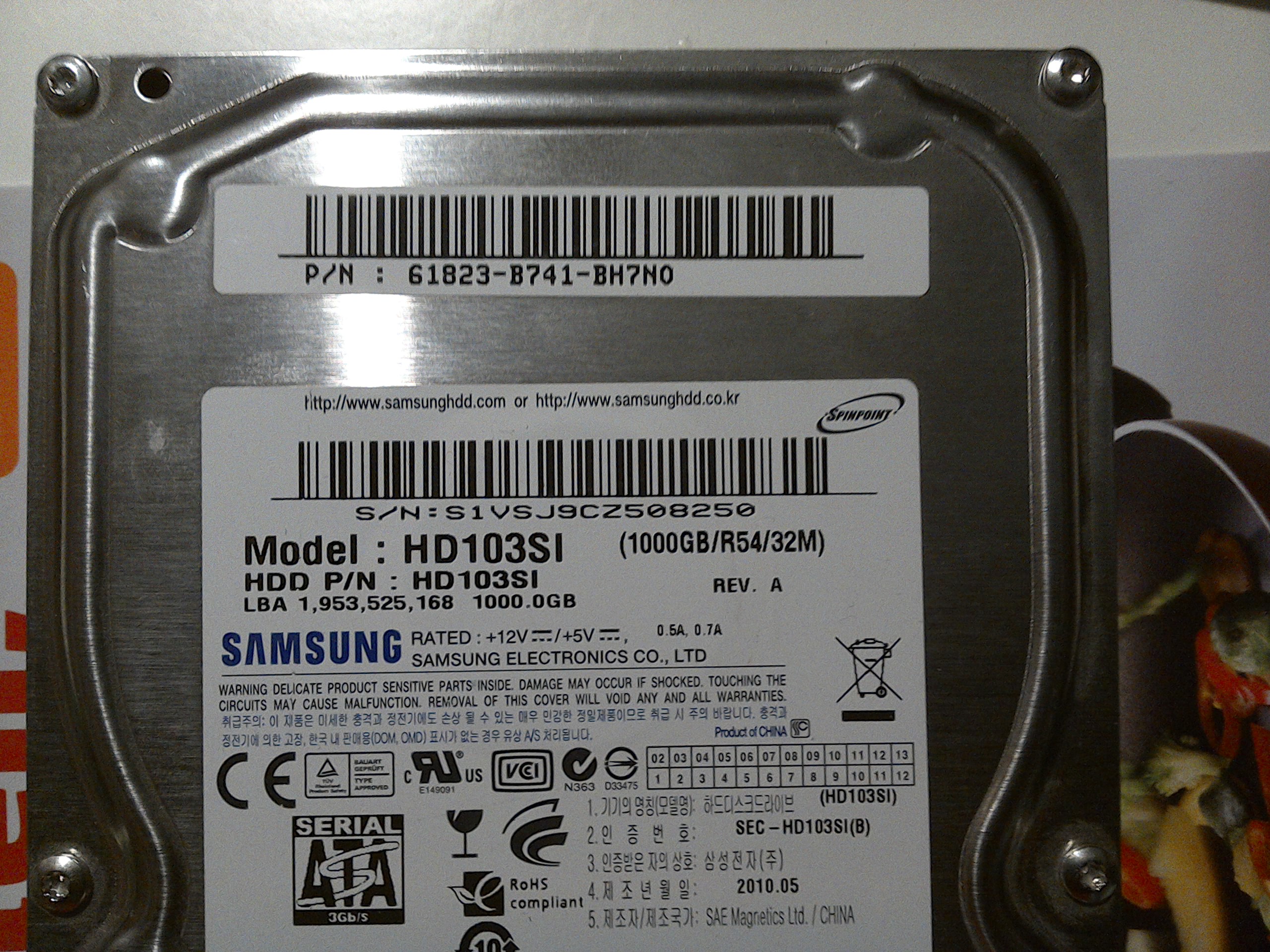

Main actor of my miserable story is a Samsung HD103SI (1TB). For years this drive has been working connected to a Gigabyte GA-EP45-UD3LP Mainboard. It is a SATA300 HDD. A week ago i got an ICYBOX case and put the drive there (externally via Usb). I used the drive once or twice and had access to my data on it. But then after a couple of days i powered the drive on and had no access. The HDD did not even show up in Win7 storage manager.

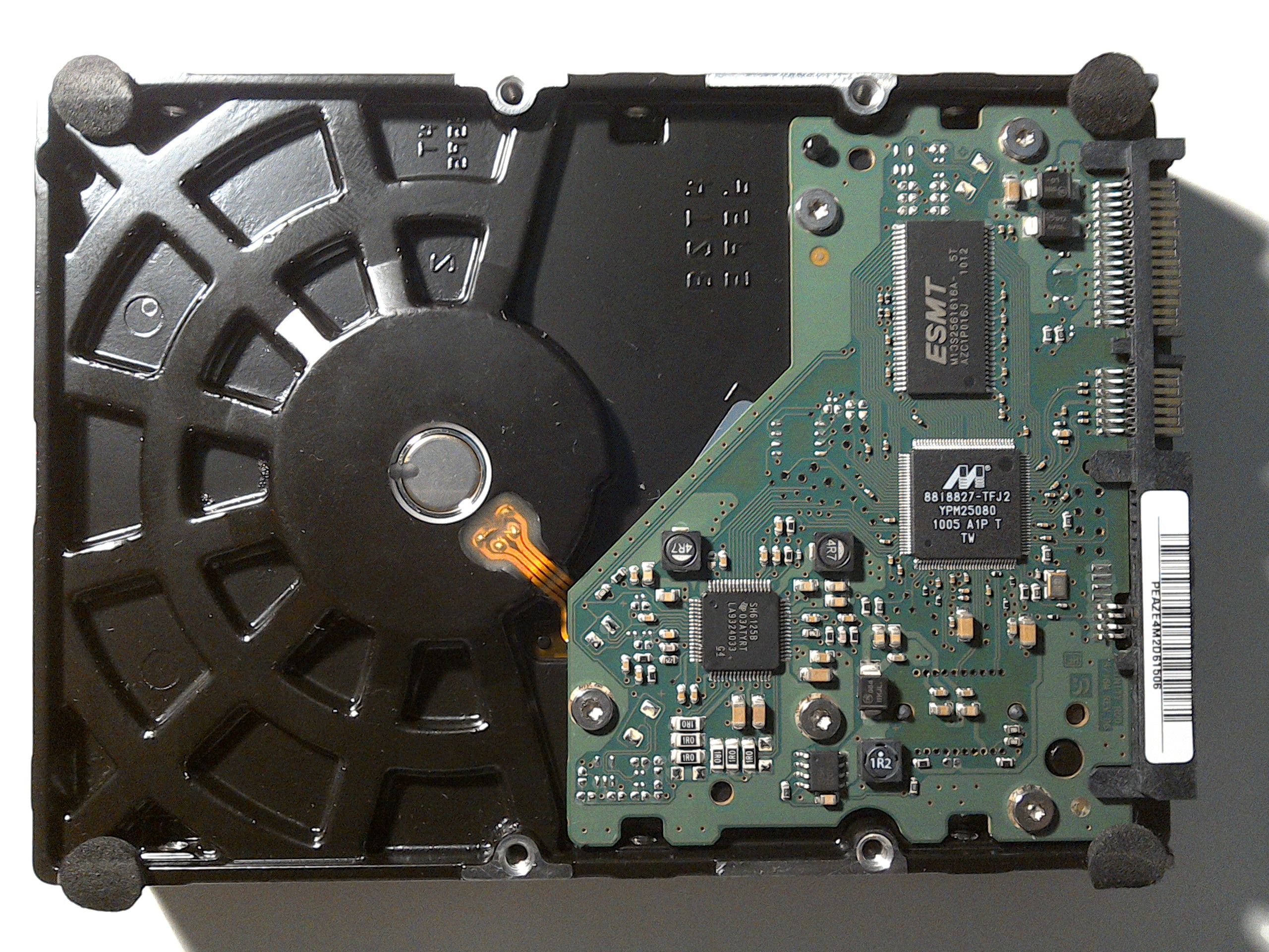

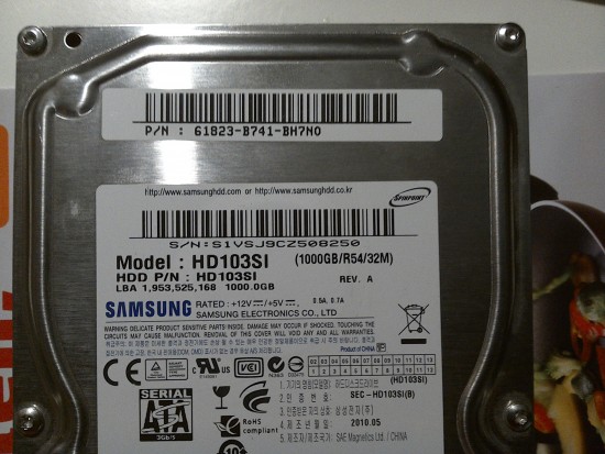

I wrote "mechanical" but did not mean exactly that. I was rather suggesting that it might be the electronics of the drive. Sending to a pro seems to be very expensive so i would like to rule out the possibility, that I can fix it by changing the circuits on the bottom. Would u not try that?
Another detail someone pointed out to me: When the drive starts I hear the usual sequential noice indicating read operationson on the drive. These sequences used to be 4 in number but seem to be like 6 now. Seems to try more often then before. I also tried the drive on many systems with many OS and none could detect the drive or rather got stuck once the drive got plugged in.

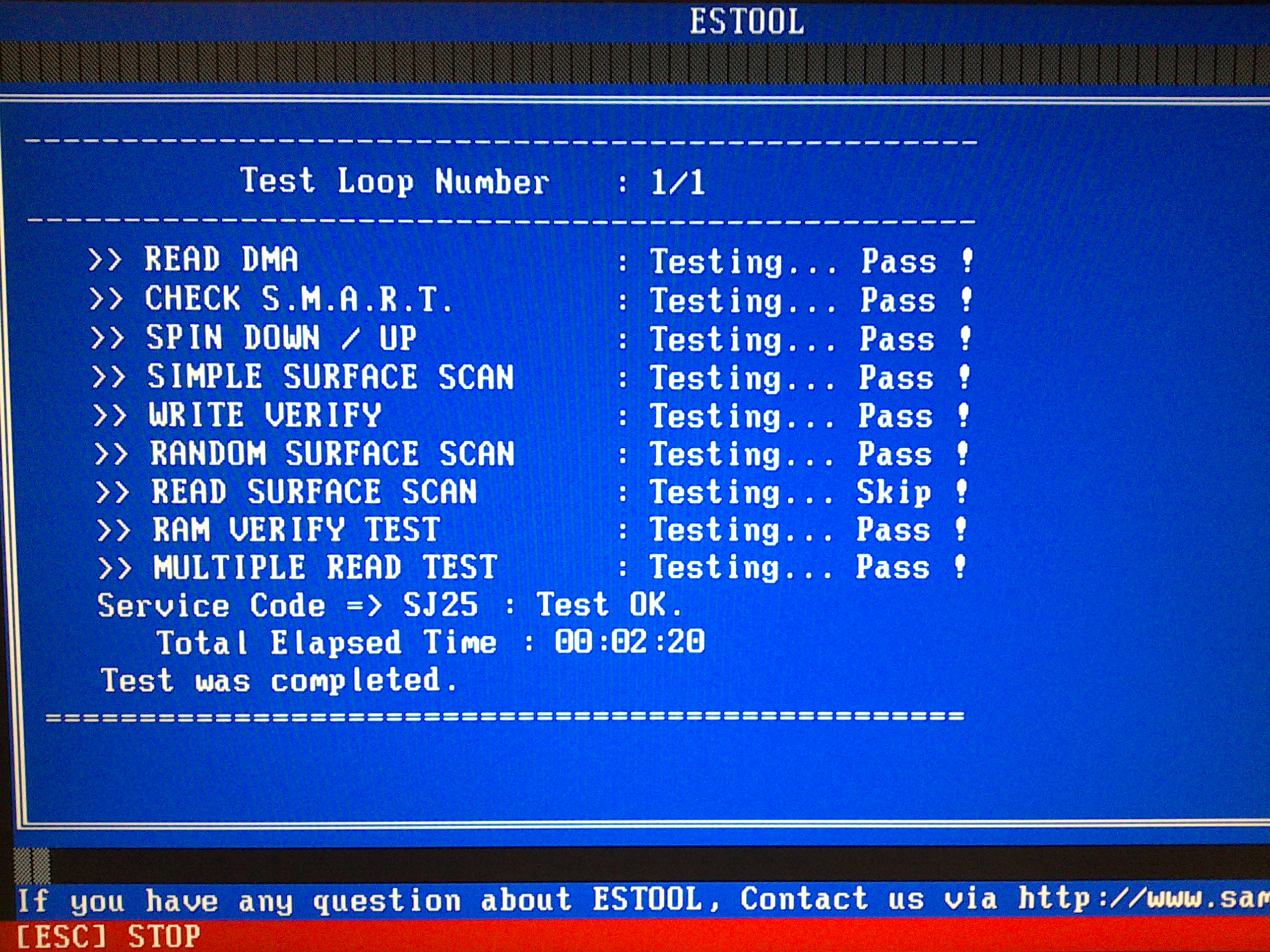

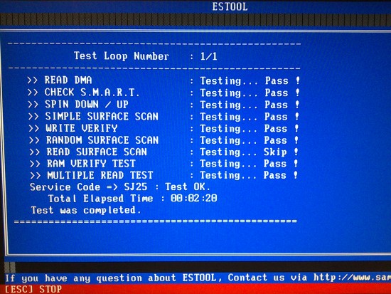

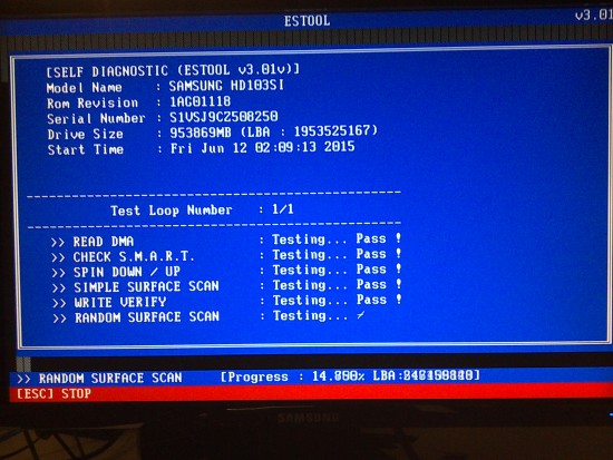

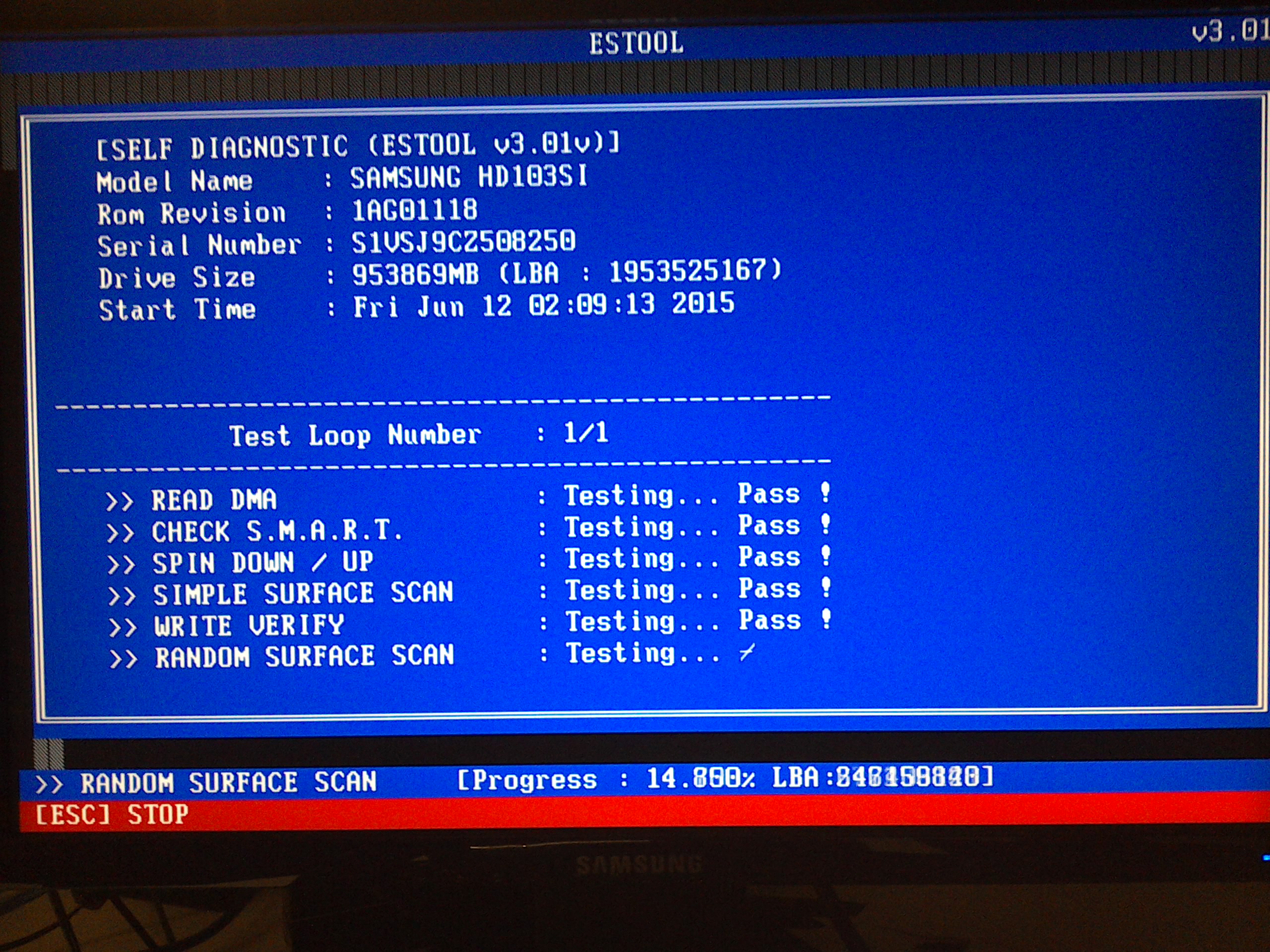

Right after I gave up hope I said, "funk it! one last try". Some BIOS changes allowed me to get to UBCD tools again. I cant use Windows tools to give u the info u wanted but here are some screenshots attached. I am looking to fine some tool on the UBCD to read the smart info.
 Post subject: Re: Hardware works but Windows does not recognise the HDD
PostPosted: June 12th, 2015, 3:39
Joined: July 12th, 2014, 6:24
Posts: 91
Location: Berlin, Germany
I would not run tests on a drive you want the data from, that might cause more damage to the heads if they are weak or there is media damage. Have you tried to boot up a linux? You can check SMART there and dmesg will also give some hints if there is a problem with the disk.
I would download CAINE: h**p://www.caine-live.net/page5/page5.html boot that CD and check the drive by the drive utility. This utility will give you SMART info too.
As long as the drive is detected in BIOS DR by a pro should not cost too much: The heads might "only" be weak and not damaged, so it might be possible to recover data without clean room work. Changing PCB will not help, you could check if pcb contacts are ok and clean them but I do not think that will help much here.
If data is important, do not run surface scans or try to repair the disk by software, it might cause more damage.

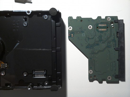

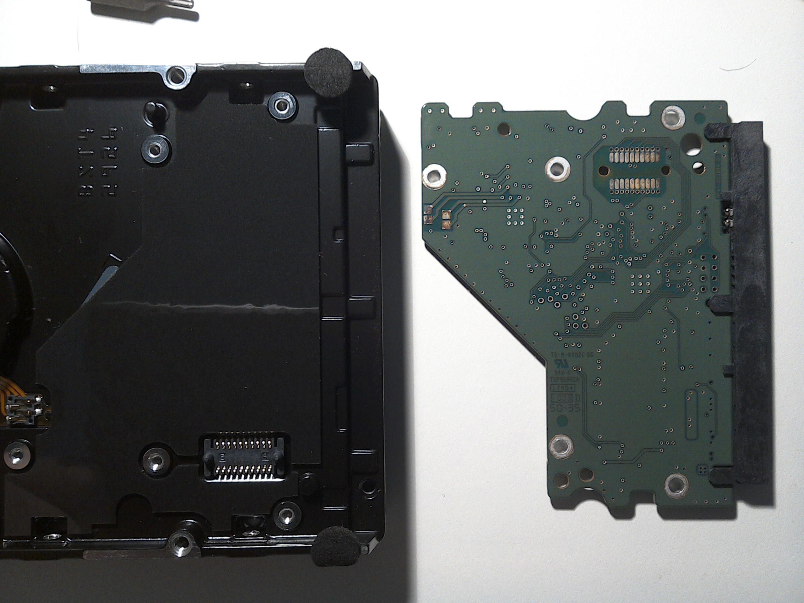

PostPosted: June 12th, 2015, 4:53
Joined: June 7th, 2015, 7:01
Posts: 6
Location: Germany

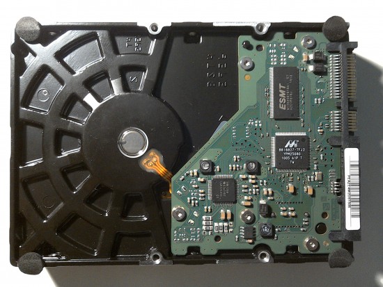

I disassembled the PCB. You can see the contacts. Before I read your comments i also thought that they might justneed some cleaning.
To be honest... First thing i did before i posted the first post was trying to reset fix MBR. This might have costed me some partitions ?! Maybe. Currently Iam only trying to get the SMART data. But the tool on the UBCD is not giving me much that I understand. I will make screenshots once I cleaned the contacts and put it back together.
