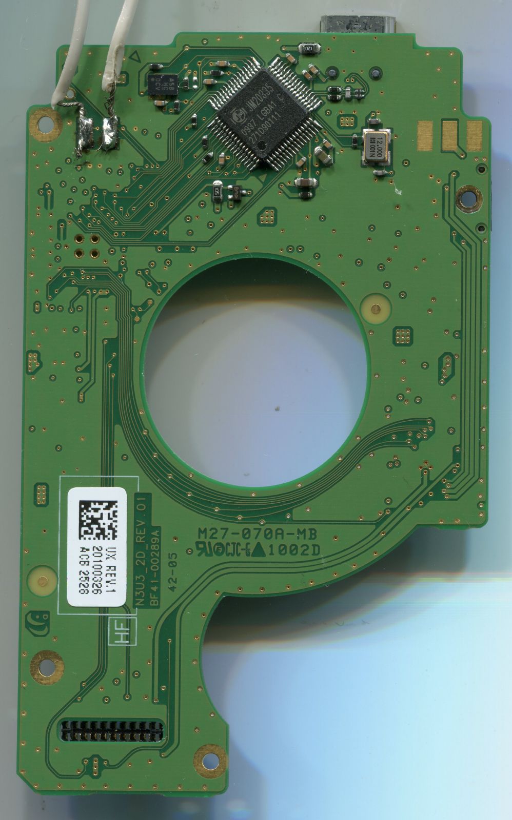

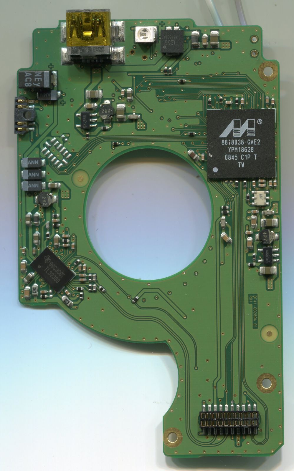

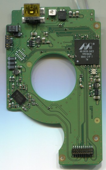

Samsung HS25YJZ 1.8" drive
I looking for compatible PATA PCB (with same MCU). Friends, can you check your resources?

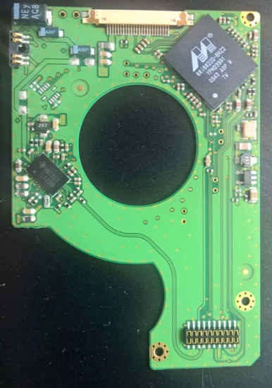

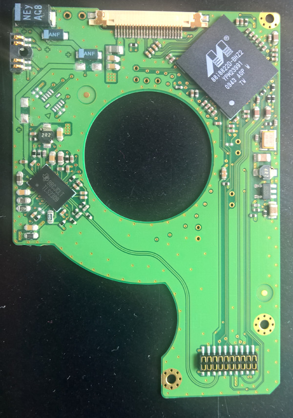

 Post subject: Re: Samsung HS25YJZ - need PATA PCB
PostPosted: June 16th, 2015, 12:49
Joined: March 6th, 2010, 3:46
Posts: 627
Location: Kolding | Denmark
MichaƂ I have only seen 88i8822D on these :(
File comment: Sammy_pcb
PostPosted: June 16th, 2015, 13:13
Posts: 627
I guess that your 88i8038 includes USB IF
I have used a HS12UHE ZIF PCB with 88i22D on a HS120JY USB drive ( do not remember MCU on the USB version )
But it worked fine
PostPosted: June 16th, 2015, 15:16
Have a hard time getting a sense of what the compatible ZIF PCB would be for the USB version with no physical drives available and very limited resources online.
There are some similar drives that are MicroSATA interface, so maybe something to explore.
What is the green etch PCB code just out of curiosity?
Edit: whoops, forgot about the zoom feature on pic..

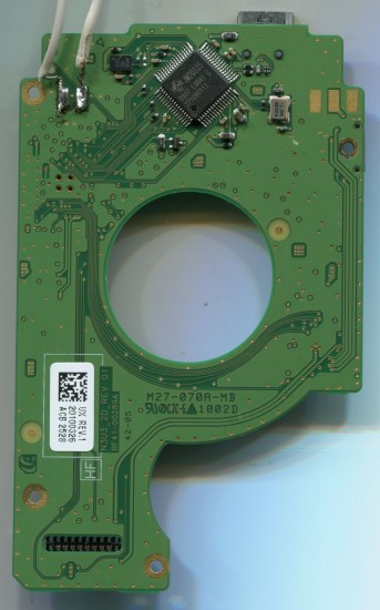

PostPosted: June 16th, 2015, 15:37
Posts: 922
Here is the other side of PCB. I think other version of MCU will not work. But maybe someone have different experience?
PCB has independent USB controller. I can't find datasheet for it (JM20335).
