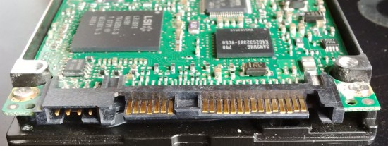

Hello friends
here you a good question
The drive in subject
is reported as with a failure, it sounds good but the SAS card BIOS at boot reports it as with an error (in SAS card BIOS the model name is shown correctly)
But next e.g. in the Linux disk utility only the name is reported but no other details, expecially the capacity
I was wondering if it could be matter of translator.
As others ST drives, it has its TTL serial port connection port... (see attached picture) do you know if any terminal action is possible through that port?
Thank you
File comment: ST9146802SS board connectors

There is no ASCII terminal.

Corsari wrote:
The drive in subject is reported as with a failure
If this drive shows zero capacity, then it's a translator failure.
According to the description, I'd give 8 or even 9 out of 10 to that assumption.
Serial port on server hard drive families does not support ASCII terminal, only ESLIP one (binary). And its functionality is different.
