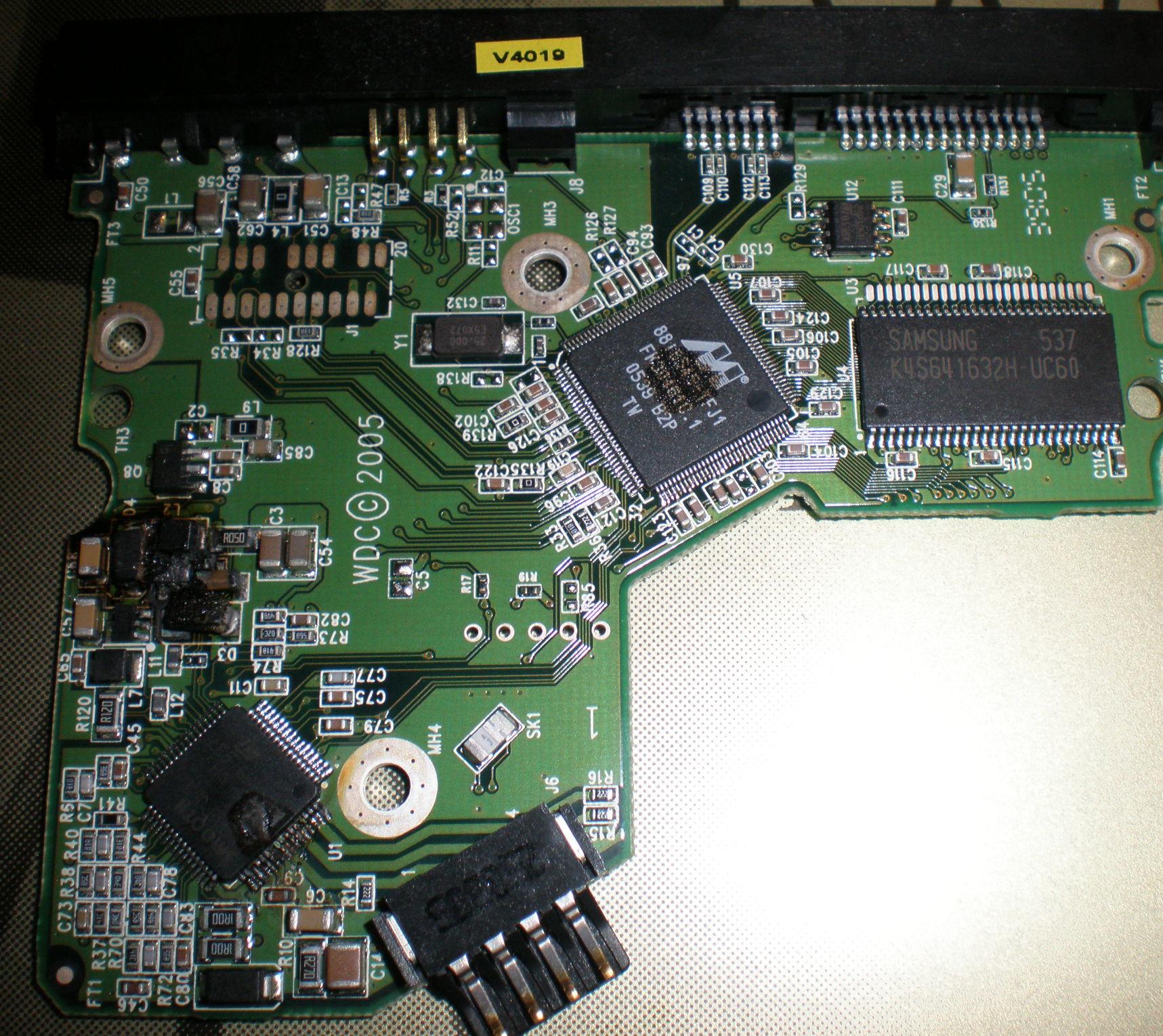

 Post subject: Ready to recover data: WD1600JS Photo of damage
PostPosted: June 17th, 2008, 9:53
Joined: June 17th, 2008, 9:02
Posts: 5
I've read quite a few success stories on these forums so i thought I might have a go at recovering my data. :P
My psu blew up recently, and I found it has burnt out my WD1600JS PCB. I will be getting a closely matching board I'd like to try to use as a donor.
Dead PCB:
MDL: WD1600JS-00MHB0
DCM: DSBHCTJAA
Sticker: 2061-701335-B00 AF
PCB: 2060-701335-005 Rev A
Donor PCB: WD2500JS-00MHB0
DCM: DSBACTJCA
Sticker: 2061-701335-B00 AH
PCB: 2060-701335-005 Rev A ----identical
Is this worth trying? As you can see there are some differences between the boards, but not many.
I figured the first step is to replace the U12 ROM chip from the dead pcb to the donor pcb, then stick the donor in and give it a whirl??
Any suggestions or advice for this new and aspiring data recovery technician :)
File comment: There are three areas of burn damage.

You are on a right track.
Just keep in mind that your ROm chip could be dead from a power surge also.

I'm hoping the ROM chip isn't dead, but I guess if it doesn't work I'll blame the ROM.
I'll keep updating the thread as I try new things, for myself and others with similar problems. :D
I finally received the suitable PCB. I actually have 2 dead drives, and the donor matches almost exact to one of them, and closely to the other (first post).
A simple PCB transfer was unsuccessful on both.
heres what happened
Donor WD2500JS
1. Dead WD2500JS
The platters start spinning and continue spinning when powered. Bios recognises the drive as "WDC ROM Model - Hawk", windows can't see the drive. I took a close look at the U12 chip on both, and it looks like they have different codes.
2. Dead WD1600JS
Drive makes clicking noises and then powers off. Bios recognises drive as ""WDC ROM Model - Hawk".
Now I'll try swapping the U12 chip. To be honest I don't look forward to desoldering the U12 because it looks hard to avoid damaging the chip and board.
However I'm all setup to go ahead, will let you know how it goes.

Success!
The U12 swap worked wonders, I was able to retrieve all my data from the WD1600JS. :D
During the desolder I was very careful, and basically used wick to remove solder, then heated the pad and lifted the leg with a pin. Not the best method, but these were all the tools I had to use. Soldering the chip onto the PCB I didn't find easy, but again I was careful and took my time so as not to heat up the chip too much.
After putting the modified PCB onto the WD1600JS, the first sign it was working was in the bios where it was recognised with the proper code, man what a relief it was seeing that bios screen. The drive seemed rock solid while copying files over.
I think I might try to put the original U12 chip back on the donor PCB, and use that HDD from now on. Or perhaps my newfound confidence is pushing the boundaries by doing this. I can't see any problem though, as long as my soldering job is good.
Can I say, a big thankyou to the gurus on this forum. By reading various threads outlining the procedures I was able to recover some important files from a HDD I would have otherwise thrown in the bin.
