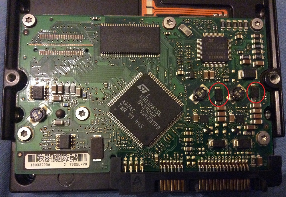

 Post subject: Re: PSU broke and took HDD with it
PostPosted: June 26th, 2015, 8:15
Joined: June 1st, 2015, 11:57
Posts: 17
Ok then I read the article you linked to, all credits go to fzabkar :)
One of the two I have highlighted or both of them?
http://imgur.com/HUYXVoa
Do you think that if I removed the TVS diode there is a good chance the drive will work? Are you aware of this drive having any additional protection as mentioned in the article?
PostPosted: June 26th, 2015, 8:31
Posts: 17
After looking closely at the markings on the two diode's, the one of the left in the picture is marked 'AE GP435', is this the right one?
PostPosted: June 26th, 2015, 9:36
Posts: 2984
Just make straight swap of PCB - ROM on this series is not adaptive and its very possible you need no transfer of adaptives. Also, do not connect to same system that causes this issue initially. If you exchange PCB and it makes strange sounds or knocking consult a professional. If it appears fine but no identification it could be due to differences in ROM so you should swap it. Any issues or problems or if there is any uncertainty then you should consult a professional - at this point it should be a relatively simple fix for a decent pro.
PostPosted: June 26th, 2015, 9:57
Posts: 1388
Location: isreal
yes
why all the trouble ? you have a match PCB, just do as hddguy suggested
this is the 5V the other one is the 12V
PostPosted: June 26th, 2015, 14:41
Posts: 17
So I followed your advice and just swapped the PCB's and the drive is working again. Thanks to everyone who posted with suggestions, I really appreciate your help :D .
Now just out of curiosity, which component(s) do you think are likely to have failed on the broken PCB?
Im assuming it will be something inside the red circle:
http://imgur.com/Zn7a82j
According to fzabkar's article, it could be just either the 5v or 12v TVS diode, but the drive may have additional overvoltage protection like "a fuse, polyswitch, inductor or zero-ohm resistor". I am not even sure what polyswitch's or inductor's are.

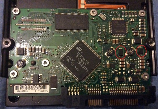

PostPosted: June 29th, 2015, 11:55
Posts: 17
I measured the two TVS diodes and they both give a reading of around 70-80 ohms so I don't think they are the problem.
There are however another two diodes further away from the power connector that give a reading of 0 when measured, could this be the problem? I have highlighted them in the picture below:
PostPosted: June 29th, 2015, 15:09
Posts: 17316
A shorted TVS diode would have shut down the PSU. As expected, your diodes were not shorted.
Those other two diodes are the flywheel diodes in the Vcore and Vio buck regulators. They should not measure 0 ohms. That is not to say they are faulty. Rather, it suggests that the ST MCU is damaged.
If you measure 0.0 ohms (not "OL") across the corresponding capacitors (see attachment), then the Vcore and Vio supplies are shorted. Better still, measure the voltage across the capacitors when the PCB is powered up. You can remove the PCB from the drive for these tests.
PostPosted: July 1st, 2015, 8:13
Posts: 17
So it seems I made a mistake measuring the flywheel diodes, only the one on the 5v supply is bad giving a reading of 0.08ohms, the one on the 12v supply reads 15.8ohms.
The 4 capacitor's on the 12v supply have a resistance of around 12.7ohms and measure 4.7v when the PCB is powered up.
The 3 capacitor's on the 5v supply all have a resistance of 0.08ohms and measure 0.08v when the PCB is powered up, also the component to the left of the flywheel diode, marked 3R3 has a resistance of 0.05ohms. So it seems everything on the 5v supply fried when the PSU died, Is it likely that the damage is limited to these 5 components?
PostPosted: July 2nd, 2015, 16:40
Posts: 17316
Those are not 5V and 12V flywheel diodes. That area of the circuit generates the Vcore (+1V - +2V ?) and Vio (+3.3V) voltages for the ST MCU chip plus the Samsung SDRAM and 8-pin serial flash memory at the bottom left corner. AFAICT, both circuits would be powered from the 5V supply.
I expect that the 4-capacitor circuit would be the Vcore while the 3-capacitor circuit would be the Vio. You could verify this by testing for continuity with pin #1 of the SDRAM or pin #8 of the flash memory. Note that one of these supplies is shorted to ground. The reading of 4.7V suggests that the associated 8-pin PWM controller IC (2957 ?) is faulty (possible shorted chopper), which in turn means that any component connected to that supply may have failed.
