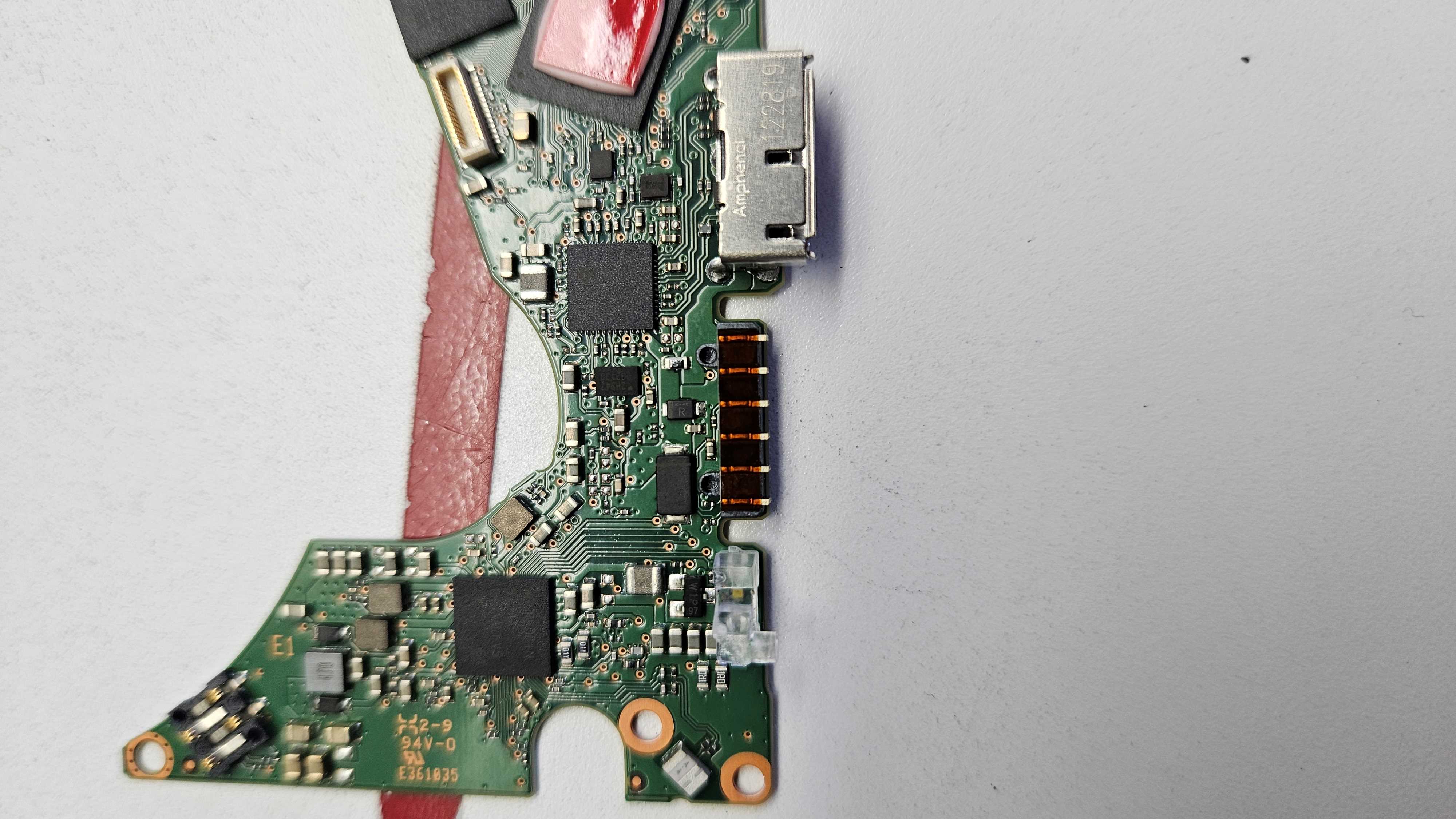

 Post subject: WD20SDRW no spin
PostPosted: December 21st, 2023, 14:12
Joined: October 28th, 2008, 16:25
Posts: 23
Location: US
I wanted to ask if someone could point to where I should measure to check the fuse or TVS on this drive, does not spin. - Thank you
 Post subject: Re: WD20SDRW no spin
PostPosted: December 21st, 2023, 14:30
Posts: 17230
TVS diode = the larger diode above the smaller "R" Schottky diode
Fuse = "S"
Both are located adjacent to the 12-pin header.
