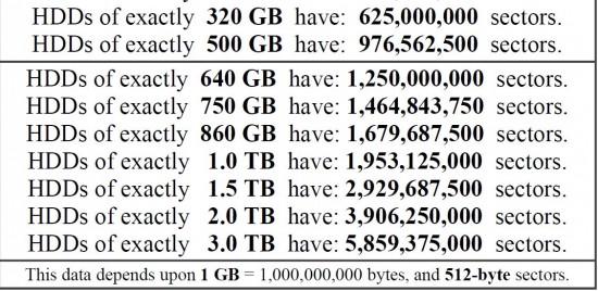

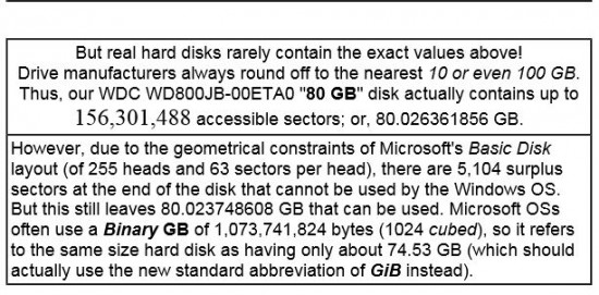

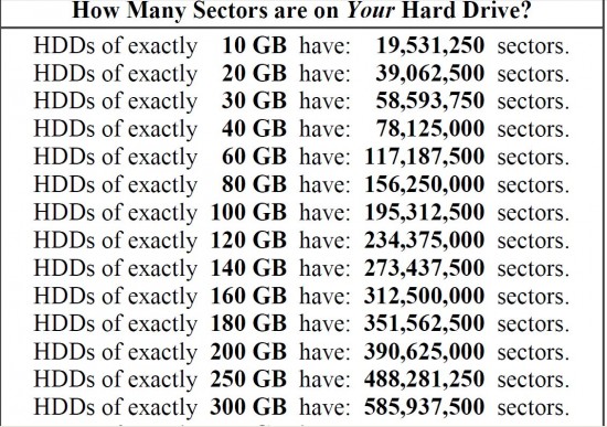

 Post subject: Hard DIsk size >>> LAB sector count calculator
PostPosted: July 9th, 2015, 2:31
Joined: August 6th, 2007, 13:12
Posts: 181
Is there simple calculator to know no. of sectors of a disk when size is entered.
Often I need to reduce size of larger disk & this tool will be helpful. It will be also useful to create a virtual volume in DE .
 Post subject: Re: Hard DIsk size >>> LAB sector count calculator
PostPosted: July 9th, 2015, 2:41
Posts: 1388
Location: isreal
how about using a simple excel sheet
 Post subject: Re: Hard DIsk size >>> LAB sector count calculator
PostPosted: July 9th, 2015, 3:15
Posts: 17343
That's just simple arithmetic, isn't it?
Just use the calculator that comes with your Windows version.
 Post subject: Re: Hard DIsk size >>> LAB sector count calculator
PostPosted: July 9th, 2015, 15:29
Posts: 17343
Assuming that all that is required is a "tool" to divide a number by 512 or 4096, then Google's calculator is another option.
http://www.google.com.au/search?q=1+TB+/+512+B
http://www.google.com.au/search?q=100+GiB+/+512+B
http://www.google.com.au/search?q=500+GB+/+4096+bytes
 Post subject: Re: Hard DIsk size >>> LAB sector count calculator
PostPosted: July 10th, 2015, 1:12
Joined: August 6th, 2007, 13:12
Posts: 181
Thanks both fzabkar & jermy
I have found this details in http://thestarman.narod.ru/asm/mbr/DriveOffsets.htm
article also shows what is cluster size & file system details. Interesting read.
Attaching disk size tables.
hdd size2.JPG
hdd size2.JPG [ 77.84 KiB | Viewed 14710 times ]
hdd size1.JPG
hdd size1.JPG [ 166.31 KiB | Viewed 14710 times ]
hdd size.JPG
hdd size.JPG [ 231.92 KiB | Viewed 14710 times ]
 Post subject: Re: Hard DIsk size >>> LAB sector count calculator
PostPosted: July 10th, 2015, 1:28
Joined: February 12th, 2008, 18:21
Posts: 25
As your chart mentions, this is only correct for drives of "exactly" the size mentioned and only for 512 byte sectors. I wouldn't rely on that chart if you need to know how many sectors are on a drive of a specific size. Most drives have at either LBA or CHS values on them. The LBA will equal the number of 512-byte sectors on the drive. Or multiply C*H*S to find the number of sectors. If you need to create a virtual disk or volume and just need the number of sectors to enter, then the chart should be fine.
 Post subject: Re: Hard DIsk size >>> LAB sector count calculator
PostPosted: July 10th, 2015, 1:43
Joined: August 6th, 2007, 13:12
Posts: 181
yes agree
here are some of the calculators --
http://www.t1shopper.com/tools/calculate/
http://www.csgnetwork.com/mediasizecalc.html
http://www.dr-lex.be/info-stuff/bytecalc.html
 Post subject: Re: Hard DIsk size >>> LAB sector count calculator
PostPosted: July 12th, 2015, 3:41
Joined: May 30th, 2014, 0:54
Posts: 153
Location: Universe
A relatively simple topic , but I am getting different sizes in different locations --
As per fzabkars calculator -- 19531250 & 156250000 -- 2 different counts
as per Seagate - 156301488
160GB SATA has exactly - 312581808 sectors so 80 Gb should have -156290904
which one is correct ?
