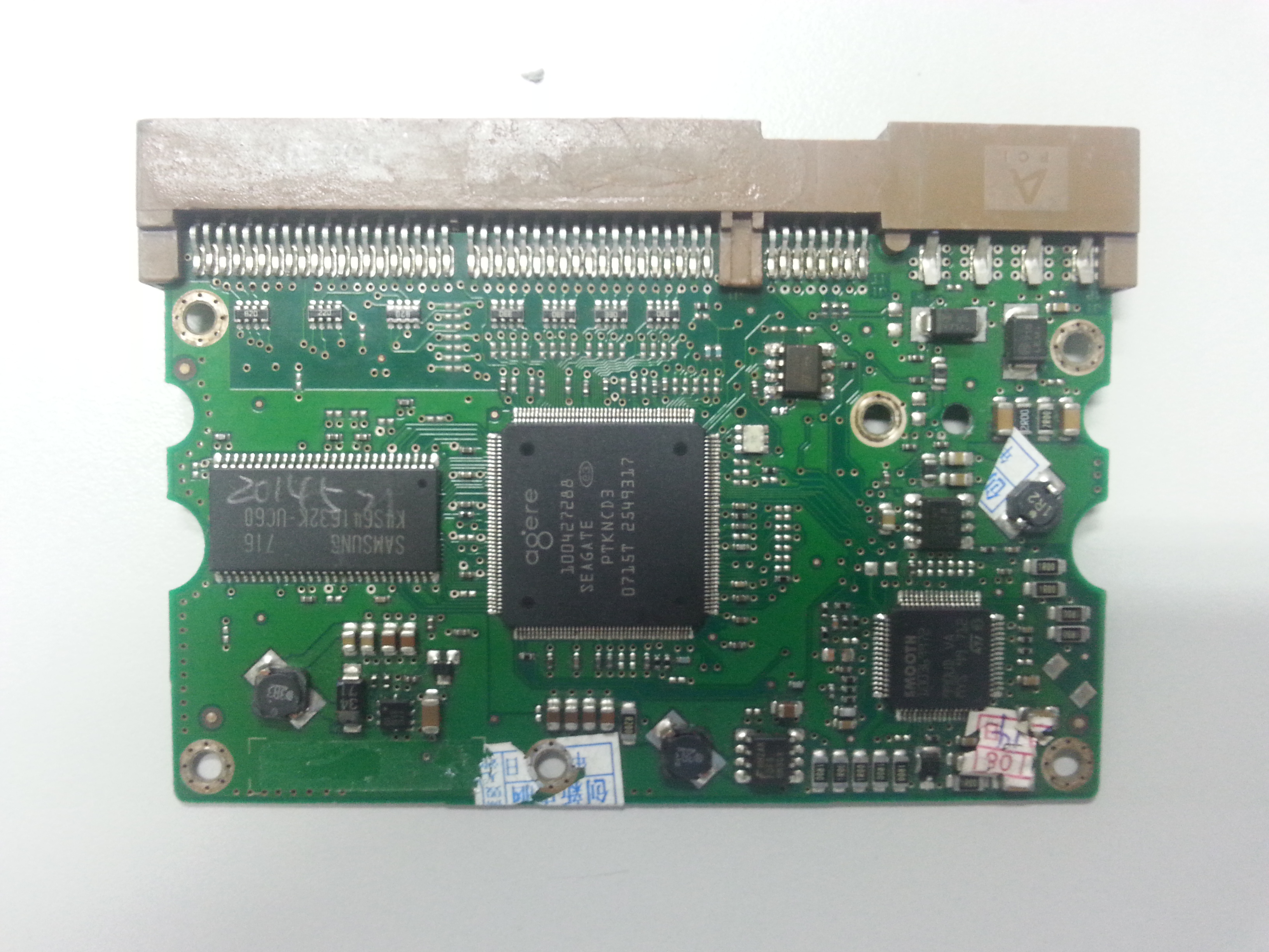

I have a ST3320820A with PCB burnt. On the PCB there are 3 8-legged chips but just one of them start with 25xxxxx. I replaced this one but the disk still not working.
Does anyone know if one of the other 2 chips belongs to the ROM as well.
Picture of PCB below:
Thanks.

"ROM" chip is the top one.
How do you mean "still not working" ?
Still dead?

Still not working means strange clicking noises. Heads are OK.

How do you know heads are OK?
You've changed the heads assembly, which includes preamp?

Does anyone have a general guide to check PCB's? Like which components should be check and what expect from each one?

What was burnt on the original PCB?
