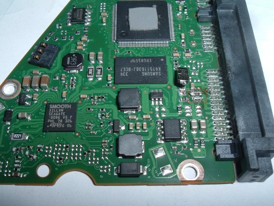

If your board is like this one ...
http://ep.yimg.com/ay/yhst-144375849714 ... 4301-7.gif
... then the regulators are inside the Dillon SMOOTH chip. Measure the resistance between each coil and ground.
There is one 8-pin chip near the SATA power connector, but I can't see what it does.

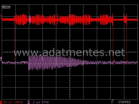

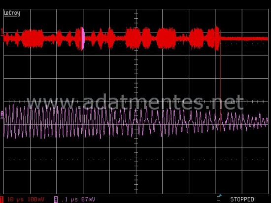

This is not BS, but i won't argue. Just put 2 pics here from one of my posts in 2010 and let them speak for me.

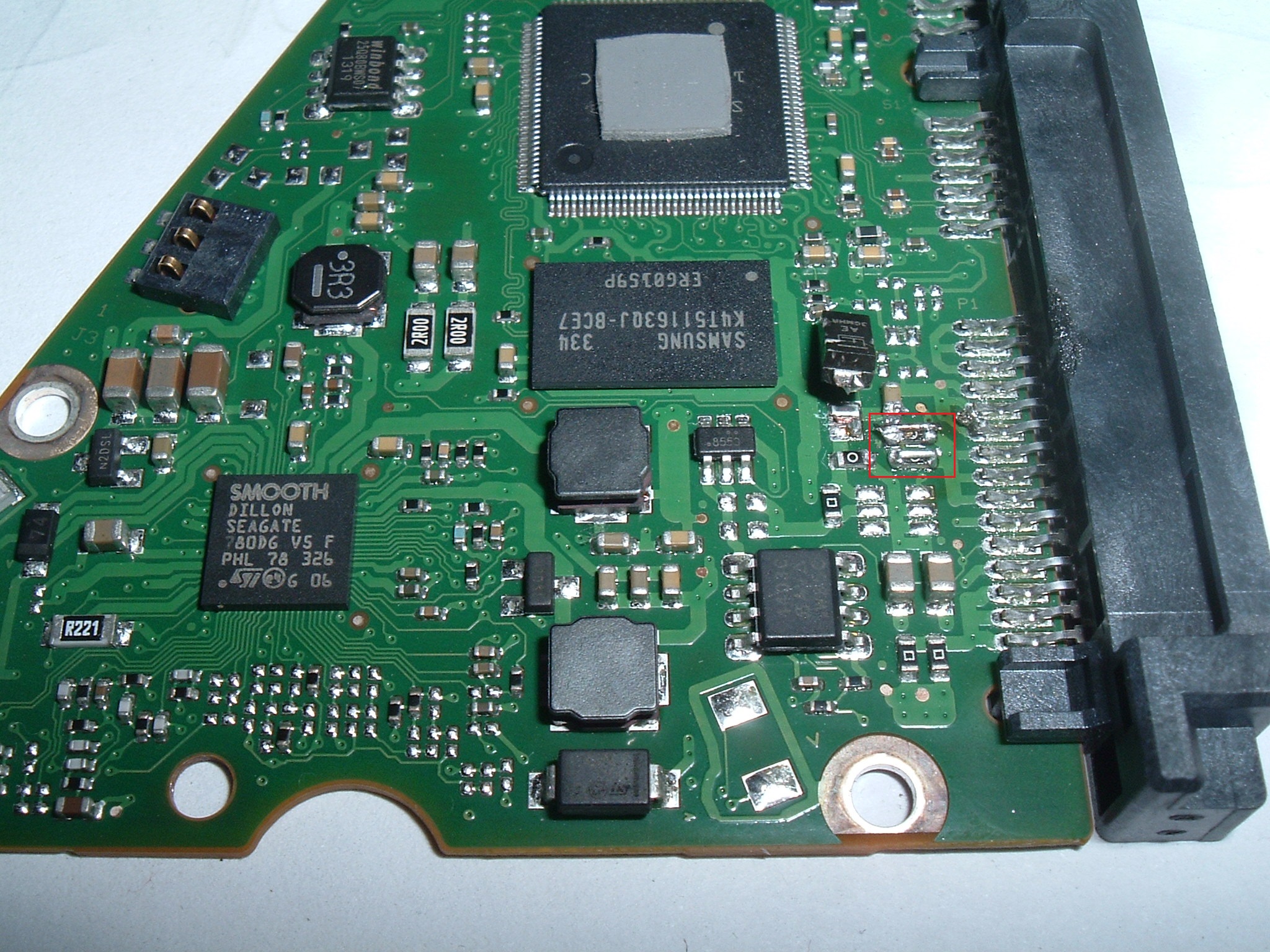

Gentlemen,
Firstly, really sorry for late reply, I had time to verify this issue only yesterday. Anyway, I'm posting the feedback to let you know (and sharing information) who the ohm diode by-bass procedure worked here. The data is safe.
@fzabkar, follow the PCB images with the fix. I don't snip the TVS diode entirely because I will resolder it to send the HDD to RMA service. I have other PCB questions, but I will open a new topic about it.
Thanks for the forum, and to all members for sharing knowledge.
Regards,
