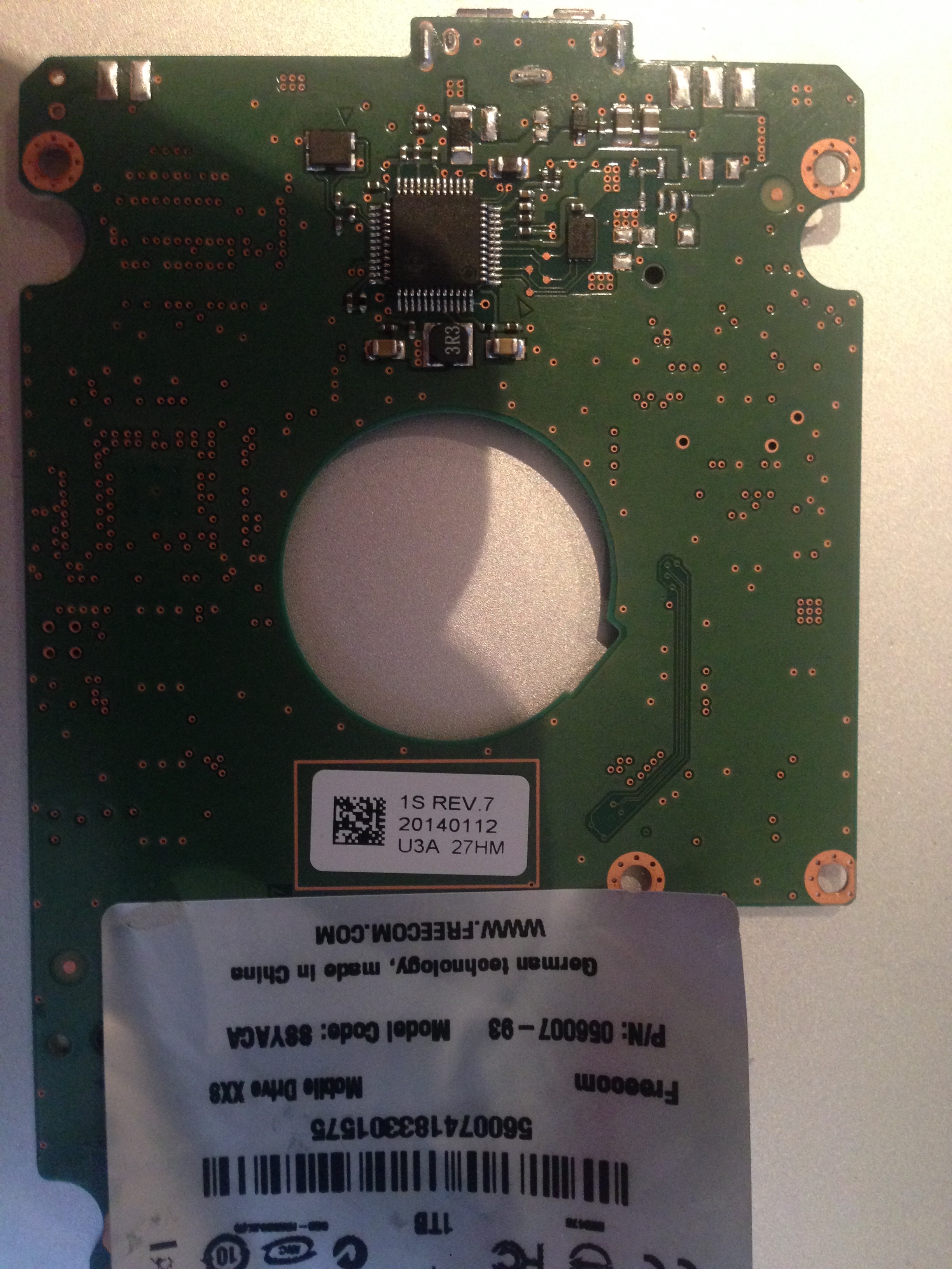

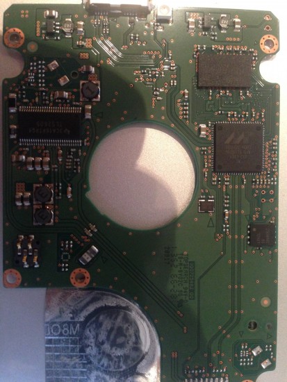

I could help with a PCB repair, if it is feasible, but you would need to upload detailed photos or scans of both sides (CCD scanner, not CIS). ISTR that Samsung's USB PCBs have protection components across the 5V input.

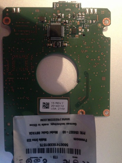

Thanks for your input - Are these pics good enough? I don't have a scanner!
Thanks in advance

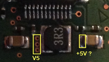

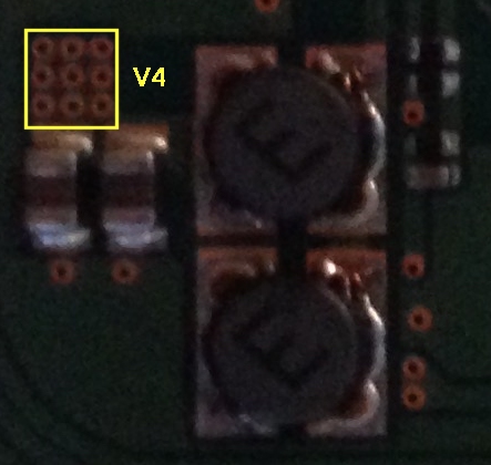

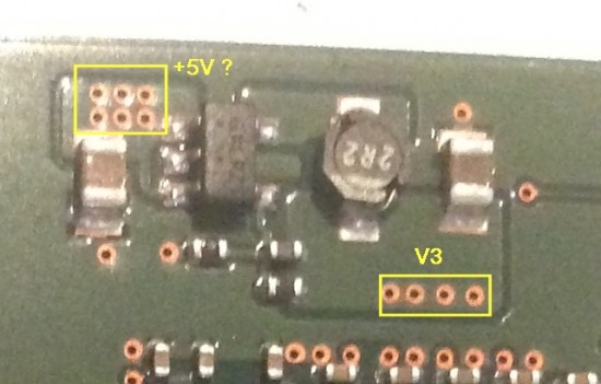

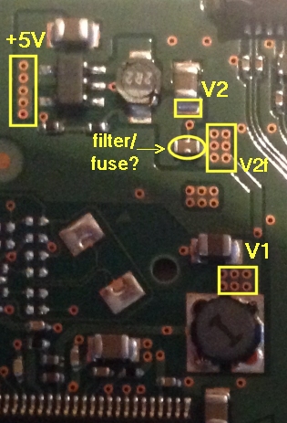

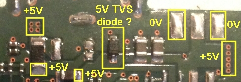

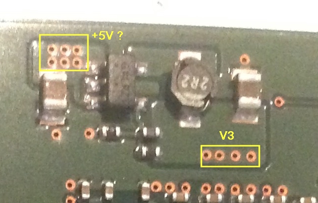

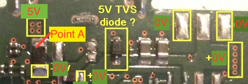

I have attached my best guess as to the voltage test points.
ISTR that one person had some trouble with a part that I have identified as "filter/fuse". He was getting a voltage at V2 but nothing at V2f.

Thanks a lot for your images,
I have tested the points and they are all 0V except for the 5V_filtered_TVS image which has the one 5V point(which I have marked) and the rest were 0V.
What I did notice however, is my multimeter slipped (whoops!) from Point A I labelled in the picture onto the 5V pads, which caused the blue LED on the board to shine brightly again, I do not have the drive connected to the board at this point however (as I was testing both sides), so I am unsure if it would spin up, or cause damage?
What do you suggest? Any Ideas?
Thanks again for your input

 Post subject: Re: Suitable donor PCB for external Samsung spinpoint drive
PostPosted: July 21st, 2015, 10:21
Posts: 17316
Measure the resistance of the TVS diode on the 200 ohms range. By the sounds of it, it will probably be OK.
Next measure the resistance between the 5V point at the top left and the first 5V test point below it. I expect that it will be open circuit. If so, then reflow the solder pads on each side of the black component. Your misadventure with the multimeter probe suggests that there may be a dry solder joint at point A.
PostPosted: July 21st, 2015, 18:31
Joined: July 16th, 2015, 21:10
Posts: 5
Thanks a lot for your advice and time my friend, I reflowed the solder joints and the drive came back to life! Excellent! Best misadventure I have had!
