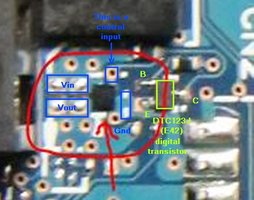

Hi all, my MD04 was damaged accidently by using an incorrect power module cable. A small black square boom...
As show in the picture, anyone could tell me what is this? Mark on it is "63AN 78", hope I can fix it. An Inductor I guess?
Thanks in advance.

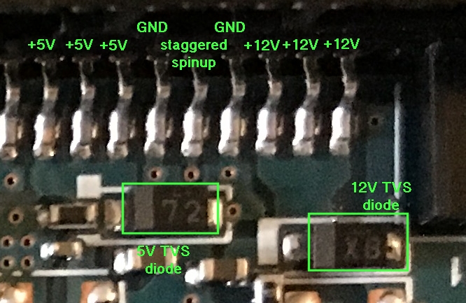

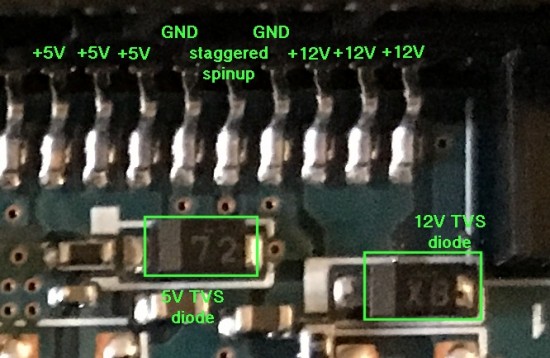

Did you check the TVS diodes? One or both will probably be shorted. This will tell us whether the damage was done via the +5V or +12V input or both.
As for the mystery component, it appears to have 4 pins, one of which is switched by the adjacent transistor (?). I'm guessing that the component is a power switch. It would help if you could identify the 3 pins with the heavier traces - Ground, +5V or +12V, Vout?

The part which I thought was a 5V TVS diode (marking "72") appears to be an ordinary 20V, 1A Schottky barrier diode. Therefore, it provides no overvoltage protection. The "XB" part appears to be a 15V, 1W zener diode, not a TVS diode.
RB160M-20, ROHM, 20V, 1A, Schottky barrier diode, marking 72, SOD-123/1206:
http://www.smdmark.com/en-US/smd-model-RB160M.html
http://docs-asia.electrocomponents.com/webdocs/13e4/0900766b813e45a3.pdf (RB160M-30, marking 73)
http://rohmfs.rohm.com/en/products/databook/datasheet-nrnd/discrete/diode/schottky_barrier/rb160m-40.pdf (RB160M-40, marking 74)
https://www.buerklin.com/medias/sys_master/download/download/h72/h2d/8891259879454/technical-data-sheet-rohm-semiconductor-rb160m-60tr-en-20160314.pdf (RB160M-60, marking 76)
KDZTF-15B, Rohm, 15V, 1W Zener diode, marking XB:
http://rohmfs.rohm.com/en/products/databook/datasheet-nrnd/discrete/diode/zener/kdztftr9.1b-e.pdf

The "small black square" looks like a power switch or maybe an LDO regulator. Its "control" pin is most likely an Enable input. This pin is driven by the digital transistor, which in turn would be switched by digital logic, possibly the MCU.
DTC123J, Rohm, NPN digital transistor, 50V, 100mA, marking E42:
http://www.rohm.com/web/global/datasheet/DTC123JEB/dtc123jebtl-e

The mystery IC is a TPS22912C.
TPS22912C, Texas Instruments, Ultra-small, Low On Resistance Load Switch With Controlled Turn-on, Vin = 1.4V - 5.5V, 2A, 60mohm ON-resistance, marking 78:
http://www.ti.com/lit/ds/symlink/tps22913.pdf
More info in the following thread:
viewtopic.php?f=1&t=36343

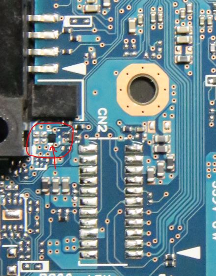

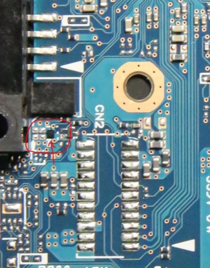

Full sized photo:
http://forum.hddguru.com/download/file.php?id=16457&mode=view
Other ICs:
TPS27081ADDCR, Texas Instruments, PFET High Side Load Switch w/ Level Shift & Adj Slew Rate Control, 1.2V - 8V, 3A, marking AUA, DFN6:
http://www.ti.com/lit/ds/symlink/tps27081a.pdf
BD91364BMUU, Rohm, 2.9V - 5.5V, 5A, Integrated MOSFET Buck Converter, QFN-20:
http://www.rohm.com/web/global/datasheet/BD91364BMUU/bd91364bmuu-e

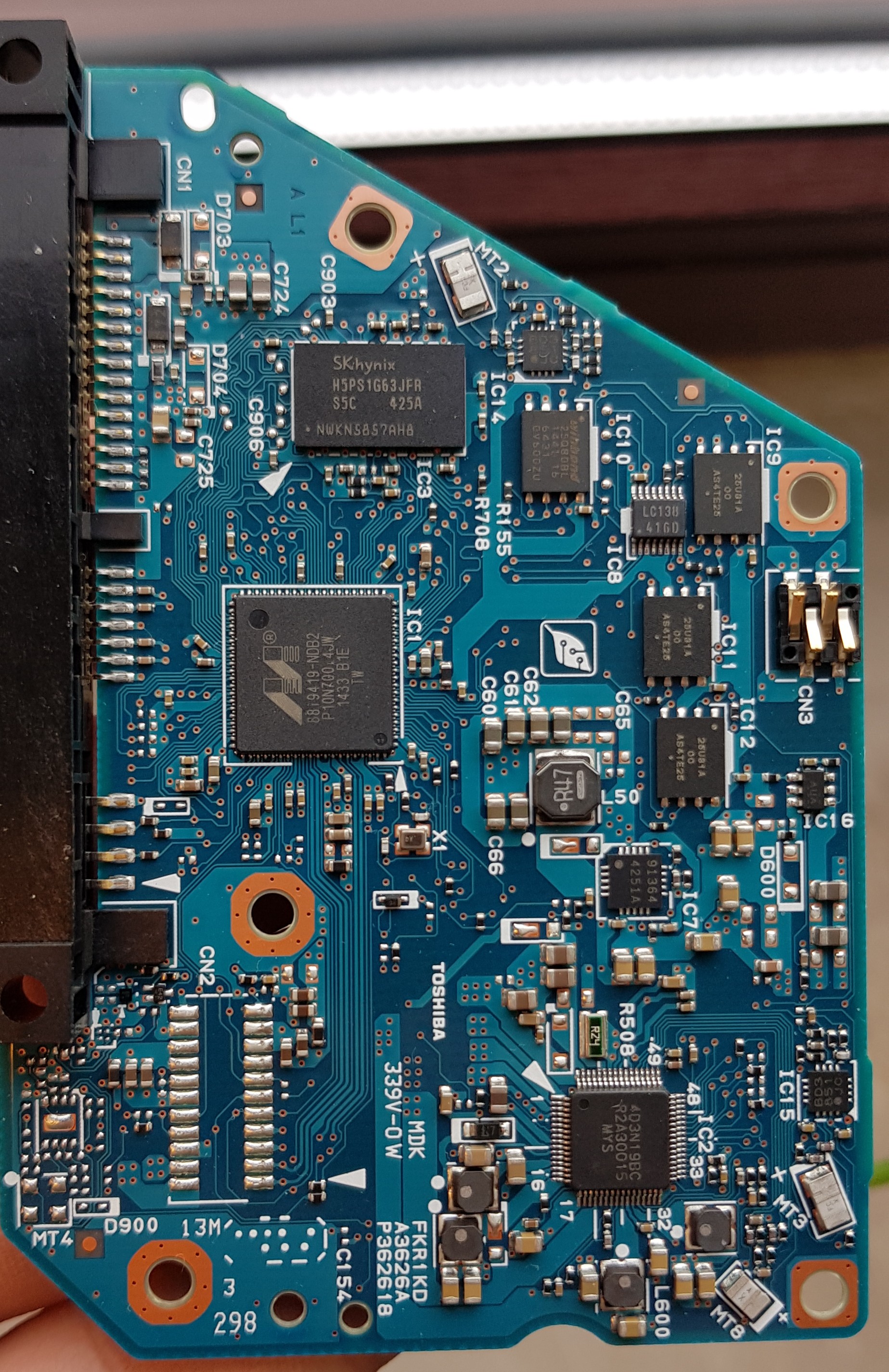

 Post subject: Re: 3.5" Toshiba's
PostPosted: November 23rd, 2019, 14:16
Joined: November 23rd, 2019, 13:54
Location: Deutschland

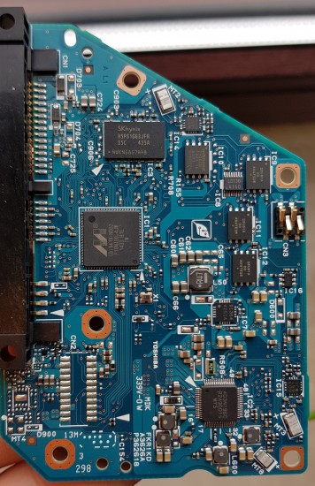

Hello everybody :D ,
I wanted to warm up this old thread, because I have a similiar problem with the same Toshiba model (MD04ACA400).
I mistakenly used a 19V laptop charger to power up my external hard drive. Now it doesn't power up, nor makes any noise or spins. Unfortunately I have only this HDD and not a working duplicate, where I could compare the measurements.
I measured the diodes D703 and D704 with the following results:
  • D703:
    Multimeter shows continuity by beeping (tested both directions). R = 0 ohm. Maybe it's shorted?
  • D704:
    Diode test shows 091 in one direction and 1255 in the other. Measurement with resistor mode (with setting 20k) shows R= 6.02 and 0.530
A picture of the PCB is attached for for completeness. I would really appreciate, if you have any hints/tips/solutions, what I can try to fix this.
If you need more information, just let me know!
Best regards,
trasher
PostPosted: November 23rd, 2019, 14:31
Posts: 17314
Remove D703. Hopefully that's the only problem.
Measure the resistance between the diode's pads in-circuit. Also test the fuse ("4").
If you want to minimise your risks, replace the PCB and transfer the serial flash memories. Be careful, as you must not damage them.
