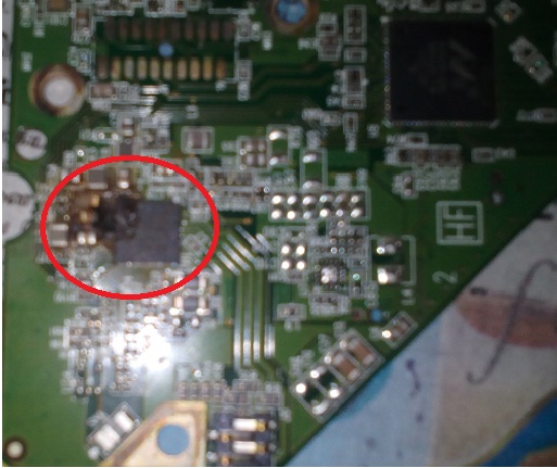

Can I use Donor 2060-771945-002 REV A for the burned pcb patient 2060-771945-001 REV P1
By Transferring ROM Chip? both pcbs are from WD20EZRX HDD

When i tried it just spin up then spin down not detected.
Please any suggestion?

what was the issue with the original board?

File comment: Burned PCB

It may or may not work. I'd look at the main controller chip to see if it's the same. It all really depends on what was revised, if it's just a different brand of RAM or slightly different motor control chip, it'll probably still work.

Most probably preamp is dead. If you are lucky, the fw checked preamp id before moving heads and decided not to move it.
If you are less lucky, it moved heads and rearranged the data a bit.
see viewtopic.php?t=31493&f=1&start=0#p219267

For once, I have to say I totally agree with Fzabkar... Even if the preamp is damaged from the surge that blew the PCB, it's very unlikely that it'll damage the platters. Unless the data on there is literally going to cost you your life to lose it, I'd say go ahead with replacing the PCB. If it did damage in such a way that it's going to damage the platters, chances are the damage is already done regardless.
it depends on wether the drive was working at the moment of the surge. If it was powered off, the data is safe until u power ir up with the bad preamp.
If it was working, it might have caused some damage, like 1-2 sweeps, but the more u play with it, the more damaged it will be.

Actually, I agree with pepe on one point. If you can test the preamp, then do it. I would, but that's because I always attempt to determine the full nature of the problem in order to select the most appropriate solution. I would hate to burn a replacement PCB because I neglected to at least test for shorts on the +5V and -5V supply rails. That would require less than a minute of my time. In fact there are plenty of threads where I have demonstrated how to do this.
My primary issue with his statements is that they imply that end users should not attempt DIY recovery, but should send their drives to professionals, presumably because professionals would perform the required testing. Clearly, this is not true, and the user would be essentially no better off.
