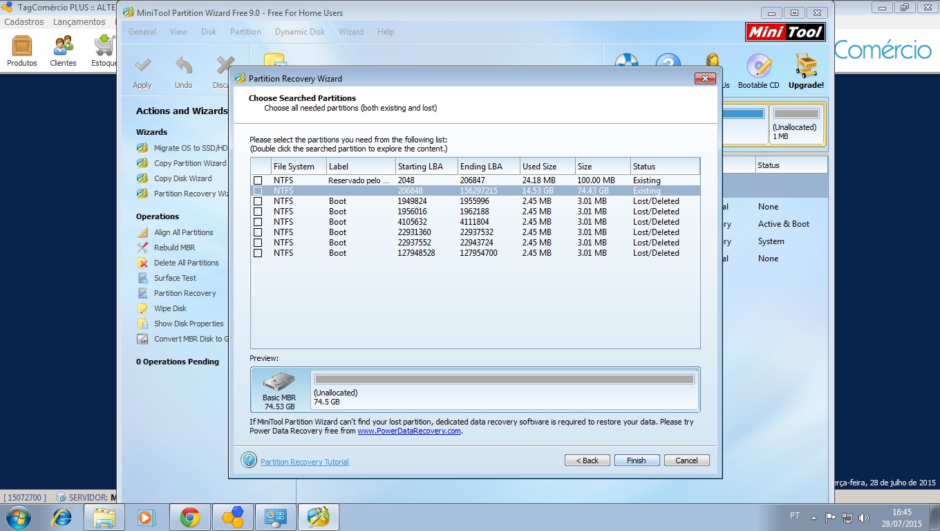

Hi. At first, I'm not an English native speaker, so Im sorry If I commit any English mistakes. Right, My 500gb Hd is missing one big partition, and It is only showing 75gb:
1) Its not in the disk management of windows, as some tutorials suggest you as a way to fix the problem;
2) I've formatted it hoping I would find something in the advanced installation of windows, but nothing found there, only the 75gb partition...
3) Linux is not showing partition either;
4) I've installed MiniTools partition software and I perfomed a full scan of the disk. There is a printscreen attached bellow
I wonder, is the disk corrupted? Can it be fixed?
Thanks guys

 Post subject: Re: Mistery...Partition is gone with no tracks left...
PostPosted: July 29th, 2015, 13:31
Posts: 17215
The screenshot is a little confusing. If there are two partitions (100MB reserved + 74GB OS), and if these have been formatted, then why does the Preview bar say "unallocated"?
The capacity of 74.53GiB is consistent with an 80GB physical drive. Do you have any other HDDs in your machine?
If you examine this drive with CrystalDiskInfo or HDDScan, does it report the existence of a HPA? What model number does it report?
Thanks for answering fzabkar, It looks like Jermy got it all wrong, but you seemed to have got the point of what is really important here. I also realized the unallocated bar you mentioned, its like I've never had 2 partitions...there is only one Hd with 500 Gb of capacity installed through sata, minus 80G used in partition 1, which means I have a second partition of aprox. 420gb missing...WEIRD...It has never happen to me before...I read some articles about missing parts of the hard drive were the result of bad clusters, which means the Hd is close to be dead. It might be that...thats the only explanation...
As soon as I can, I will scan it with HDDScan and share the results here. Thanks...

Look for an HPA:
https://en.wikipedia.org/wiki/Host_protected_area
A screenshot of sector 0 with DMDE or some other disc editor would be helpful.
