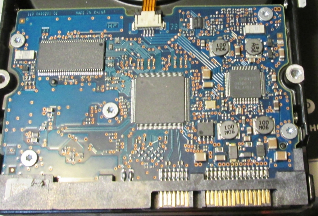

Measure the resistance of these two diodes:

The 15-pin connector is for power while the 7-pin is for data. When measuring the voltage, assuming you can get near enough with your probes, aim for the middle pin of each set of 3 pins. This will eliminate the risk of shorting adjacent, dissimilar pins.
Testing the resistance of the TVS diodes (in the absence of power) will confirm whether the drives were killed by an overvoltage.
The colour coding of the 4 wires is a worry. Yellow is normally associated with 12V while red is 5V. ISTM that the case may be applying 12V to the HDD's 5V input. That's potentially deadly for WD drives insofar as a DIY repair is concerned. But you may be lucky. It's too bad that you didn't test your Hitachi's 5V diode, as that would have confirmed any wiring error.
Could you upload some photos of the innards?
As for your question regarding DIY, yes, can sometimes remove a TVS diode and recover your drive. Otherwise you can transfer the firmware to a replacement PCB and hope that there is no other damage (such as a dead preamp).

Diode tests must be done without power. Some drives can be fixed by snipping the shorted diode while others need just a little bit of extra work, all within your capabilities, depending on the extent of the damage. We need to see photos to be certain.
In the case of your WD drives, measure resistors R63 and R67, and diodes D4 and D3. See the photo in the following article:

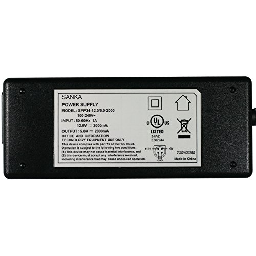

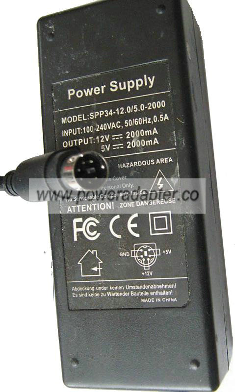

 Post subject: Re: Can a drive case ruin a SATA hard drive?
PostPosted: July 30th, 2015, 3:55
Posts: 17215
This will really confuse you:
http://poweradapter.co/images/1/flypowe ... 0-2000.JPG
http://poweradapter.co/images/1/SPP34-12.0-5.0-2000.jpg
http://ecx.images-amazon.com/images/I/41QWk5wySfL.jpg
http://www.kelte.fr/assets/images/KY-05036S-12.jpg
I'm betting that there will be many more variations. You need to match the pinout on the adapter with the pinout on the enclosure.
