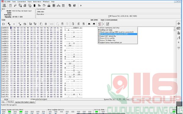

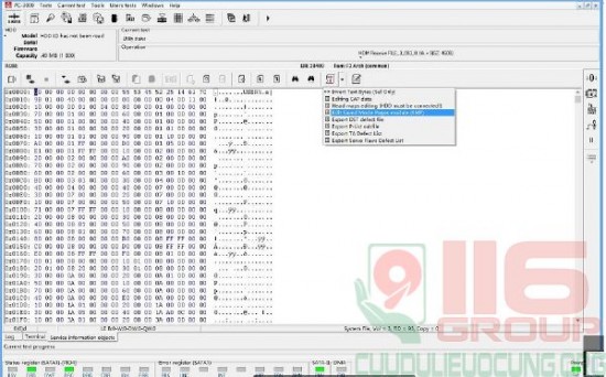

 Post subject: Fix seagate Flags proofreading PC3000
PostPosted: August 12th, 2016, 6:47
Banned User
Joined: August 12th, 2016, 4:15
Posts: 5
The following message appears terminal seagate
Boot 0x40M
Spin Up
Trans.
Spin UP
(P) SATA Reset
RAW OFF
PASS
MCMainPOR: Start:
User Data Base 0043E470
Check MCMT Version: Current
MC026: Reconstruction: Completed:
[MCMTWS] Tai/Head 0170 0172
MCMainPOR: MCTSateFlags 0000002A MCStateFlags 00405141 Tms 000000C2
SP200: MSPMainPOR Start
ProcessRWError -Read- at LBA 0000024 Sense COde=40000087
ProcessRWError -Write- at LBA 0000024 Sense COde=40000087
MSP ManinPOR: 00003000 Tms 000000C2 00000219 000002EA
MSP MainPOR Complete
6Gb Max Speed lowered to 3Gb for intel bug
Send Status: COMRESET seen
InitiateMarkPendingReallocateReauest for disc_lba: 00000145DF!
seg Read Error at LBA 00000A2EF8
skip Seqment - 0170
LED 00000BD FAddr:0000988E
Rst 0x40M

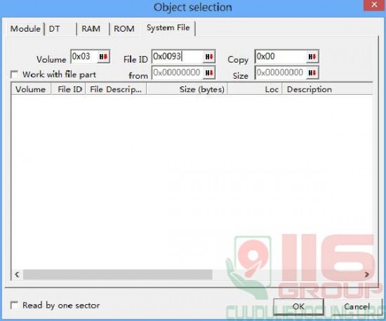

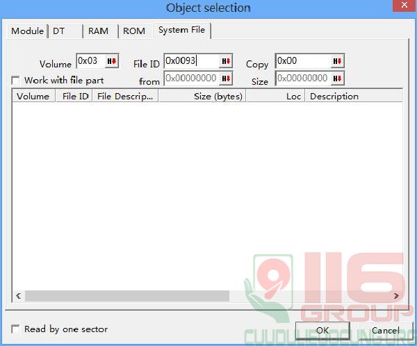

what is the number of this corrupted file?
 Post subject: Re: Fix seagate Flags proofreading PC3000
PostPosted: August 21st, 2016, 9:37
Posts: 1388
Location: isreal

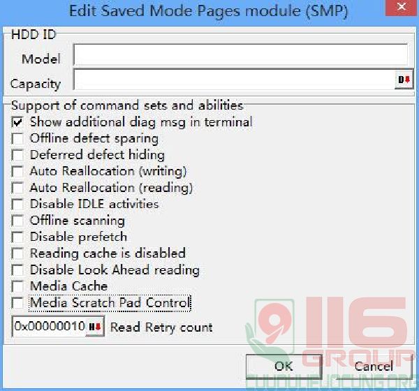

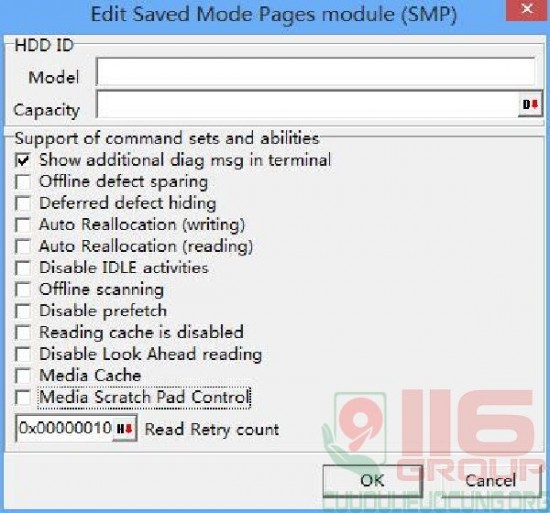

Sysfile 93 (but not in all models)
(Dilabling everything in sysfile 93 (SMP flags) doesn't mean its corrupted...)
