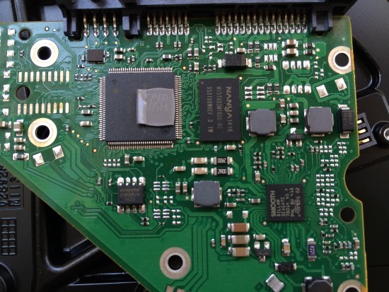

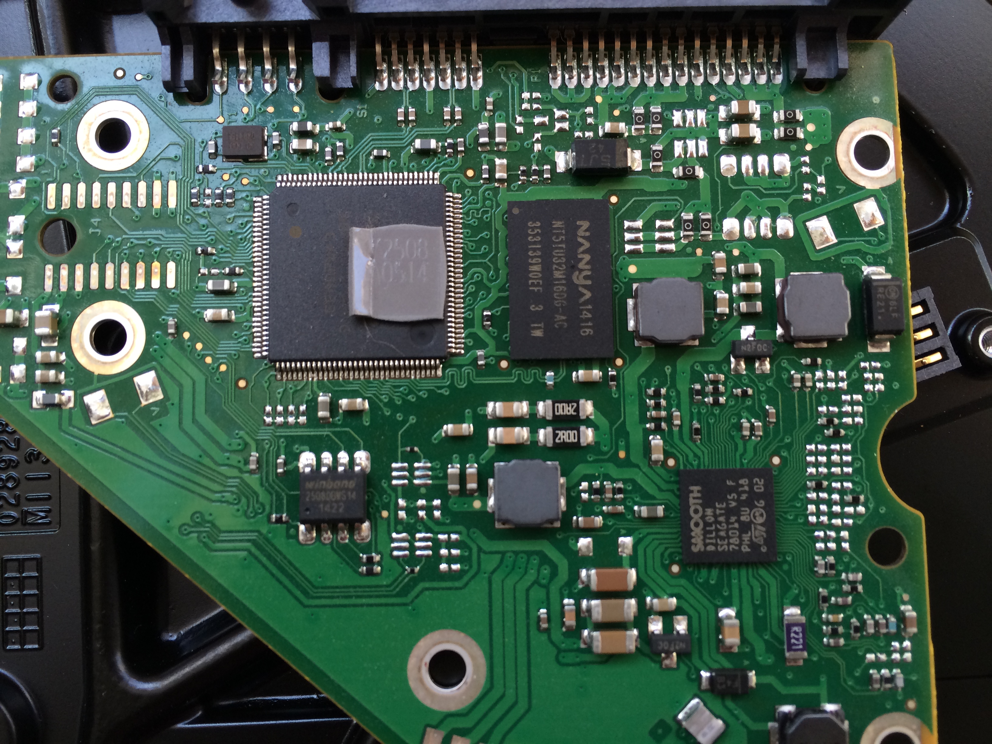

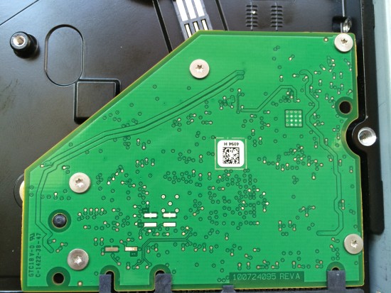

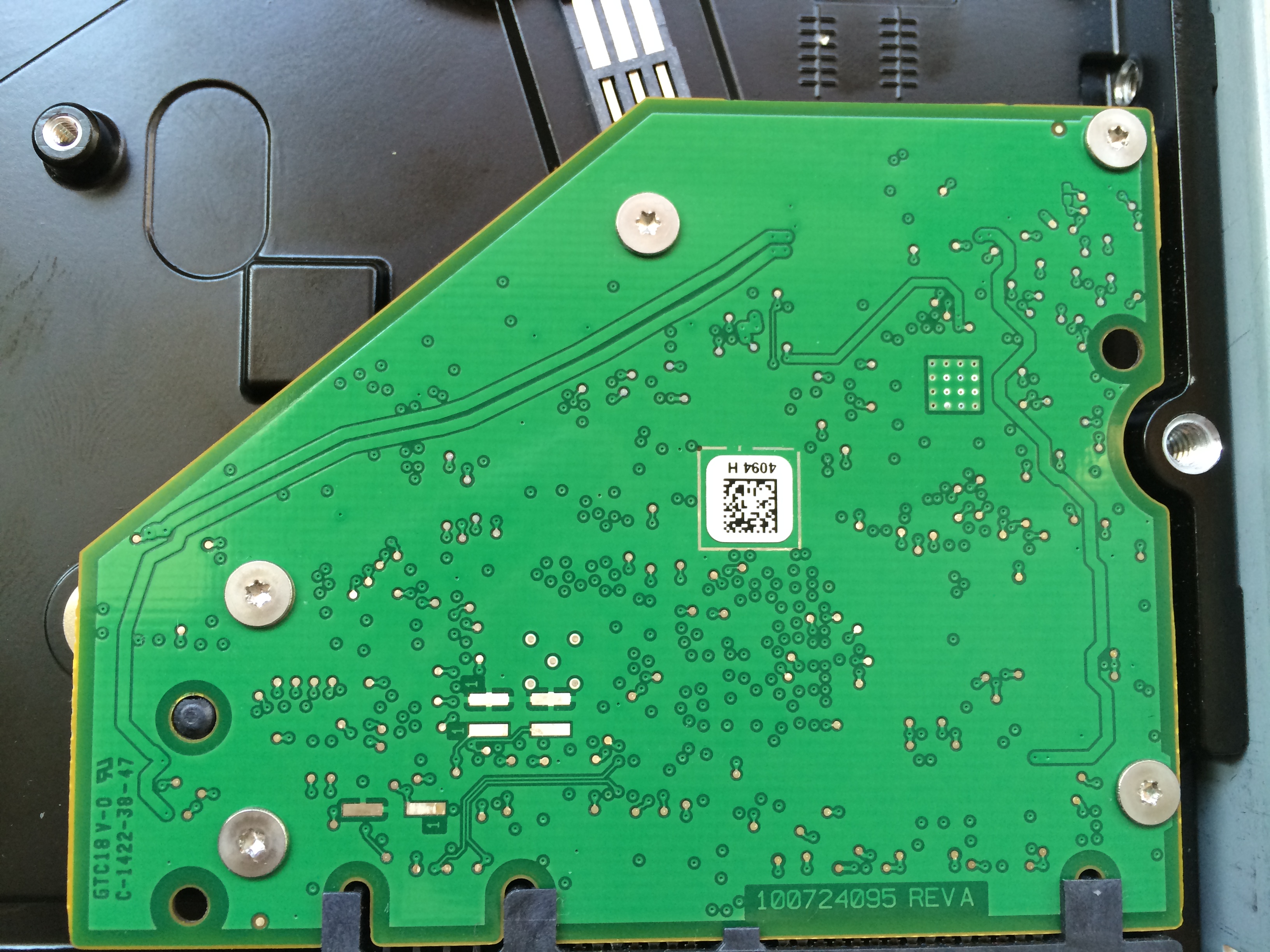

Attached are the pictures of the PCB from both sides - anyone can see anything obvious?

oooooohhhhhhh, looks like this Seagate drive uses the 3.3v rail on the sata connector and got rid of there on board regulater chips. This is the first time I've seen this, seagate are getting lazy.
You might have a problem with the 0 ohm resisters on the 3.3v line. they could have died, they look a little damaged compared to the other. The resisters are the black objects with the o in the middle. at the top near the sata connector. If the power sorce does not have an orange cable on the sata connector or those risitors are dead then the drive will not work.
Thanks Shane - so check resistance on those? Assuming if fried they will be infinite resistance (i.e., like a fuse)? Are they easy to replace?

use a volt meter and see if you get a 3.3v measurement before and after the resisters. If you get nothing then its a simple step of snipping off the resister and replacing it with a peace of solder or wire, but you will loose that protection. Also the large black thing, a TVS Diod could be shorted if something happened. But I think it could be okay, Probably the hard drive used too many amps and wore out the resisters.

ShaneWard, I checked those 7 resistors - they all checked out OK. Anything else I can check?
SATA cable should be fine because new drive (identical - see above) works with it.

ShaneWard, OK - the first three pins have 12V - also at the end of resistors. Pins 7-8-9 have 5V which is also at the beginning of black chip (SJT42 right side) - on the left side of black thing - it shows 0.0v. Does is mean anything? Any other places I should check?

OK - the Black chip may be false flag - I checked on the good board on the new disk - even there it shows 0.0V - so maybe it is supposed to be 0.0v (maybe when drive is not connected). Anything else to check?

Do you get a 3.3V reading for any other reisster connected to the Sata cable, near the Orange cable?

@quasimatter, ISTM that the onboard power supplies are probably OK (because the drive communicates with BIOS), but it wouldn't hurt to measure the voltages between ground and each of the 4 coils. Also measure the voltages at each of the 2 adjacent diodes (black things). One will be the negative supply for the preamp.
