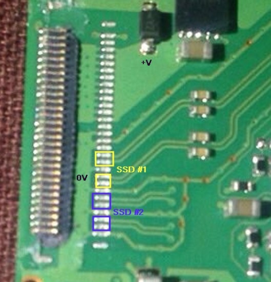

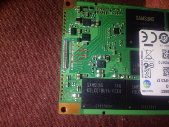

 Post subject: sony svs13a1v8r died ssd 128gb
PostPosted: August 1st, 2015, 17:06
Joined: August 1st, 2015, 16:49
Location: Ukraine
hi, I apologize for my poor English. the problem is this - the laptop sony svs13a1v8r broke the ribbon cable and then the connector. schematic of the plume. can be experienced?

 Post subject: Re: sony svs13a1v8r died ssd 128gb
PostPosted: August 3rd, 2015, 2:06
Posts: 17335
ISTM that there are two separate SSDs, one on each side.
PostPosted: August 3rd, 2015, 4:03
Posts: 17335
viewtopic.php?f=1&t=18418&start=60
Here is a regular single SSD using the same flash controller (S4LJ204X01):
http://www.storagereview.com/images/Sam ... CB-Top.jpg
You can see how the SATA Tx/Rx pairs are wired to a regular SATA connector.
