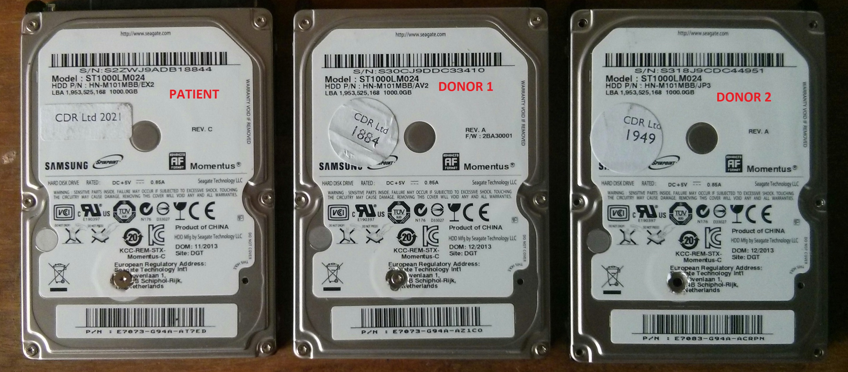

what's the full PN form patient & donor (uploading the sticker from both of them from the front, will be best) ?

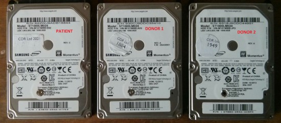

This job came in via an IT Support company, so unsure how the end user has treated the HDD. Most likely physical shock.
Please find attached an image of the patient and the two donor HDDs used.
I will try smart hotwap and see what happens.
I have this job raised with AceLabs tech, but they suggest the failure of the translator is due to incompatible heads.
John
