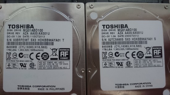

I have a problem with "new" series of Toshiba notebook drives HSA compatibility.
As i know, i have match
-model number
-drive rev number
-.....and in this case HDK number.
...but i changed HSA on drives as you see in the picture below with no success.
The donor drive (after i put back HSA) still alive
Patient drive is on the left.
What did i wrong?
The patient drive has a "kkkkkssssshhhhh-kkkkkssssshhhhh-kkkkkssssshhhhh" noise with both HSA.
Please help!

what's the initial problem ? drive has fallen ?
 Post subject: Re: Toshiba MQ series notebook drives HSA compatibility
PostPosted: August 11th, 2015, 6:06
Posts: 330
My custommer says, one day the drive was not identifiable. And the drive is not fallen.

as you describe it,
it seems to me that the HDD has fallen, so it can be the spindle or platters are not aligned.
can you upload an audio of the noise ?

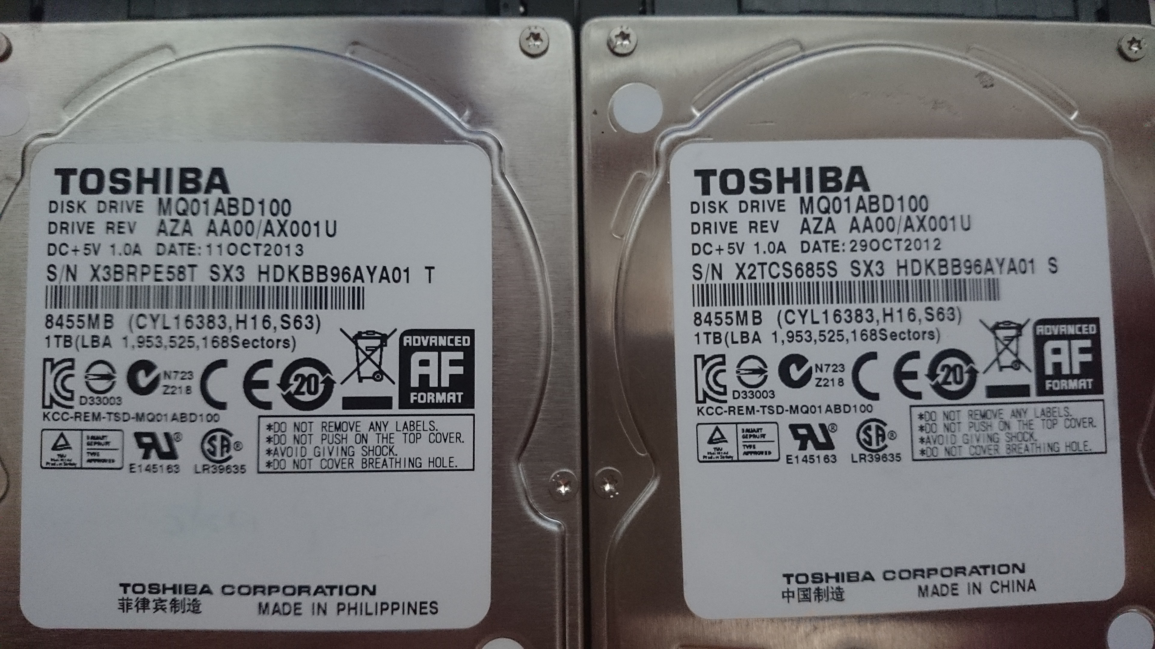

PostPosted: August 11th, 2015, 6:46
Joined: June 30th, 2008, 5:40
Posts: 64
country of product is not matching
PostPosted: August 11th, 2015, 6:56
Posts: 1388
Location: isreal
it sounds exactly like i thought, and i think the drive has fallen, if so, there's a chance of media damage.
have you inspect the platters ?
PostPosted: August 11th, 2015, 7:01
Posts: 330
Thank you ibcho!
So you think the country is matters?
PostPosted: August 11th, 2015, 7:32
Posts: 64
of course it matters, you need to match the origin of the country and also next to part number you see the letters T and S
as far as I am concerned, they need to matched as well
