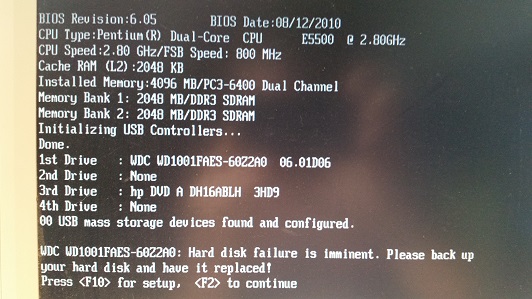

 Post subject: BIOS claims imminent failure but drive seems fine
PostPosted: August 15th, 2015, 14:41
Posts: 992
Drive: WDC WD1001FAES-60Z2A0

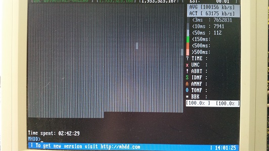

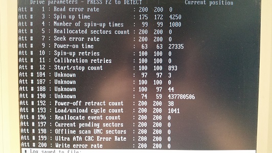

The BIOS claims hard drive failure is imminent. I made a perfect image using ddrescue with no errors. A scan with MHDD showed no issues. To me the smart data does not show any media errors. Smart data from HDDSuperTool is below, and screenshots of BIOS message, MHDD smart data, and MHDD scan are attached. I need an opinion on what is going on here. Is there something in the smart data that indicates failure? Or is it possible that the BIOS on this computer is corrupt?

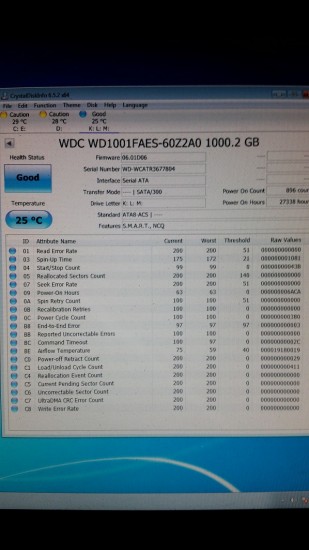

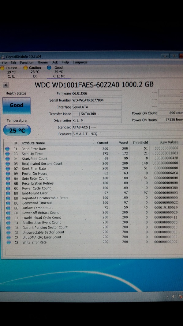

I HATE having to plug a drive into Windows. But since this is already recovered 100% and just needs to be assessed, I did it. Screenshot from CrystalDiskInfo attached. As you can see, it reports as good.

BIOS is complaining because the End-To-End Error attribute has hit the threshold value of 97, as reported by CDI. However, the Super Tool has a bug in displaying these same SMART thresholds. Also the software is displaying two raw values instead of one, and "attribute" is incorrectly spelt as "attrubite".
If I am reading it right, there have been 3 End-To-End Errors and 44 Command Timeouts. I have looked up the End-To-End Error and also the Command Timeout, and between the two I am unsure if the issue is the drive, or some other physical hardware issue. The computer's owner mentioned that the issue seemed to happen after a lightning storm. Knowing this, would it be a good recommendation for them to buy a whole new computer?
