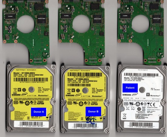

Hello everyone.
I have 3 HDD Samsung 2.5" (one patient and two donors) all are model: ST1000LM024 f/w 2BA300001 PCB 100 720 903 04 main chip: 88i9422 NDB2-chip engine: TLS 2605
It turns out that the motor rotates each one only with its own PCB, if I change the plates (PCB) in any configuration the engine does not turn. Has anyone else seen this and know why this happens? Thank you!

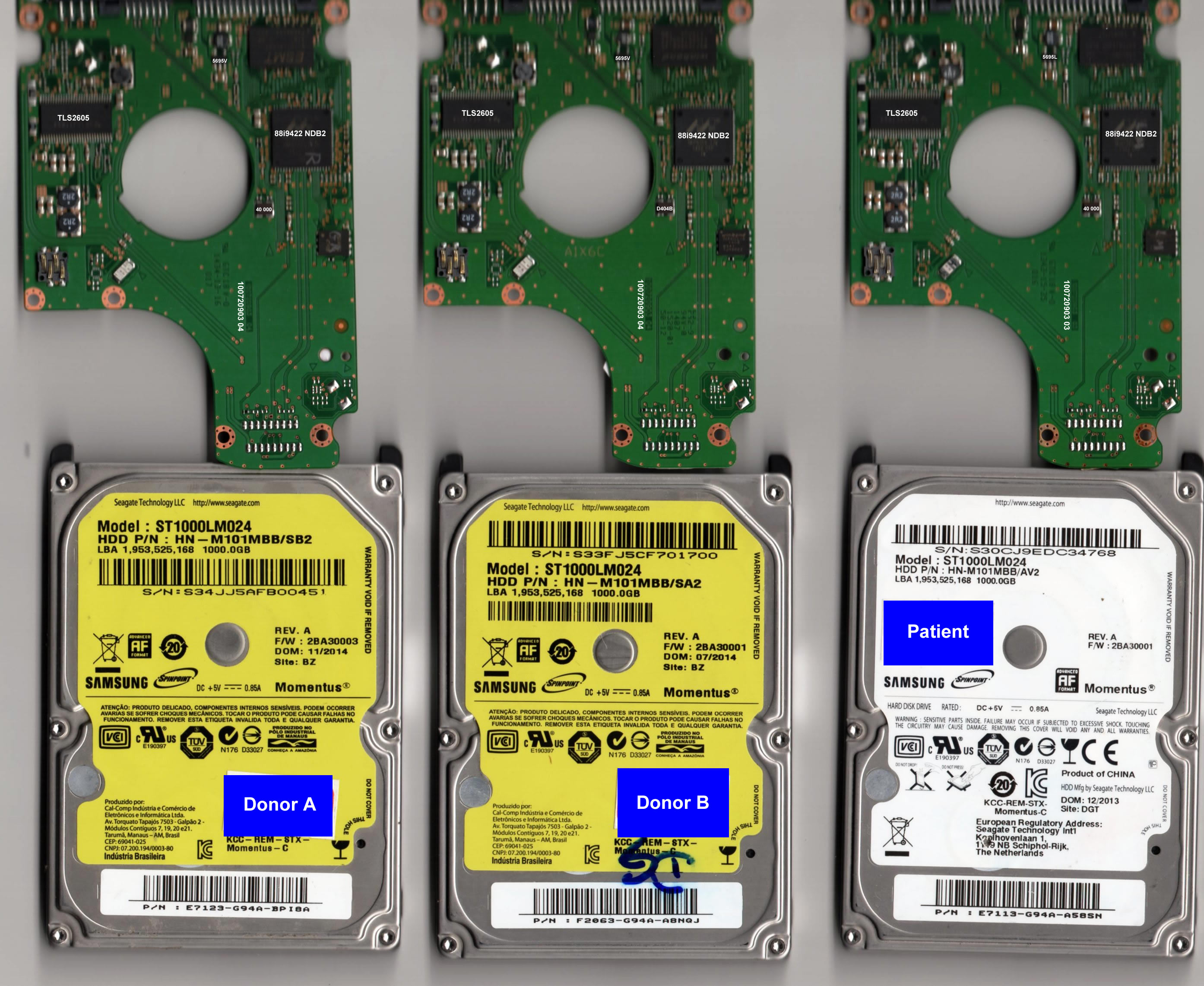

The HD patient is head banging, and I need to change the complete actuator, but what makes me curious to know that the motor does not rotate when I change the plates even having changed ROM between the plates.
truth table:
PCB DONOR A X HDD DONOR A = turing motor on
PCB DONOR B X HDD DONOR B = turing motor on
PCB PATIENT X HDD PATIENT = turing motor on
PCB DONOR A X HDD DONOR B = turing motor off
PCB DONOR B X HDD DONOR A = turing motor off
PCB DONOR B X HDD PATIENT = turing motor off
PCB DONOR A X HDD PATIENT = turing motor off
PCB PATIENT X HDD DONOR A = turing motor off
PCB PATIENT X HDD DONOR B = turing motor off

100% sure it's problems head banging. I'm very curious is because the engine does not turn I swapping the positions of PCB's?
