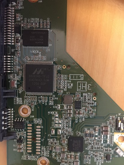

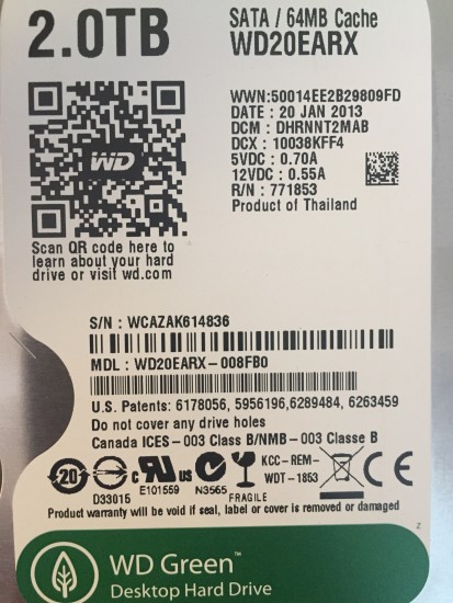

Dear experts,
WD20EARX-008FB0 - spinning up normally - not BIOS recognized
pictures attached.
Any recommendations what I can do in this case? Swap PCB? Is there a special firmware hack?
Greetings
Benjamin

99.9% not PCB.
Will almost certainly be a firmware problem requiring special (non-free) tools to fix.
Not DIY :-(

pcimage wrote:
99.9% not PCB.
Not DIY :-(
+1
if drive is spinning fine, it is very unlikely a pcb issue.

pcimage wrote:
99.9% not PCB.
Not DIY :-(
:good: +2
Could also be weak or a bad head on top of FW problem.

more then likely degrading head had overflown the Relo-List. I use PC3K to deal with this stuff, but I do recall someone had posted a link on here to a technique that could be used to clear out module 32 without specialized tools. But if the head is weak, you are not gonna get far without headmapping.
