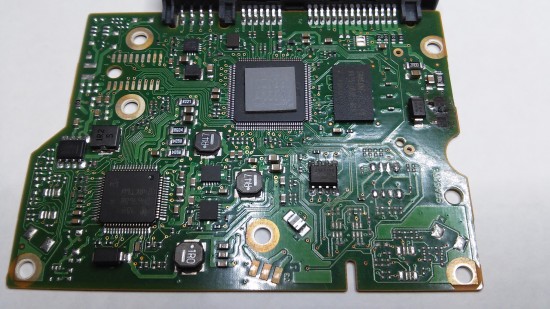

st2000DM001 initially burned PCB overvoltage . I changed to another supported eeprom pcb but does not rotate. with PCB+ROM donor, yes rotate.
I think the problem is that the EEPROM is corrupt due to overvoltage. Analyzed the first part ( 0-3FFFF ) and the second part ( 40000-7FFFF ) of eeprom (512), there are 11 differences in the head on both sides.
My question is if they are parts of the EEPROM are exact copies and that part is loaded ???
Thank you and sorry for the bad English .

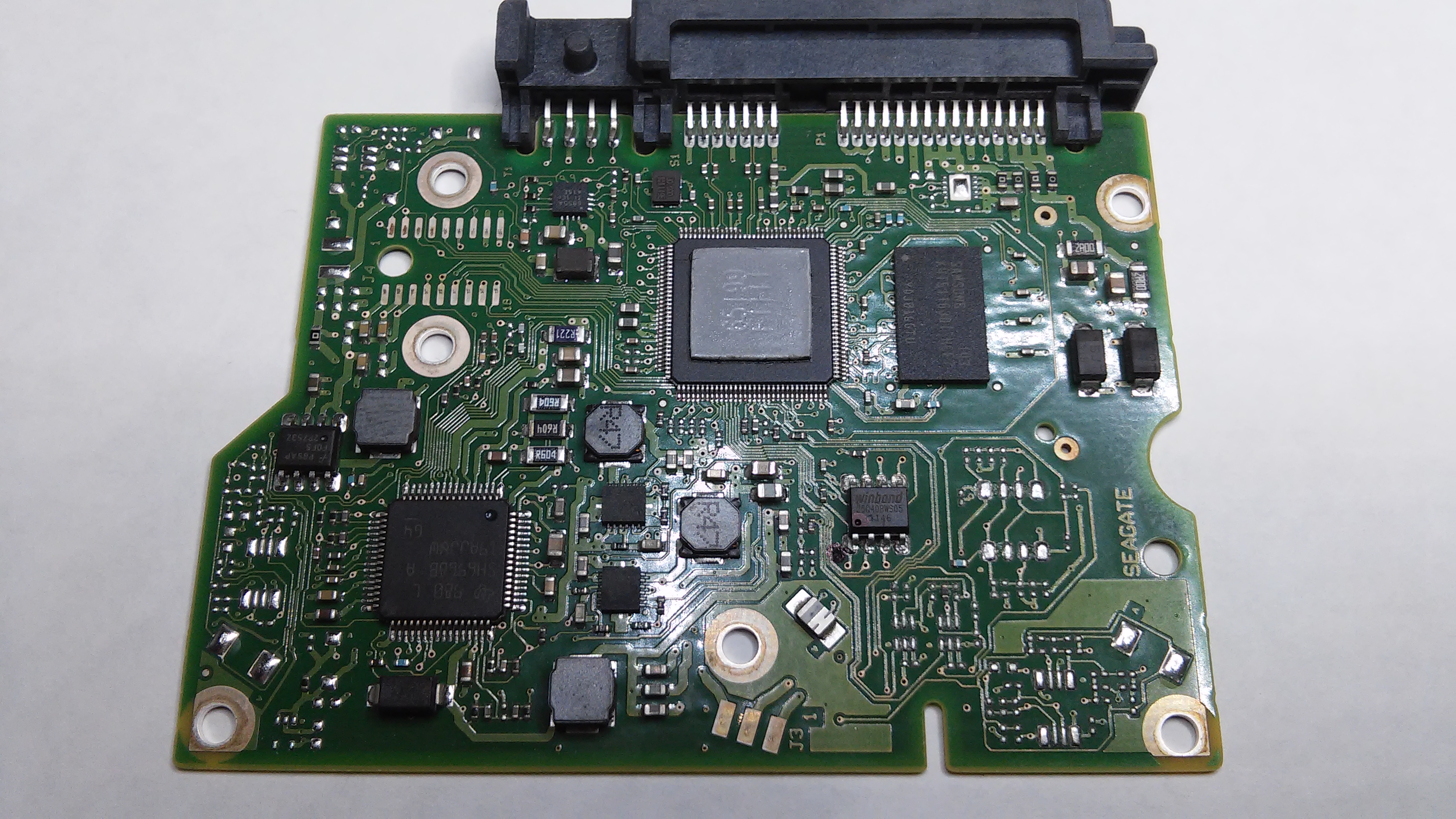

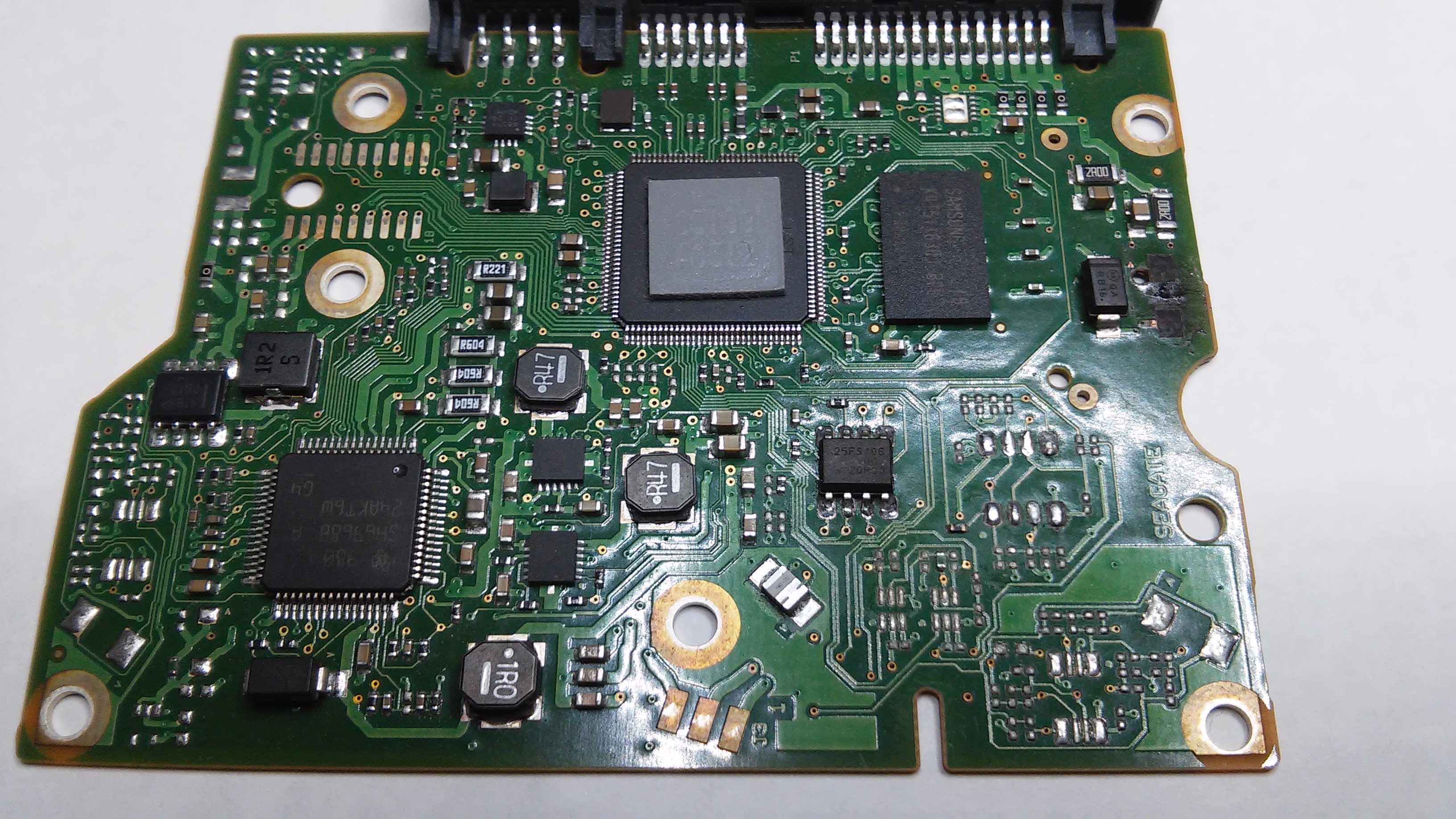

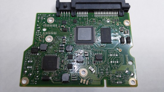

pcb terminal patient , is not working.
PCB donor + ROM patient terminal " Err flash boot code"

programmed your rom on a pcb and it started fine.
you could double check if the controllers have same type numbers (can't see them due to the heat transfer pads), and try rewriting the rom on the donor pcb (with a read back check).

 Post subject: Re: ST2000DM001 corrupt ROM
PostPosted: August 22nd, 2015, 21:30
Posts: 17326

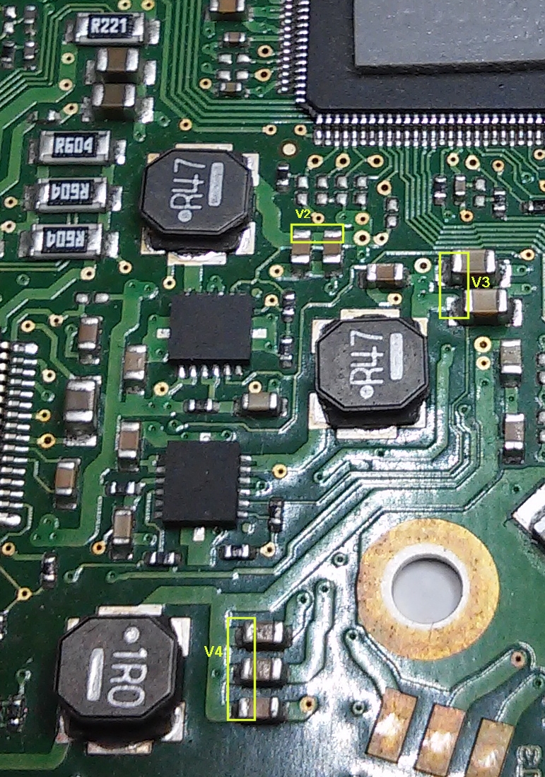

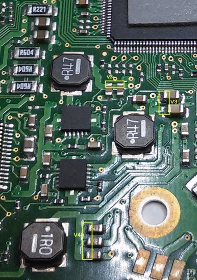

I would measure the supply voltages on the patient PCB. That will tell us something about the nature of the overvoltage event. The PCB does not need to be installed on the drive, nor does the "ROM" need to be replaced.
The R47 and 1R0 coils would be one set of voltages, while the square shaped inductor near the jumper block would be another.

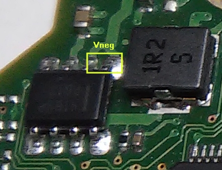

The 8-pin FETKY adjacent to the 1R2 inductor would generate the Vneg supply for the preamp. BTW, I expect that Vneg may be missing if the ROM is not installed, or if the drive does not POST.
The results could be compared against the donor PCB.

Hello fzabkar,
Donor:
V1=5,01V
V2=1,78V
V3=0,95V
V4=0,99V
Vneg= 0V
Patient:
V1=5,02V
V2=1,78V
V3=V4=Vneg=0V
I use a programmer MRT LAB, and unsolder the ROM for program (with read back to check)
Thank you

As for your voltage measurements, V2 is the 1.8V supply for the flash, SDRAM, and MCU Vio.
V3 and V4 are the two Vcore supplies for the MCU. The PWM control for V4 is generated by the motor controller whereas V3 has its own buck regulator. These missing supplies explain the absence of terminal output. As for why they are missing, it could be that their outputs are shorted by the MCU (a resistance test should verify this), or it could be that they are not being enabled by the motor controller. If the latter is the case, then perhaps the motor controller is damaged, or perhaps it is not receiving its supply voltages.
I would confirm that the two 12V zero-ohm resistors are OK:
http://www.users.on.net/~fzabkar/HDD/ST ... 01_TVS.jpg

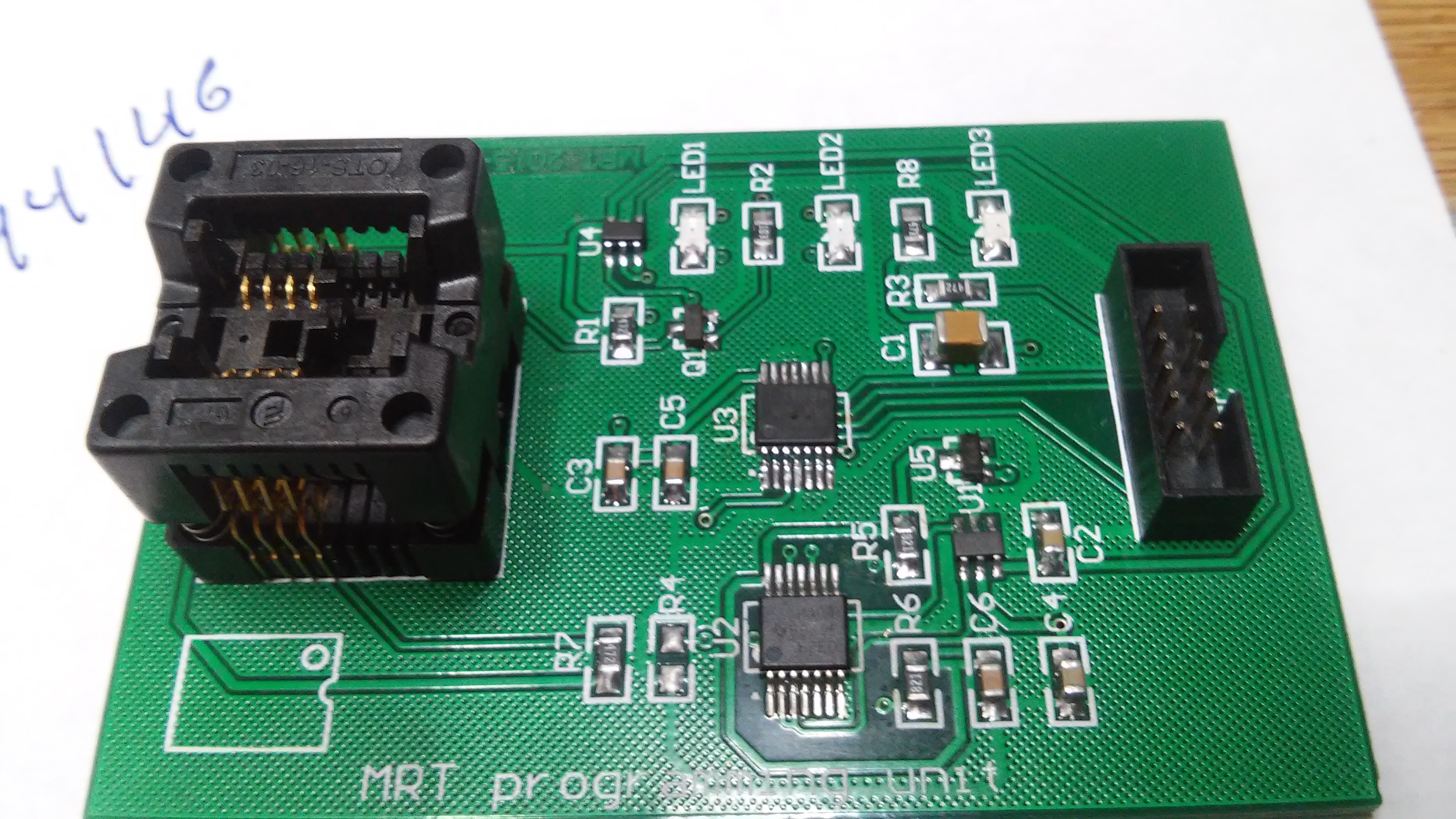

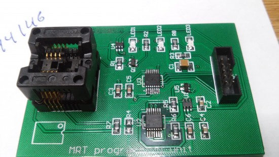

@Michael Chiklis which version of programmer you have ? I tried again a lot of cycles read/write with a W25Q40BW and everything seems ok.
Attached photo of my programmer (V2)
PostPosted: August 24th, 2015, 21:26
Posts: 17326
Version 1.0 of the programmer has an AMS1117-3.3 regulator and significantly different layout. It doesn't have the 14-pin chip at U2.
BTW, did you check the zero-ohm resistors near the 12V TVS diode?
PostPosted: August 26th, 2015, 10:27
Posts: 1768
Location: Verona, Italy
I have this:
So probably your MRT external programmer can handle 1.8V ROMs :wink:
My firmware database:
PostPosted: August 26th, 2015, 17:55
Posts: 17326
AFAICS, there is nothing in the OP's photos that would confirm that. I would measure the Vcc pin to be certain. Otherwise, if the OP could let us know the markings on the chips, then perhaps we could work it out from the circuit.
BTW, MRT Lab's web site still shows version 1.0 of their programming unit.
http://en.mrtlab.com/wp-content/uploads ... mmer-1.jpg
http://en.mrtlab.com/mrt-pro
The MRT programmer reads and programs every ROM chip that complies with the SPI interface (e.g., the motherboard BIOS chip). By using the MRT programmer, the firmware can be brushed to either failed HDD ROM chips or damaged motherboard BIOS.
