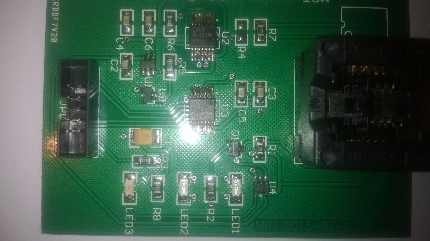

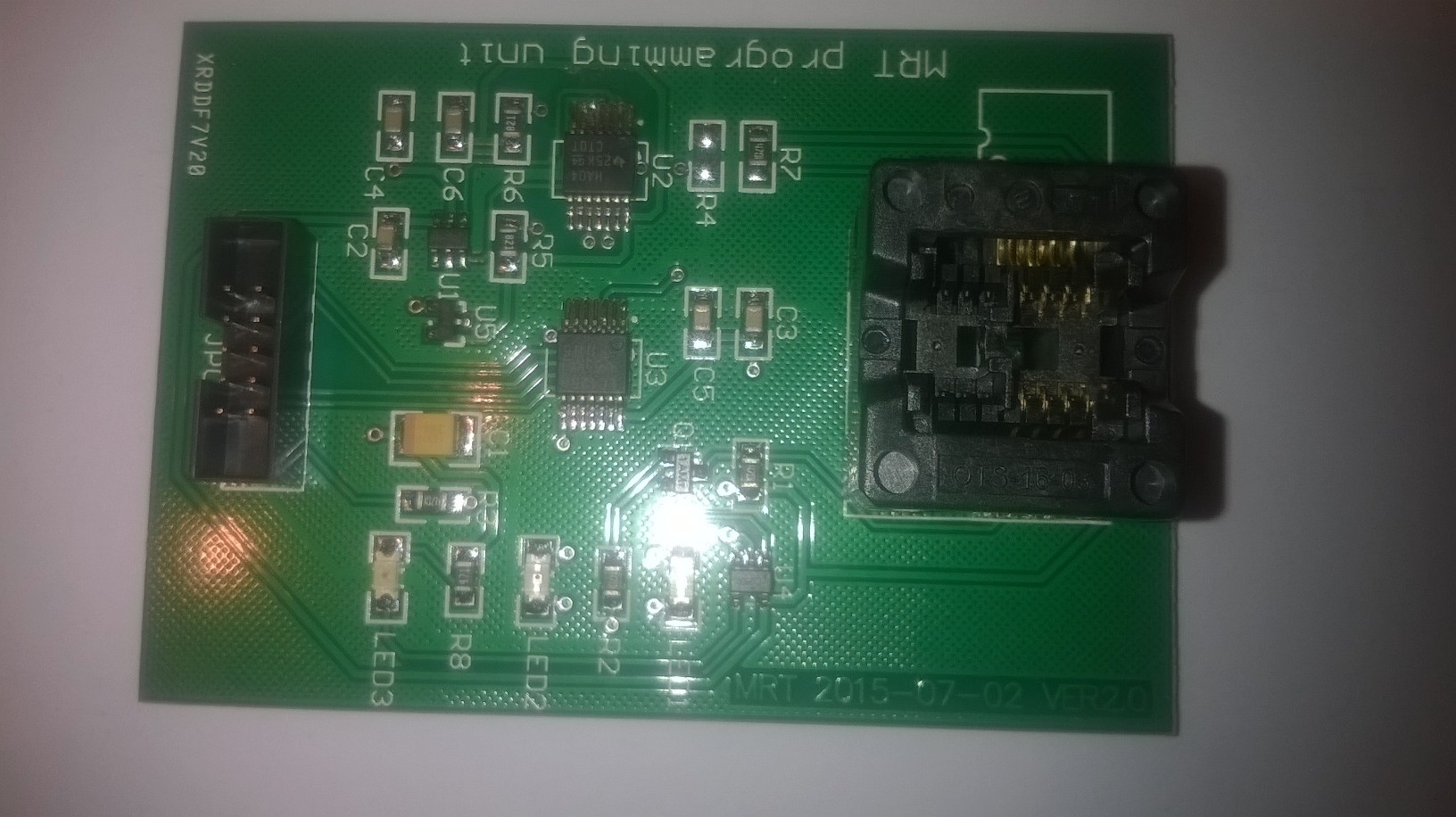

I bought external ROM programmer version 2.0, i will do some research

SN74AHC04, hex inverter, marking HA04, 2V - 5.5V supply:
http://www.ti.com/lit/ds/symlink/sn74ahc04.pdf
SN74LVC125A, Quad Bus Buffer with 3-State Outputs, marking LC125A, 1.65V - 3.6V supply, 3.3V/5V inputs:
http://www.ti.com/lit/ds/symlink/sn74lvc125a.pdf
U5 looks like a 3.3V LDO regulator.
U4 could be an LED driver.
Not sure about U1, but it may be a variable LDO regulator.
It would help to know the part markings of U1, U4, and U5.

U1: AB-TOJ
U4: C25R
U5: WV4

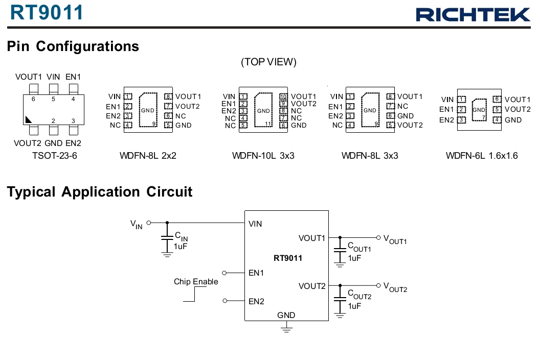

I can't find the "AB-TOJ" marking code, but ISTM that a Richtek RT9011 300mA Dual LDO Regulator could fit the bill.
The chip enables could be controlled via the hex inverter (U2) to ensure that only one supply is enabled at any time. Both supply outputs could then be safely connected together.
EN1  --| >O-- EN2
       U2
In short, ISTM that this new programming unit might be designed to accommodate two programmming voltages, probably +3.3V and +2.5V. I don't believe that the SN74 logic gates could handle +1.8V logic, though.
marking WV4 = BAT54S, SOT-23, dual Schottky diodes:
http://www.s-manuals.com/pdf/datasheet/ ... es_nxp.pdf
SN74LVC1G125, Single Bus Buffer Gate With 3-State Outputs, marking C25R, 1.65V - 5.5V supply:
http://www.ti.com/lit/ds/symlink/sn74lvc1g125.pdf

Frank, how do you find datasheets of smd components that are marked with few digits? :?
I couldn't find any datasheet of WV4 component

There are quite a few online databases and resources, eg ...
http://www.s-manuals.com/smd/wv
http://www.ti.com/general/docs/partmark ... e=partmark
BTW, could you measure the resistance between pins 1 and 6 of U1, and between these pins and pin 8 of the IC socket? This will confirm or disprove my dual supply hypothesis.

I just found a Richtek marking code resource at badcaps.net:
http://www.badcaps.net/forum/showthread.php?t=39126
http://www.rom.by/files/Richtek_Marking_Code.PDF
A marking code of "AB-" corresponds to RT9011-GSPJ6.
According to the datasheet, G = 1.8V and S = 3.3V.
