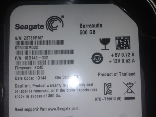

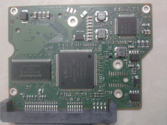

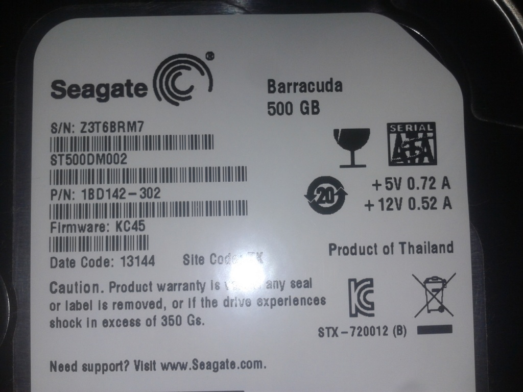

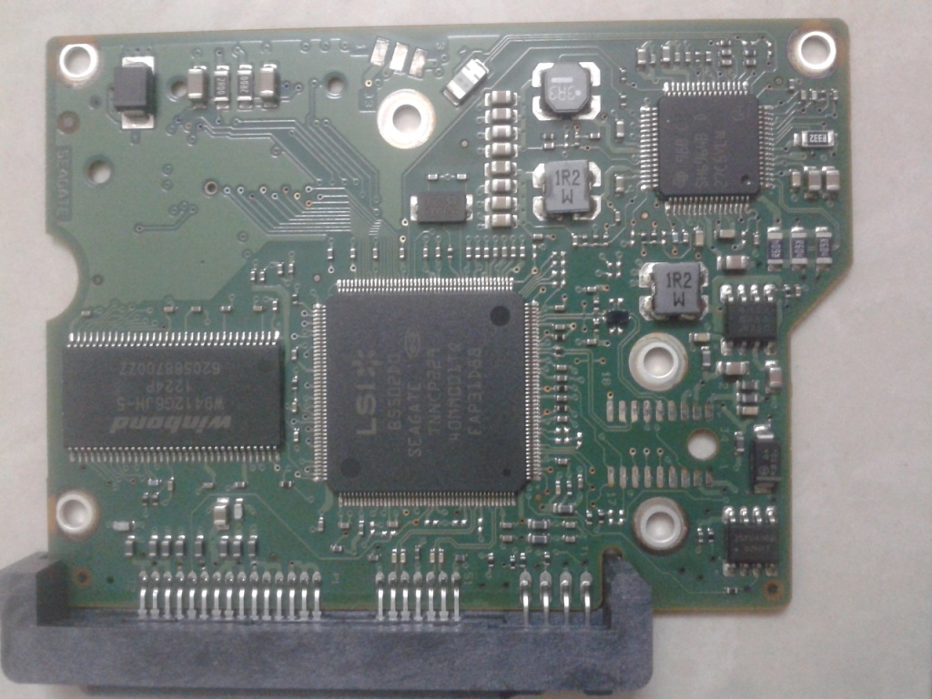

My Seagate internal HDD is not detected by bios, below is detail
ST500DM002
P/N: 1BD142-302
Firmware:KC45
data Code:13144
attached disk PCB image & HDD detail image
PLS help

is it spinning ? is it clicking/making strange noises ?
 Post subject: Re: Hi my seagate Seagate st500dm002 not detected by bios
PostPosted: July 22nd, 2015, 15:43
999 times out of 1000, you will need professional data recovery assistance. It is unlikely that you will be able to revive the drive without tools to work with the service areas. Depending on the root cause, it could be a minor recovery for less than $500.
Some clicking noise, if connected as secondary HDD, win 7 disk management shows drive 0, with 3.9GB capacity, but if i click shows disk i/o error.
Is this a problem with logic PCB board, if so where can i get this PCB?
PostPosted: July 23rd, 2015, 2:05
Extremely unlikely PCB, 99% certainly physical heads issue.
PostPosted: July 23rd, 2015, 4:32
Posts: 3550
Yep, it's heads.
