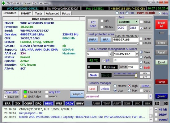

Hi have you tried Victoria for Windows? versions 4.6 and an unofficial 4.7 are available.
A nice easy to use HPA command is available.

Hi dick Thanks a ton for pointing to perfectly right tool. There are other testing features which may come handy.
No probs. I use it nearly every day!
Of course meant 4.46 and 4.47.
