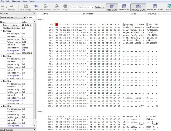

I have a 24 x RAID6 that was using a HP P800 Controller. The RAID was used as a NAS using FreeNAS. The data on the RAID is made up of iSCSI containers with WAV files as the content. As such there is no real file structure to determine drive order. Drive #1 and Drive #23 have MBR's (not bootable) which makes me think either the client mixed up the drives, or the drive order is a little unusual. I can see stripe size is 16KB from looking at some of the WAV files. As this is a HP RAID 6 I am assuming RAID type is XOR/Reed Solomon. Drive 24 is also concerning as it seems like an MBR and EFI partition which looks corrupt? I have attached a picture. I am not too familiar with Reed Solomon so not sure if that is parts of the coding.
I can play some files over 50KB so the RAID seems to be assembled correctly but they always fail after a while so I am presuming drive order is not correct. Any ideas how I can determine the drive order?

Try to assemble configuration with delay = 8 or 16 or 32. It's common for HP RAIDs.

Calculation of ReedSolomon depends on drive order. If it was "standard" RAID6, it would be possible to check drive order by checking ReedSolomon blocks. It doesn't matter what kind of data you have. If it is ZFS RAID-Z2, not "standard" RAID6, the technique will not work. If it is "simple" zfs on "standard" RAID6, the technique will work.
