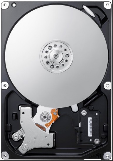

is this what it looks like?
looks like when you take the magnet off the head should swing enough? but Ive never done a head swap either! :)

Is the piece just to the north of the ribbon cable connection part of the chassis? In newer drives its parts of the connector.

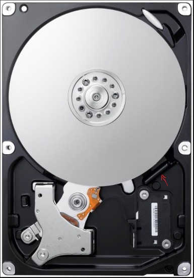

This is the design feature that motivated this post in the first place.
Checkout the small red arrow.
You can't see it but the small design feature is actually taller that the platter, it almost touches the cover and makes it impossible to just move the head from under the platter or to use any head comb that I know of. It would touch that and break.
Any help is appreciated. Maybe there is an easy way that I can't think of at the moment.

Though I have seen this type of problem in other drive models, I don't recall on this drive. So, likely I did not have the pleasure of testing on this particular model.
So, yes, head stack removal is not possible with traditional method for this model.
I suggest using the upper surface to your advantage in ensuring the platter is placed on the drive as gently as possible. Since the top surface is not used, you can dance to MC Hammer's "Can't touch this" all you want on it. So, use that to your advantage to put the platter back in place.
Additionally, to further reduce the potential impact between the platter and the head, I would recommend using a thin paper with a smooth waxy finish cut up to fit and remove properly from the disk. Lie it on top of the head, then place the platter gently in place. Then slowly and smoothly pull the paper out from between the platter and head.
