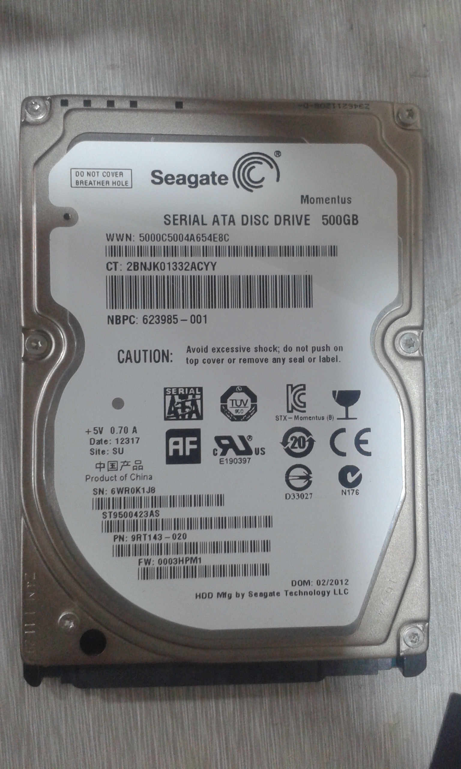

As in topic the drive came with several bad sectors for data recovery.
Start cloning the drive then starting to click, power off and power on the same ( clicking ).
Any thoughts ?
Thanks in advance.

EarlySpinup Enabled
Rst 0x10M6
that's only what I get in Terminal.
When short points get this :
EarlySpinup Enabled
Rst 0x10M
ASCII Diag mode
F3 T>
LED:00000067 FAddr:00384F72
Thanks for reply
 Post subject: Re: ST9500423AS Problem.
PostPosted: September 7th, 2015, 13:31
Heads have failed.
