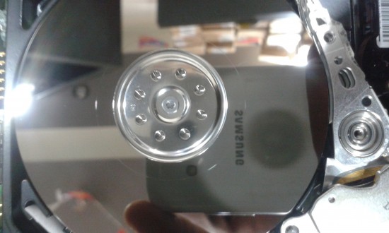

The drive not even spin up because of big scratch in the inner diameter ( close to the motor )
Is that possible to recover ?
Thanks in advance.

i would say yes, atleast partial data can be recovered if only top platter has scratch.
can you post some pictures ?

I have reasonable success with platter scratched WD drives, including this model.
Of course, it wouldn't be full recovery. :D

Here's the situation :
I can't confirm that the scratches only on the top side.
But I believe that the scratches prevent the heads to move from it's ramp.
( Tested with another donor PCB spin up but heads not move )

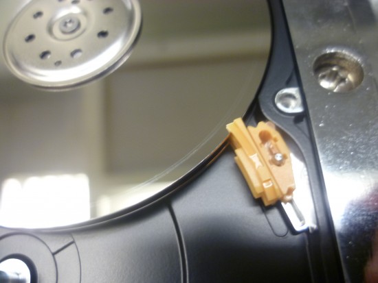

A 500Gb passport we recovered a lot of data from...
