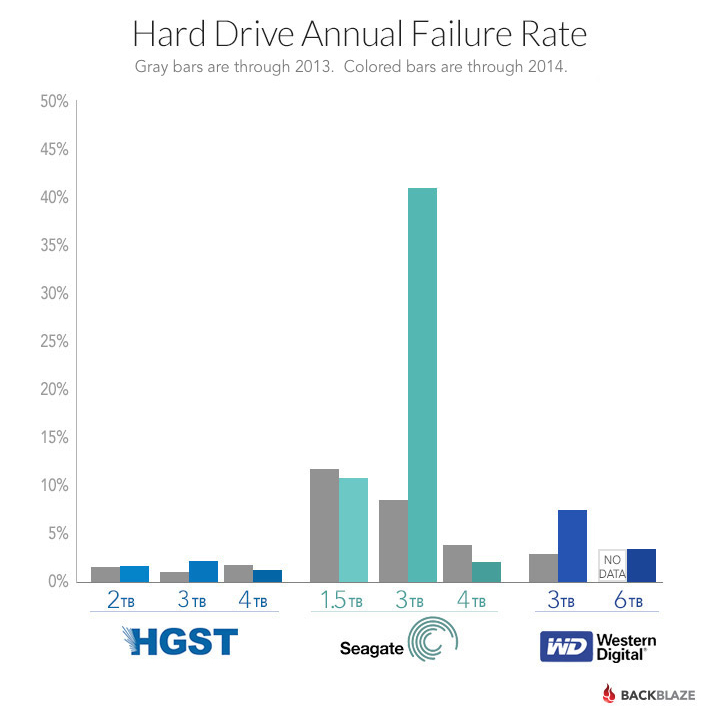

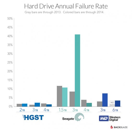

You don't want that drive to be working again...trust me :wink:
Found this report somewhere, it speaks for it self:

But I really do want it to work again, unfortunately...
Why does Seagate create these incredibly bad and unreliable drives? This is my third one, and they refuse to acknowledge when I speak to them on the phone.

the 9YNxxx series was the one affected with the high failure rates AFAIK.

Reliability of the ST3000DM001 was bad from the get-go and has gotten worse each year. The failure rate, from BackBlaze's reliability report for 2015, was 28%!

ST3000DM001 means nothing. P/N does.
