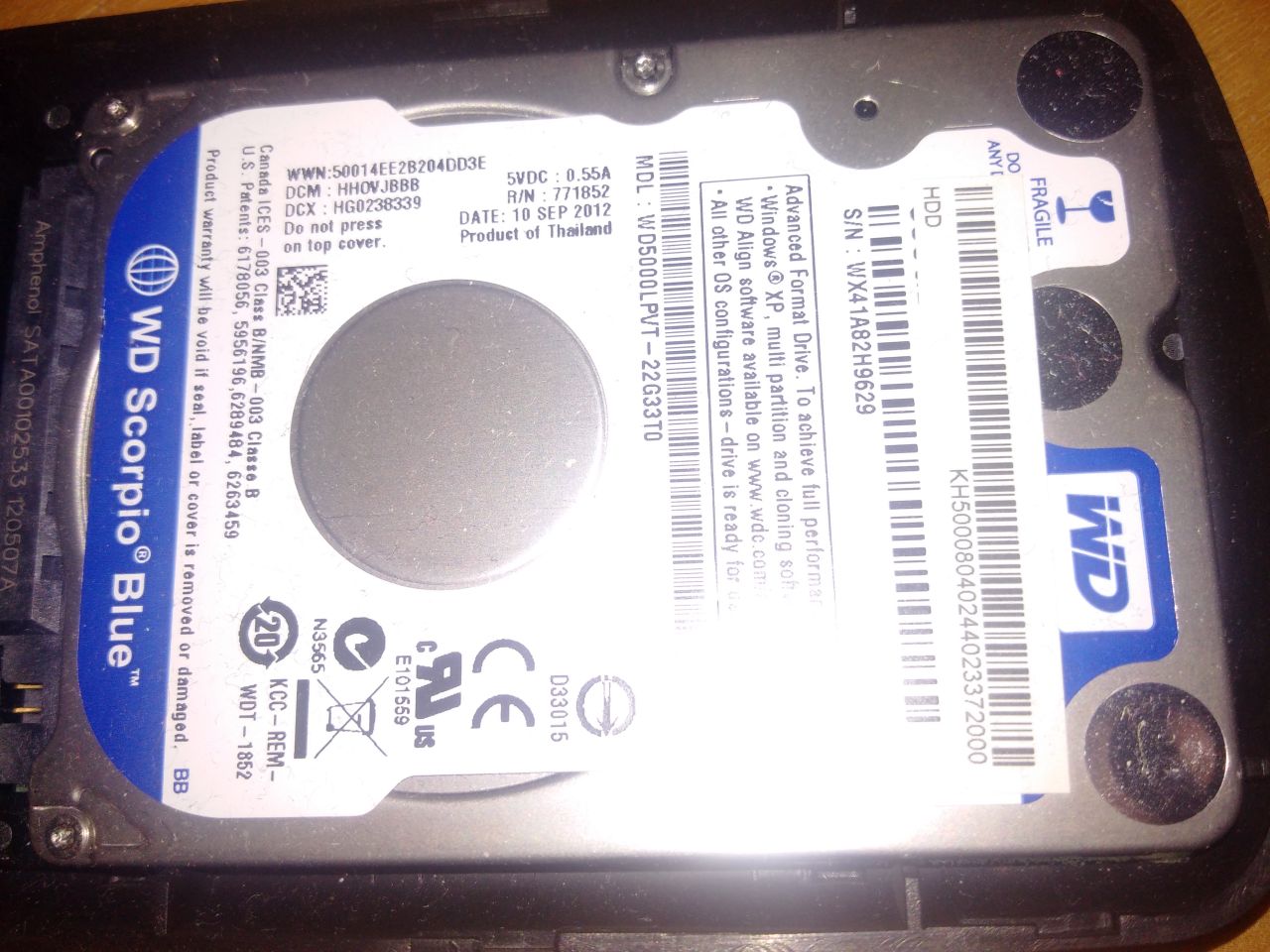

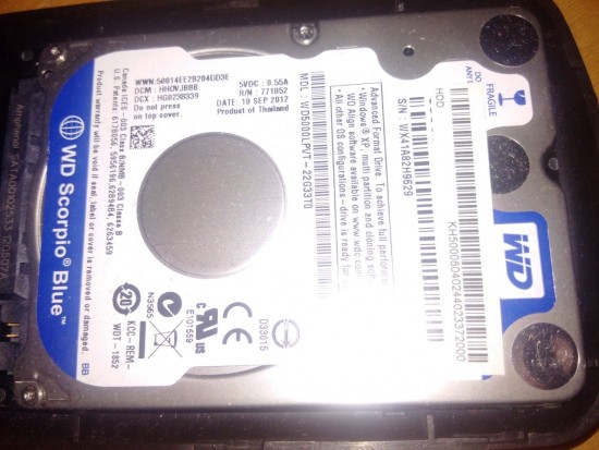

Can you hear any weird sounds in the drive, spins down etc? could you take a picture of the drive and post it?
Good idea.
It does not sound like a totaled hdd i once had, but there is a small clacking sound that repeats itself every 3 seconds which kind of sounds off.
I have added a recording as an attachment, maybe somebody with more experience can listen to it and say more?

File comment: image of the hdd

In my opinion it might be bad sectors, i can't hear anything strange.
