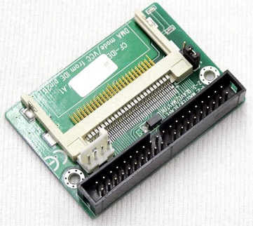

Hello all!
I'm from Brazil and I'm with a big problem.
In my job we have some old machines who run with 10Gb HDD, and don't recognize any other HDD with more than this.
What I need is a software or other way who can resize an HDD for example, an 80Gb HDD to 10Gb, but need to be physical memory only with 10Gb. We can not partition with 10Gb and don't allocate the rest of memory. This will not function correctly.
If anyone know anything who made this possible, i will be very grateful!
Thanks!

 Post subject: Re: HD Resize
PostPosted: September 17th, 2015, 15:51
Posts: 17335
... or you could use the HPA feature of HDAT2.
http://www.hdat2.com/

or get an 8GB CF Card and IDE adapter?

Solved with HDAT2.
Thanks a lot.
