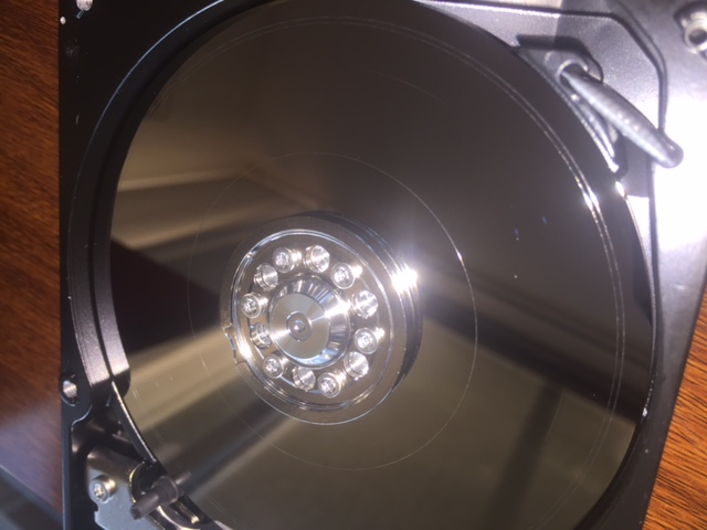

 Post subject: is this recoverable
PostPosted: September 20th, 2015, 3:35
Joined: July 29th, 2011, 4:54
Location: sydney
is this drive recoverable?
 Post subject: Re: is this recoverable
PostPosted: September 20th, 2015, 3:56
Joined: September 3rd, 2015, 21:04
Posts: 32
Location: The Internet
You didn't tell us the model drive or any details. Looks like a WD desktop of some sort. That top surface is gone but it's possible the others aren't as bad...
PostPosted: September 20th, 2015, 11:47
Location: sydney
It is WD3200AAJS-65M0A0
P/N 5188-4453
Date: 16 Sept 2009
It had a database size about 5GB that needs to be recovered if possible, and just wanted your expert opinion whether it is possible before sending the drive to DR specialist as don't want to waste time and money if this is gone.
PostPosted: September 20th, 2015, 16:31
Posts: 215
Location: Dubai U.A.E
mcjack2010 who open HDD I can see Platters have Dust so drive not opened in Clean Room it has chances of Recover if Surface 0 is Good and hopefully your Data is Located On Surface 0 but 5GB file I don't think so without trying you never know this case cost Donors not just one Good Luck ............
PostPosted: September 21st, 2015, 5:51
Joined: May 9th, 2012, 7:55
Posts: 121
Location: Western Europe
I am sorry to tell you that the DB will be lost, the stripe size between platters is small in these drives, if the other surfaces are OK, (don't take the platters out) you might be able to recover smaller files.
