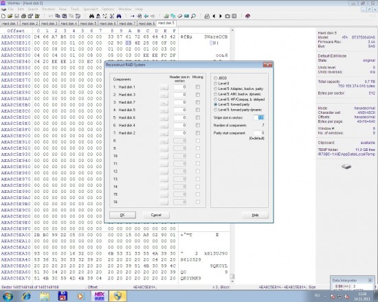

I'm currently working on a RAID 50 that used this controller which failed. I'm ordering one just so I can play with it's settings to see, but until it arrives I'm wondering if anyone can help point me in the right direction about its default stripe size, parity delay (if any), etc. It's a big array so any possibilities I can eliminate will be a big help.

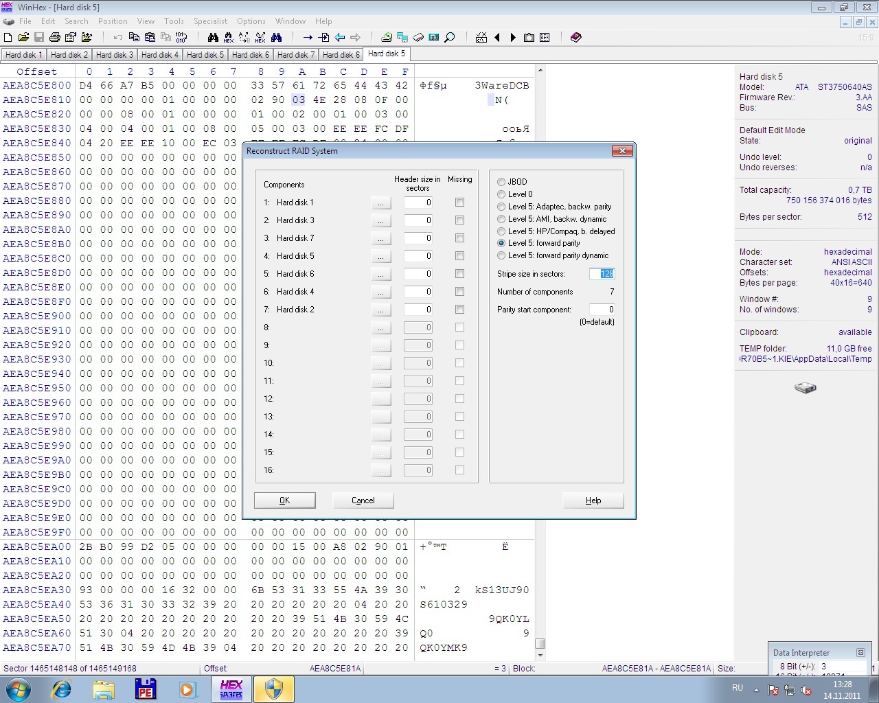

data-medics wrote:
Does anyone know if 3Ware commonly uses as parity delay at least? Trying to rebuild a 16 drive array and having quite a fun time.. :D
There is a meta data near the end where you can easy decode drive's order.

Thanks, I had actually already looked at that but the drives aren't in order as shown within the meta. That much I am sure of. Regardless, I did manage to pull it off and the data is copying out of the array now. :D
