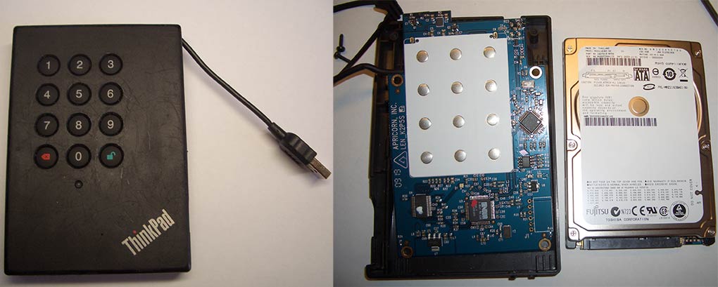

I have a problem with this drive.
"thinkpad portable secure hard drive".
Is an external 2,5 USB portable drive with a keyboard.
Inside have a Fujitsu 160GB.
Hard Disk seem to work fine but is crypted.
When I connect USB the light is red until I digit the password on keypad, so light become green but my PC still dont detect it ....like nothing connected.
Someone can give me some suggestion?

@Alkemist, if you can upload a detailed photo or scan of the PCB, I might be able to help you determine whether the USB interface is working.

could you post a clear HQ image of the PCB? not hdd pcb, the Thinkpad i mean.

Board repaired! :D
I've found a little component (inductor) with broken solders on signals line.
This one?
download/file.php?id=7547&t=1

Exactly :)
