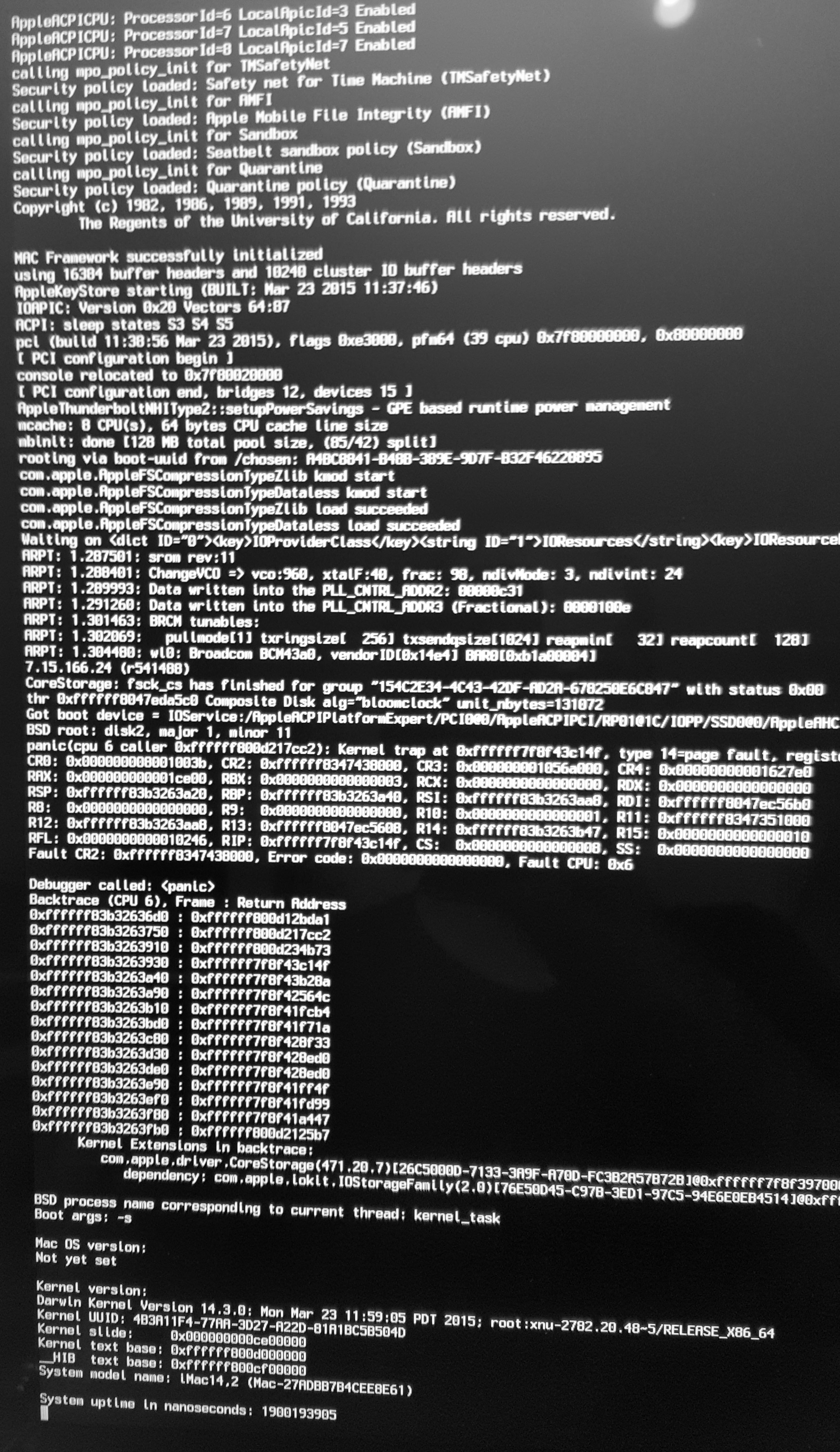

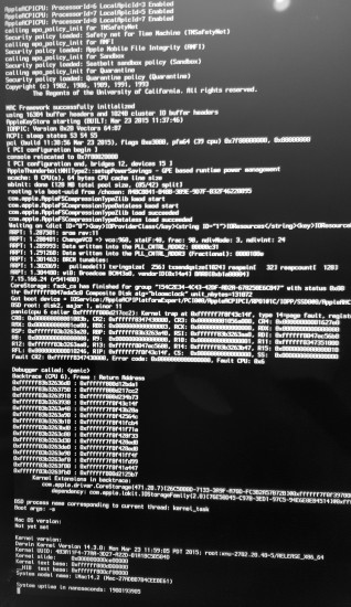

 Post subject: Re: Apple Fusion Recovery / Rebuild
PostPosted: September 17th, 2015, 11:37
Joined: March 24th, 2010, 21:08
Posts: 111
Location: California
OK, some further developments. When drives are installed back into iMac system crashes with the attached error screen. If put into target disk mode and hooked up via Tbolt to another Mac running 10.8+ the system it is connected to immediately kernel panics, indeed even booking off Yosemite installer produces swift kernel panic referencing CoreStorage. Ditto single user mode. This means any Mac-based recovery software such as Data Rescue, etc, is out of the question since OSX crashes immediately when system is connect via target disk mode or if booting off USB based OSX. Bootcamp partition is still completely functional & it is possible to boot into Windows but this partition is of course outside of the CoreStorage volume and sees the SSD and 3tb drives as separate volumes. I'm thinking that perhaps the CoreStorage volume was corrupted by partition fiddling in Windows (cust denies this but who knows) or possibly some sort of logic board failure where the system stopped detecting SSD and volume was corrupted. Unless anyone has further ideas I'm thinking on option going forward is raw recovery, scraping partitions for data.
PostPosted: September 17th, 2015, 12:43
Posts: 111
one last thought-- if I remove 3tb drive from iMac, then boot iMac in target disk mode with just SSD, then hookup 3tb drive via USB system does not crash so I could potentially run DataRescue on it that way but DR4.1 at least does not seem to recognize the drives as a Fusion volume. When hooked up this way Disk Utility does recognize as Fusion volume that is missing member.
