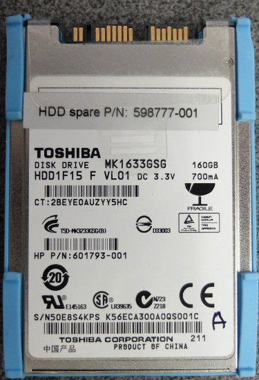

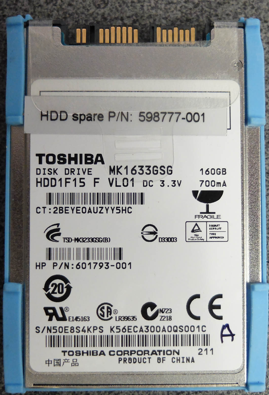

Toshiba MK2533GSG 1.8" SATA drive

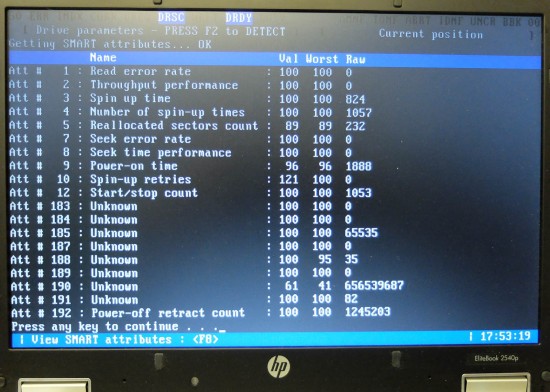

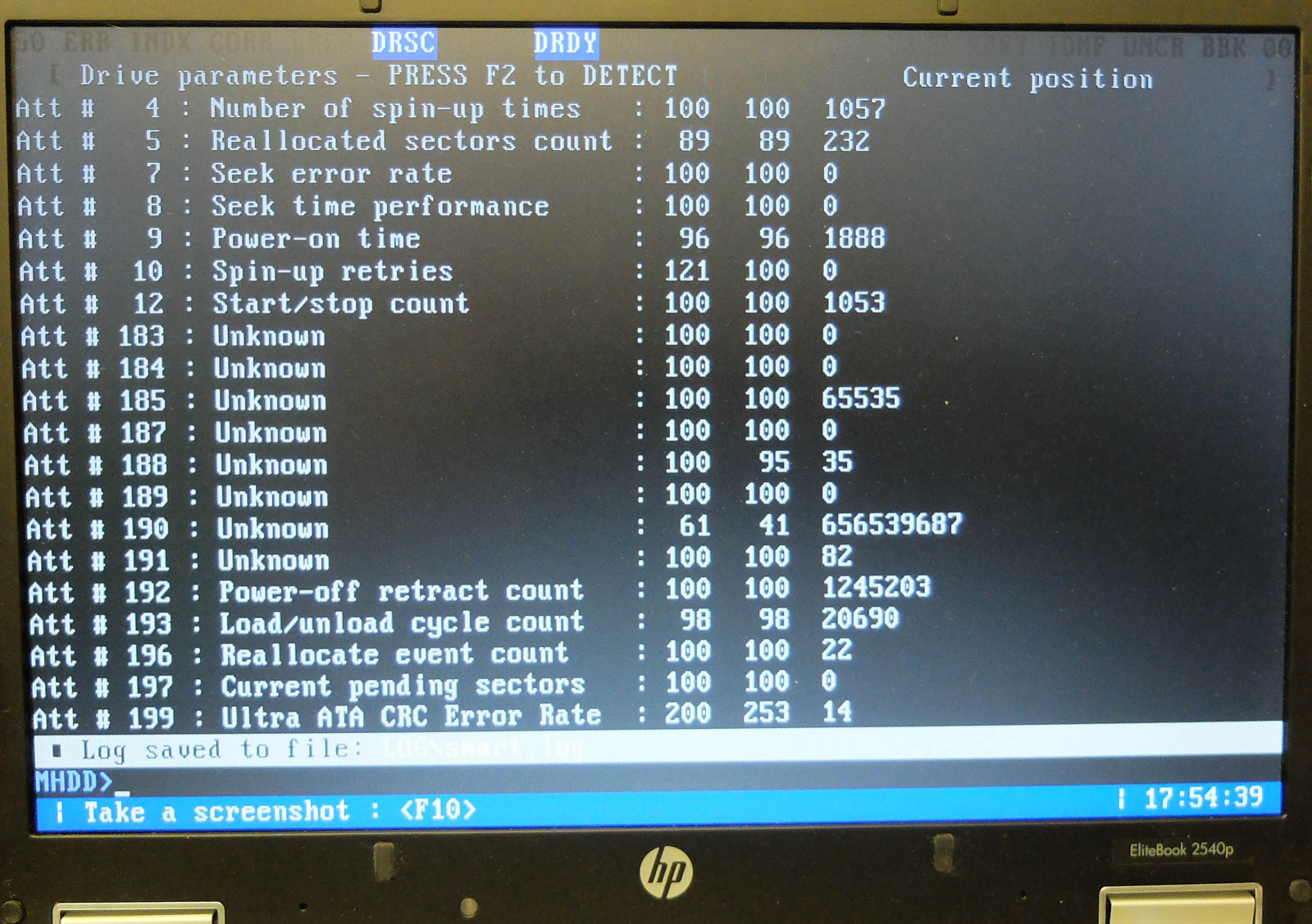

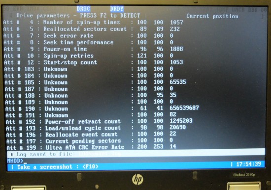

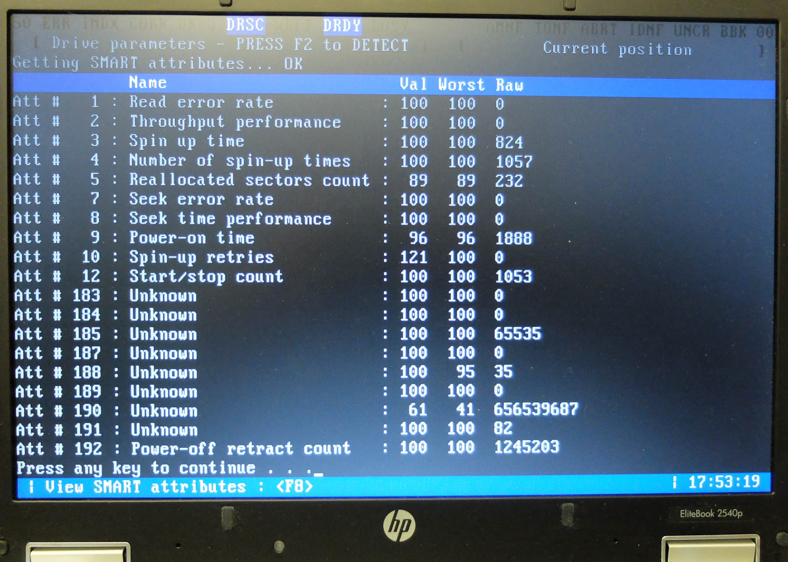

PS. I added 2 photos from Mhdd.

What is the meaning of read error rate Val=100 Worst=100 Raw=0 (same HDD model compared has same values)
Because Val and worst are equal it difficult to interpret.
Reallocated sectors count val=89 Worst=89 Raw 232 (same HDD model compared 100-100-0)
Current pending sectors Val and Worst both =100 Raw=0 Is this 100 kind of a factory default and currently there is no pending sectors? (same modelHDD compared (100-100-0)
How to understnad val 100 and worst 100? Doesn't seem to make much of sense at first glance.
Drive doesn't look very good but how it makes the whole PC to crawl in Windows while running normally mhdd test?

"Normalized value", commonly referred to as just "value". This is a most universal measurement, on the scale from 0 (bad) to some maximum (good) value. Maximum values are typically 100, 200 or 253. Rule of thumb is: high values are good, low values are bad.
"Threshold" - the minimum normalized value limit for the attribute. If the normalized value falls below the threshold, the disk is considered defective and should be replaced under warranty. This situation is called "T.E.C." (Threshold Exceeded Condition).
"Raw value" - the value of the attribute as it is tracked by the device, before any normalization takes place. Some raw numbers provide valuable insight when properly interpreted. These cases will be discussed later on. Raw values are typically listed in hexadecimal numbers.
Basically the Normalized and Threshold values can be seen as 0% to 100% while the Raw values show you the true count of each attribute. You can easily find each value's meaning online.
What I see from this S.M.A.R.T. data is that the drive has had problems with certain sectors which means it is possible that it has bad sectors. Those sectors can be physical scratches on the drive's platter, forming air pockets. These air pockets cause the read/write head to bounce down and up whenever it hovers over them and sometimes land on another place on the platter, thus further damaging it and creating more bad sectors. I would recommend backing up all the data from the drive and consider replacing it. You can run chkdsk /r from the CMD to try to isolate these sectors and thus prolong the life of the drive a bit more.

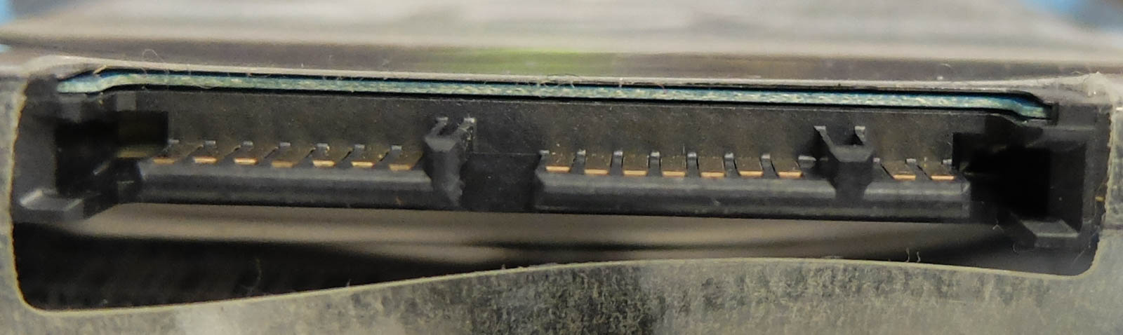

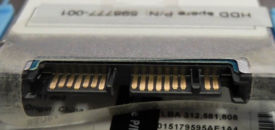

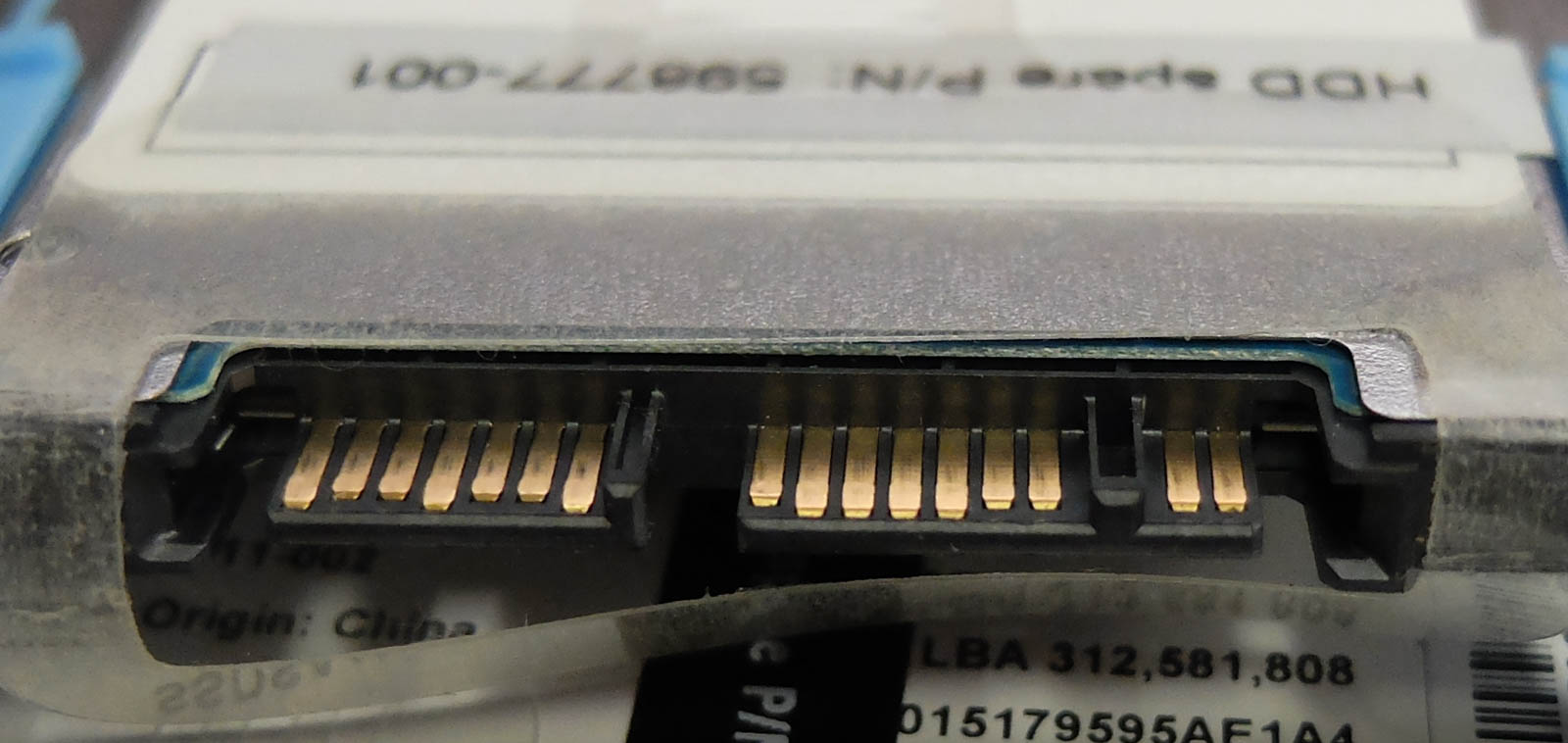

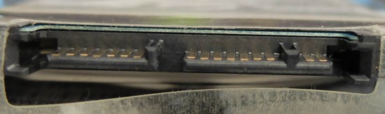

This 1.8" Toshiba MK1633GSG power connector doesn't look normal.
Please see attached images.
Let's hope the one I ordered from Ebay fits this connector.

What you need is a mSATA to SATA like this
 Post subject: Re: HDD slows Windows 7 system down
PostPosted: October 1st, 2015, 15:00
Joined: October 25th, 2010, 11:50
Posts: 72
Location: Faraway
Hi
Link is correct to "micro" SATA
But mSATA in posting is a typo ....
I already bought this, which by photo is also suitable for the future tasks:
http://www.ebay.com/itm/221604452622?_t ... EBIDX%3AIT
PostPosted: October 1st, 2015, 16:11
Posts: 1388
Location: isreal
You right, uSATA not mSATA
Oh, and yours is cheaper :lol:

In any case the OP is already using the most appropriate tool for the job. The problem appears to be that the drive has "slow" sectors. If the data are important, the OP should boot to a tool such as ddrescue and clone the drive. Otherwise, if the OP wishes to test the drive, then a full surface scan with MHDD will identify any slow blocks and report their access times. That's something that manufacturers' tools such as WD's Data LifeGuard and Seagate's SeaTools will not do. Manufacturer tools appear to be designed to minimise warranty returns rather than providing a real assessment of the drive's health. They're just concerned with whether a sector is readable or unreadable, not how long it takes to read it.
The most obvious problem in the OP's SMART data is the raw value of the Reallocated Sector Count, namely 232 bad sectors. Neither Data LifeGuard nor SeaTools will report this number. IMO that's dishonest. It certainly is misleading, especially in Seagate's case.

I should add that attribute 188 is reporting 35 Command Timeouts. That would be consistent with the slowdowns in Windows.
