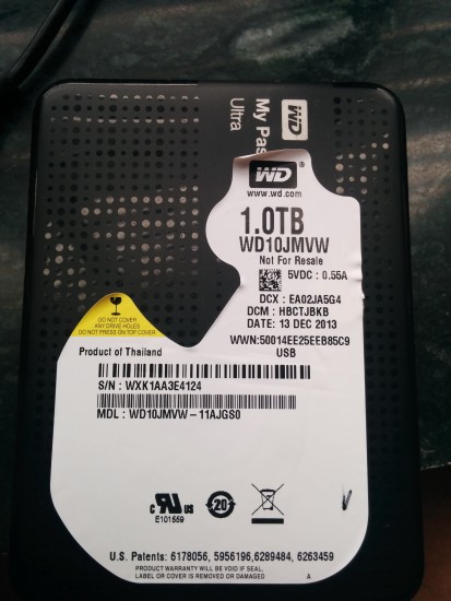

WD My passpot 1 TB board : 2060 771961 001 revA. is not working.
Please checked here https://youtu.be/-DAEshpNcF0 to understand the issue and photo
I am not sure what is the issue. please suggest next steps to recover data from this hard drive.

Oh dear, another DIY disaster :-(
Just about worst thing you could have done is open the drive and run it in a non-clean environment without the lid on, which you have done.
It's NOT a PCB problem, well not now it isn't.
Not fixable with DIY and now you've almost certainly lessened any chances of pro recovery :-(

Proper diagnosis always comes before surgery. You have performed the surgery without knowing the diagnosis. You have probably killed the patient, or at least significantly lessened the likelihood of recovery.

I think people don't comprehend the gravity of how clean the internals need to be, and totally sidestep the issue that enginnering on the drives, that come down to 1,00's of a mm, are all based on the lid on. aerodynamics, airflow, etc.

Proper diagnosis is the key, and you don't have the tools.
Most common recovery issues with this series are firmware or dirty heads from a head crash. There are some free or low-cost firmware tools that people talk about, but I have never tried them. Even if you had the tools, you would need knowledge of what to look for and how to fix an underlying problem. And now you have the additional need to decontaminate the drive.
Microscopes are very useful for examining heads for contamination. Yet some contamination is so fine that it is not readily apparent, even under magnification. But you must take care not to damage the head mechanically or from static discharge. If you see contamination, you can usually expect a read / write problem with the head.
If you value your data, send the drive to a pro. You will surely make things worse the more you try. There is a very long and steep learning curve to get any good at this, and the shortcuts are few and dangerous.

background :
I was trying to connect two hard drive into my laptop with powered usb hub. but, it was not generating enough power to connect both hard drive at same time. so, this hard drive was getting started and stopped couple of times... then I changed the power cable of usb hub. I didn't realize that cable was with higher voltage and then this clicking sound started.
I suspect, I have given higher voltage to the hard drive...

Does it make sense to change PCB and check if this HDD works ?

This is a bad idea, you're just going to end up costing yourself a lot more in the end if you do end up sending it to a pro. The contamination from being opened without a cleanroom is almost surely quite bad on the top platter at least. Running heads over it any longer will only cause crashes. The drive needs to be inspected and any dirty surfaces cleaned, also heads replaced or cleaned depending if they look damaged already.
To change PCBs you would have to do a ROM chip swap from the donor PCB as they are probably different even if you bought them at the same time.
