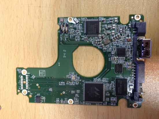

Hello
Have a WD5000LMVW USB 3 drive. Does anyone know which pins are TX and RX? Have PC3000 but not come across one of these before.

If you can take some hi quality pics of both sides of the pcb & upload them it will be helpful.

can u upload clear image of pcb here?

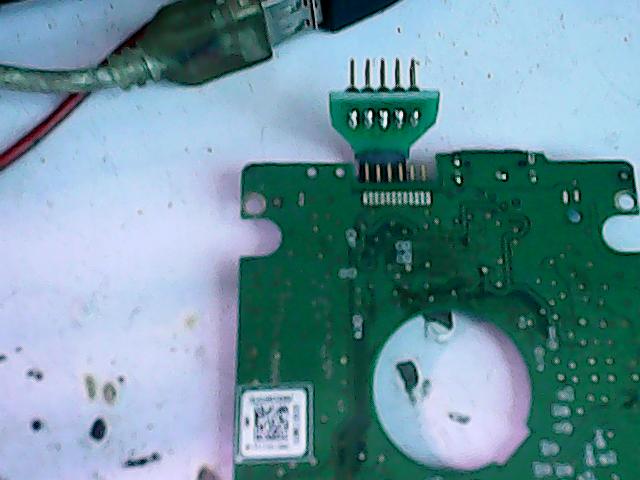

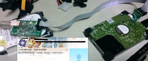

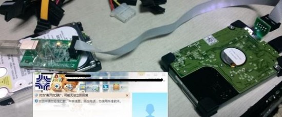

The COM adapter Samsung completely generic!
Figure: Samsung COM adapter to rely on the left side of the bottom pin is inserted! ! !

this is some how bad quality image, cannot read the pcb #
not even by googling
got only this WD5000LMVW-11CKRS0 with no CLEAR image really

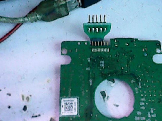

The camera is not very clear
it will not work this way, totally Diff.
and you may ask the TS about that
good luck

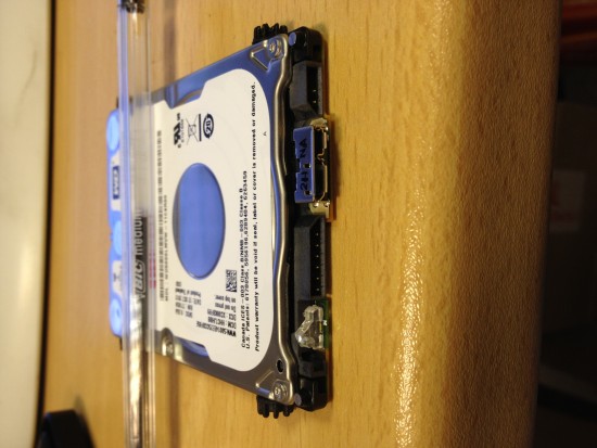

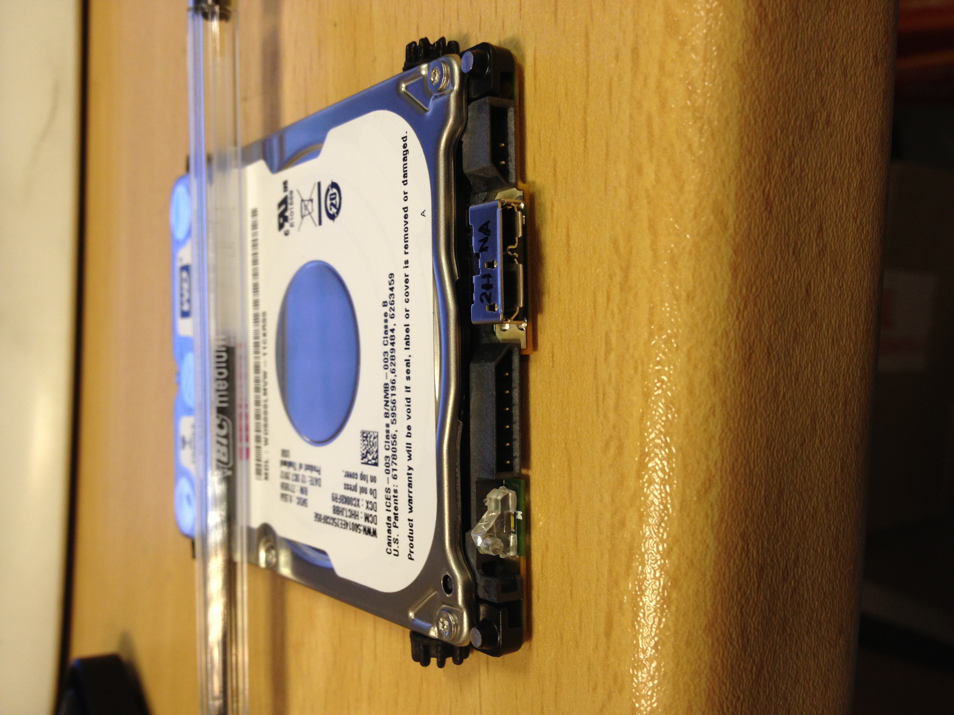

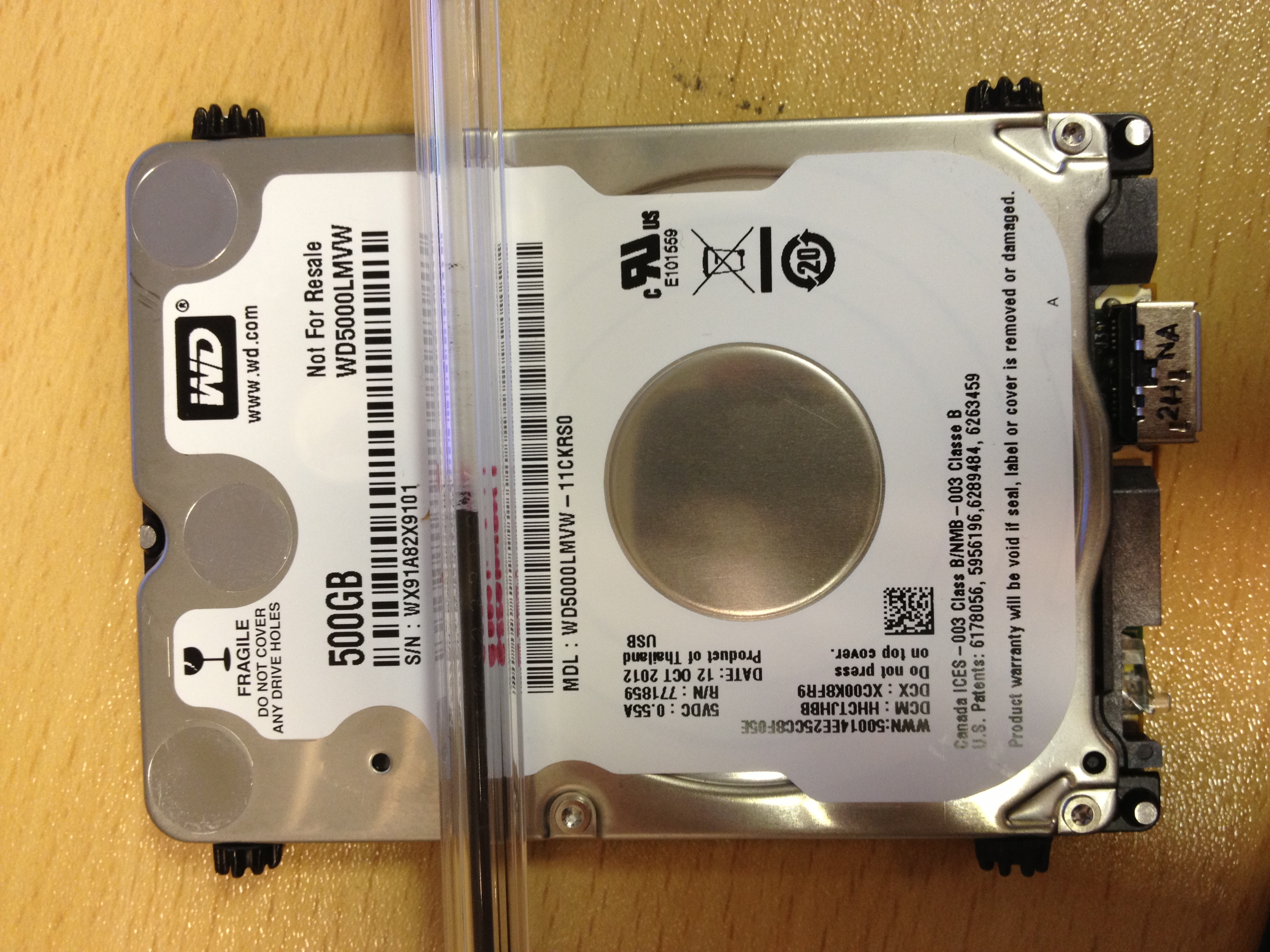

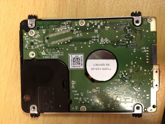

 Post subject: Re: Western Digital WD5000LMVW
PostPosted: January 14th, 2013, 10:50
Joined: February 28th, 2011, 21:04
Posts: 209

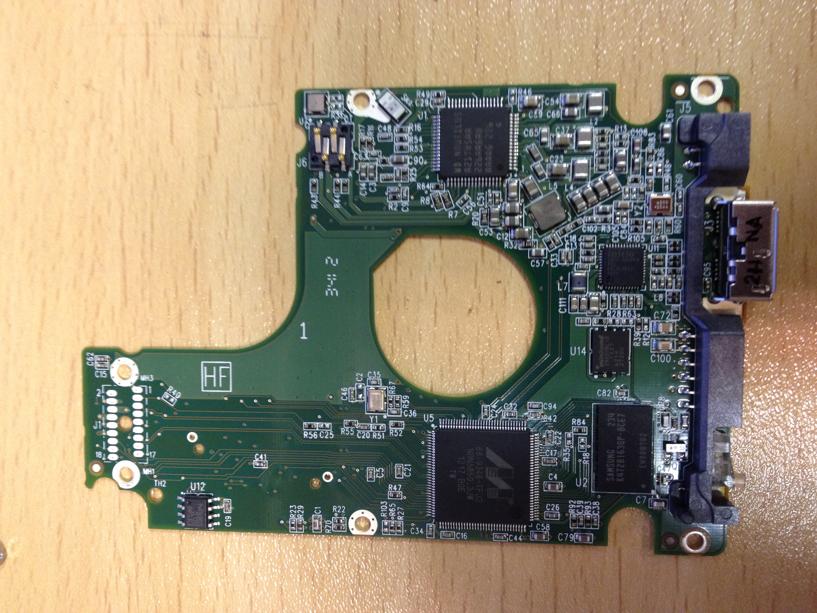

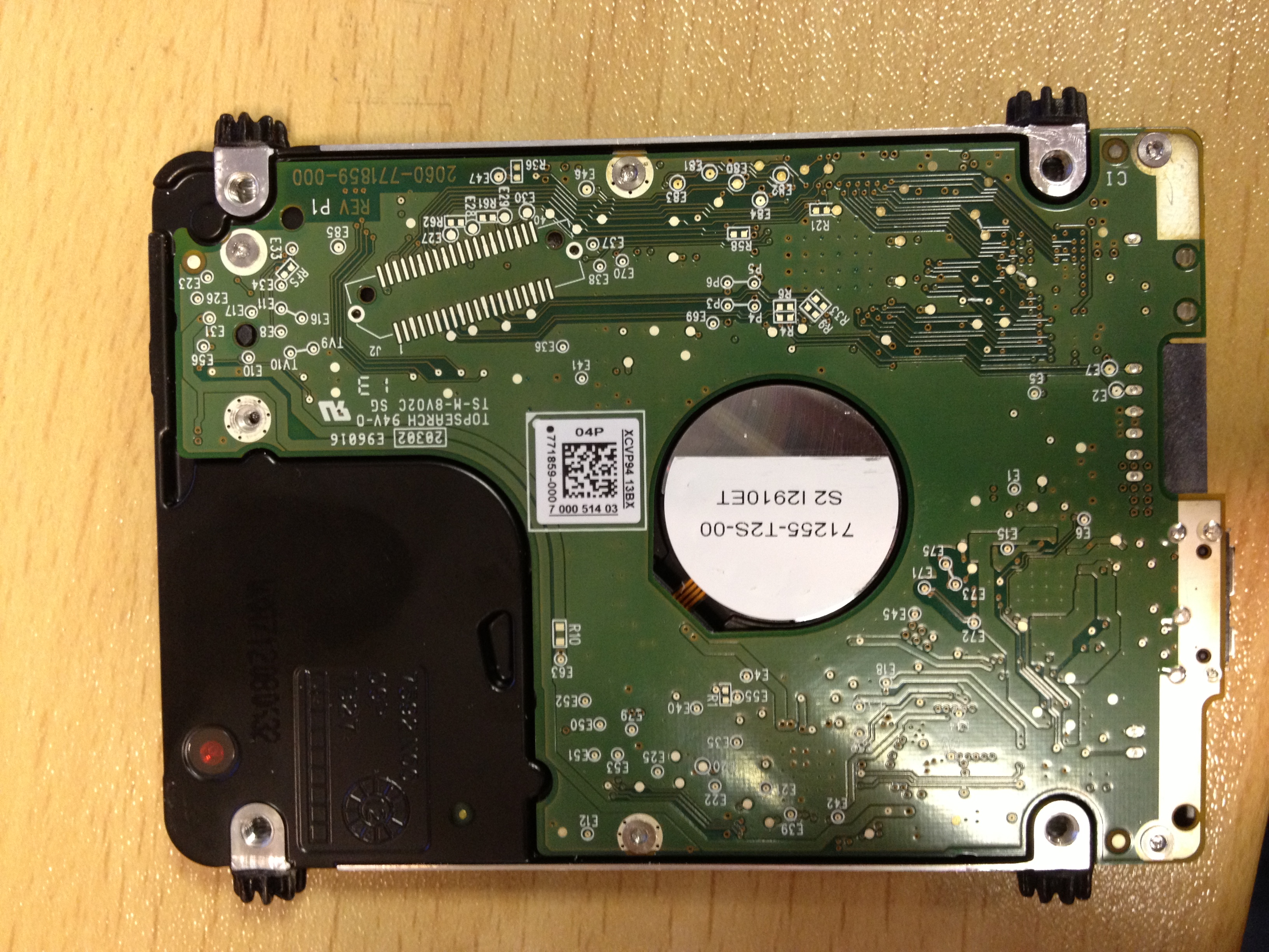

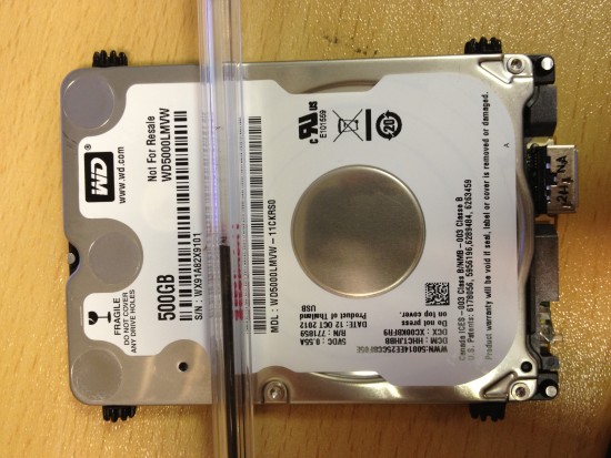

Hope this helps

Just came across my own post regarding a SATA board for this. Anyone know what SATA board might work with 2060-771859-000? Its a WD5000LMVW-11CKRS0
PostPosted: January 7th, 2015, 14:01
That's a new board if I've seen one. I'd love to know what family it is if you manage to get terminal access to it.
PostPosted: January 7th, 2015, 14:06
I would try a Firebird board 2060-771823-000
Has the same IC, and I think the same MC.
PostPosted: January 7th, 2015, 14:09
Only issue I see is that the 2060-771823-000 board uses a different U12 chip.... so soldering might be an issue if you can't get terminal access... perhaps they've caught on to our methods and are making this more difficult.
PostPosted: January 7th, 2015, 15:21
Posts: 17334
The 771852 SATA PCB appears to use the same 88i9346-TFJ2 MCU and Nautilus motor controller.

pins are same as usb2 WD drives
I have terminal access with :
USB GND RxD TxD
___ I I I I I I
And PCB 771931 & 771959 seems to work for other users (not tested)

The 771852 board works well with these drives....
