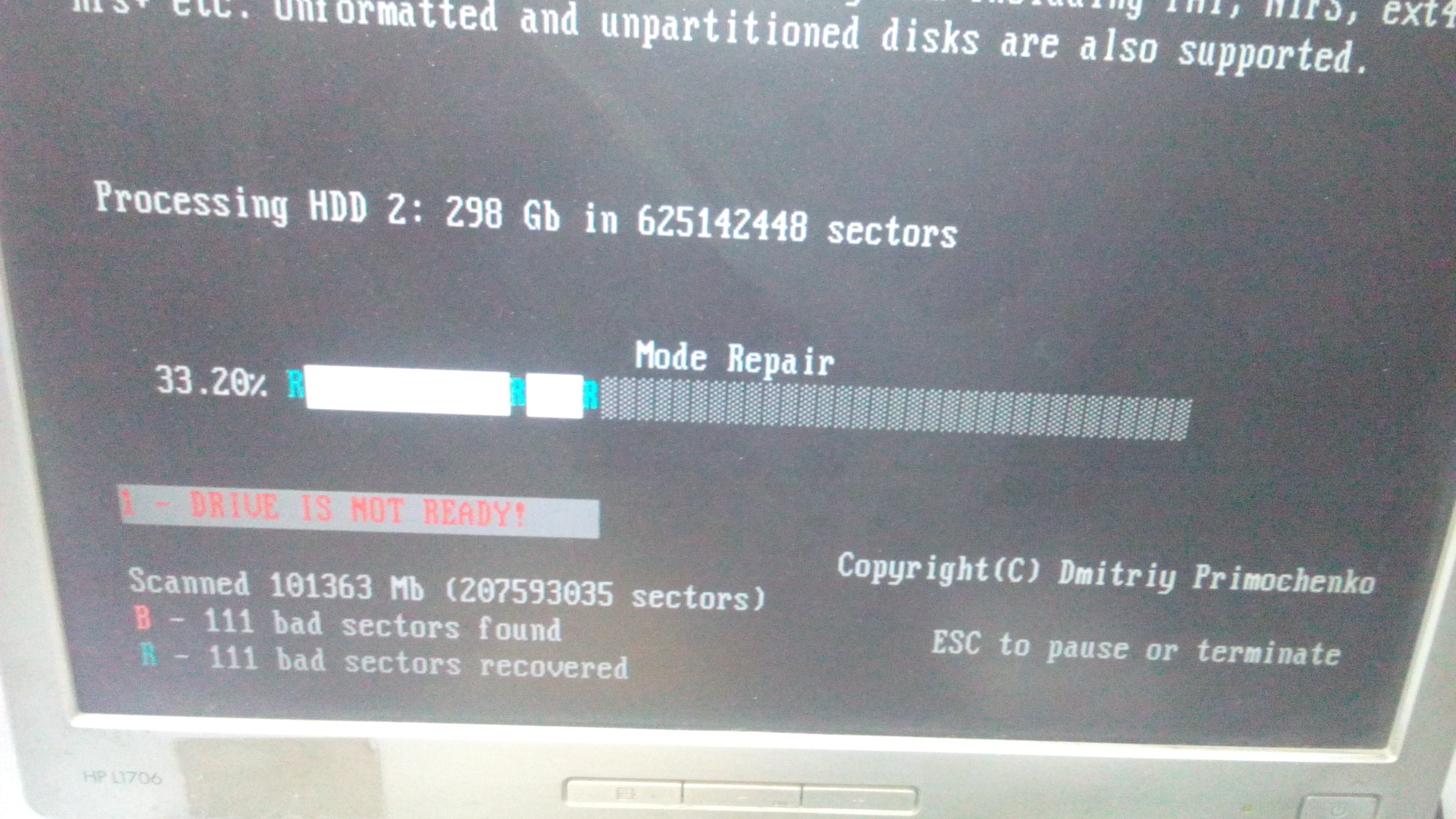

 Post subject: Momentus 7200.4 F3 Bad Sector . Need DATa
PostPosted: October 15th, 2015, 1:52
Posts: 242
I need DATA Plz Help me . terminal connect model is st9320423as :? :? :?
File comment: Thanks in ADvance

Looks like hddregenerator may have killed this drive ("drive not ready") :-(

 Post subject: Re: Momentus 7200.4 F3 Bad Sector . Need DATa
PostPosted: October 15th, 2015, 2:57
Is it seen in BIOS of PC?
Does it click and/or spin down? Or sound 100% normal?

Posts: 242
Seen bios and no clicking sound detect normally

You have or will lose data if you continue to hammer the drive with these programs.
If data is important, you better outsource the job to some one with knowledge and the right tools.

You used program which actually killing data and now you are asking to get data back?
