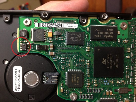

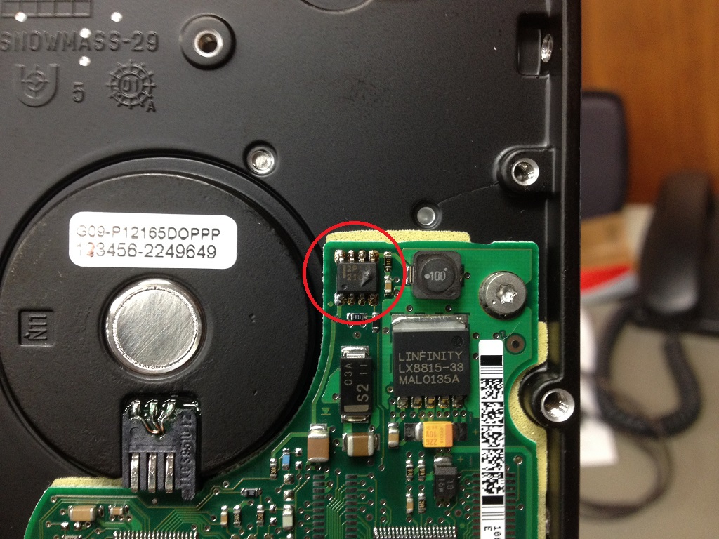

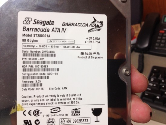

I have an ST380021A drive (80GB IDE parallel interface).
Won't spin.

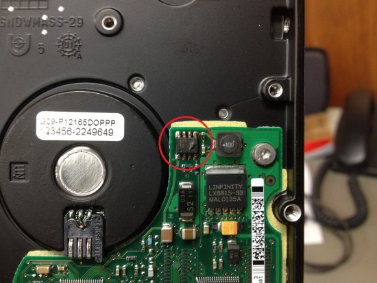

It has an IC that looks like the smoke escaped.
I'm not sure the purpose of this IC. The first line looks like it reads 2P102 but I can't be sure of that, and cannot make-out the 2nd line.
Can anyone tell me the function of this chip, and whether replacing it will likely yield another set of smoke signals (problem is elsewhere), or any other tips?
TIA.

FDFS2P102A.
It is a DC-DC converter. +5V/-5V. Preamplifier may be shorted.
Check the resistance between -5V/GND with PCB isolated and connected.

Strictly speaking, the FDFS2P102A is a Schottky diode and MOSFET in a single package. The DC-DC converter consists of this IC plus the PWM controller inside the SH6950D motor controller.
Here is the datasheet:
http://www.farnell.com/datasheets/1506466.pdf
The pins you should be measuring are 1 & 2, not 5 & 6. Pins 5 & 6 will always be connected to ground via the 100 coil. You can snip pins 1 & 2 with flush cutters to isolate the IC.

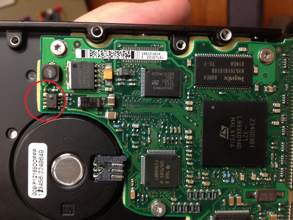

Well I got a new IC on there but the drive won't spin-up, but the chip hasn't gone super-nova either.
I wonder if the drive was injured by the 5v power supply and other stuff is bad, too. So then the next question is whether I should try a different board (which I don't have and would cost $50 on ePay).
I have pretty similar boards (like the one from which I just borrowed the IC). I was curious about trying that board just to see if the drive would spin-up, but don't want to hurt chances of getting the data back by hurting the heads (for example).
