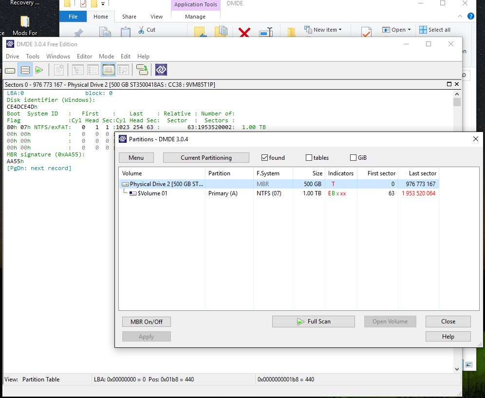

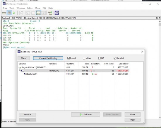

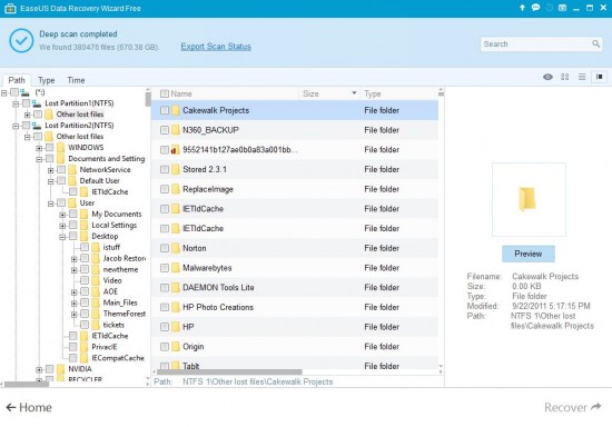

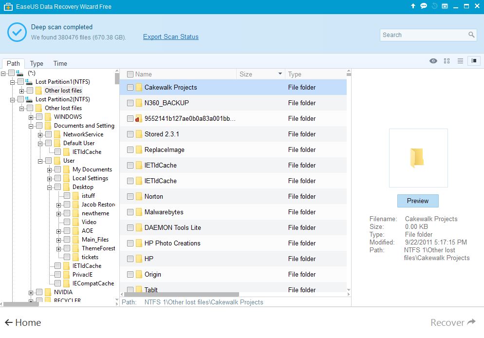

For whatever reason, I'm able to get the files from one of the HDD's.... But the files don't seem to actually work when I try to open them. And a lot of partial pictures etc.
What could be the problem?
EDIT:
I have also attached the window for the partitions of one of the HDD's in DMDE as requested.

There's just a general info, but it looks like you've been using RAID 0, not RAID 1.

@jw1re, the partition table in sector 0 is showing that the RAID has a single 1TB NTFS volume, not 500GB. This means that the RAID is striped across your two drives, not mirrored.
DMDE allows you to assemble your RAID. Alternatively you could use mdadm (a Linux software RAID).
Is your second 500GB drive functional, and can DMDE see the backup NTFS boot sector at the end of the volume?
I could try to help you assemble your RAID with DMDE, if you wish. However, I would first assess the health of your drives by examining their SMART reports with a tool such as CrystalDiskInfo.

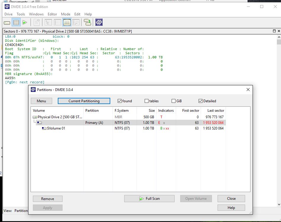

One potential problem with USB docks is that some are configured with 4KB sector sizes. Also, if the dock is USB 2.0 rather than USB 3.0, then the transfer rate will be limited to abut 30 MB/s.
Could you install your first drive in your USB dock and then upload DMDE's Partitions window? This will tell us if your dock is suitable.
Okay, is this what you are looking for?
 Post subject: Re: Blown Mobo / RAID 1 Software Recovery
PostPosted: January 31st, 2016, 1:49
Posts: 17314
That looks OK to me.
