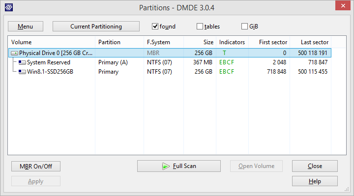

I think you are dead on, fzabkar! So I should set the End LBA of the primary partition from 39070226943 to match that of its contained volume's End LBA 2930276344?
I am confused by "$Volume 02". It looks like it starts at 500GB and runs to the end of the primary partition. I am thinking that this volume should not exist. What do I do with it?

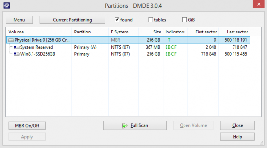

DMDE has found your new NTFS volume ("2TB Bill") and an old 1.5TB volume "$Volume 02".
The "Ind." column shows the indicators for each partition.
E = partition exists in partition table
B = partition has a Boot sector. This is the first sector of the partition.
C = partition has a Copy of the boot sector. This is at the end of the NTFS volume.
F = partition has a recognisable File system.
The first part of "$Volume 02" has been overwritten by the cloning process. Therefore only the boot sector Copy remains. This is normal.
One way to recover the missing 500GB capacity is , as you say, to edit the partition size in the partition table in sector 0. We can do this by editing the actual number.
Go to LBA 0 and select Mode -> Partition Table MBR/GPT
Edit -> Edit Mode
Your earlier Partitions screenshot is telling us that the 1.5TB volume starts at sector 2048 and ends at sector 2930276344.
You now need to change the "Number of Sectors" to 2930274297 (= 2930276344 - 2048 + 1).
Select Drive -> Apply Changes
Reboot so that Windows can reexamine the drive.
Alternatively ...
Bring up the Partitions window.
Edit -> Edit Mode
R-click the first "2TB Bill Pri." partition and select Remove the Partition.
Now r-click the second "2TB Bill" partition and select Insert the Partition (Undelete).
Reboot

Interesting. I took a peek at my C: volume's configuration and it looks simpler than my messed up drive. There are no sub-partitions. Is the sub-volume entry on my bad drive, which is the same as the partition description, a result of the problem I'm having or is its structure actually different?
