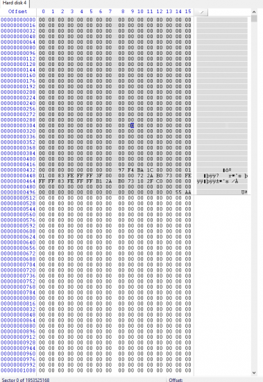

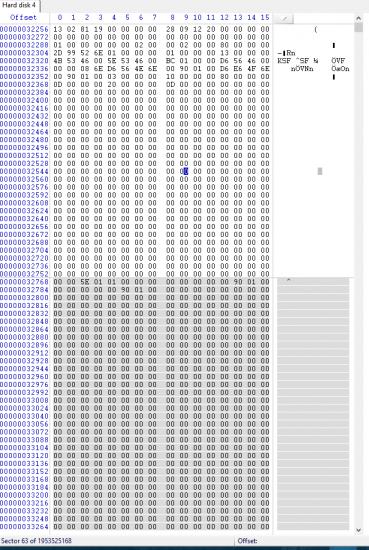

We have in a HDD from a CCTV DVR unit. The DVR was trashed and found in a ditch about a mile away from the business after a break in and the police were unable to read the HDD as the heads had failed. It has been possible to get a good disk image of the failed 1TB HDD with about 2000 unreadable sectors. However, the software provided by the CCTV manufacturer is some of the worst I have seen and there does not seem to be support for direct reading of the HDD/filesystem.
The CCTV DVR box is non-functioning. The thieves have ripped off the main BGA processor chip (which is missing). Consequently remounting the HDD in the CCTV box is not an option.
Does anyone have any experience of this manufacturer / filesystem and can make suggestions? Details of unit below:
Sentient EL821
PAL, EN, UK
Manufacturer website: http://www.kguardsecurity.com/global/
Unknown filesystem - Start sector 63, Size 1940952042 sectors
Ext3 - Start 1940925105, Size 12594960 sectors (log files for video recordings)
Thanks for any suggestions.

"DVR Examiner" is able to browse the filesystem, and provides the following details:
Video format: H.264
The "DVR Examiner" software also provided playback and works well. It seems like well designed software. However, the subscription fee ($8500 for 3 years) is somewhat prohibitive for infrequent use.
